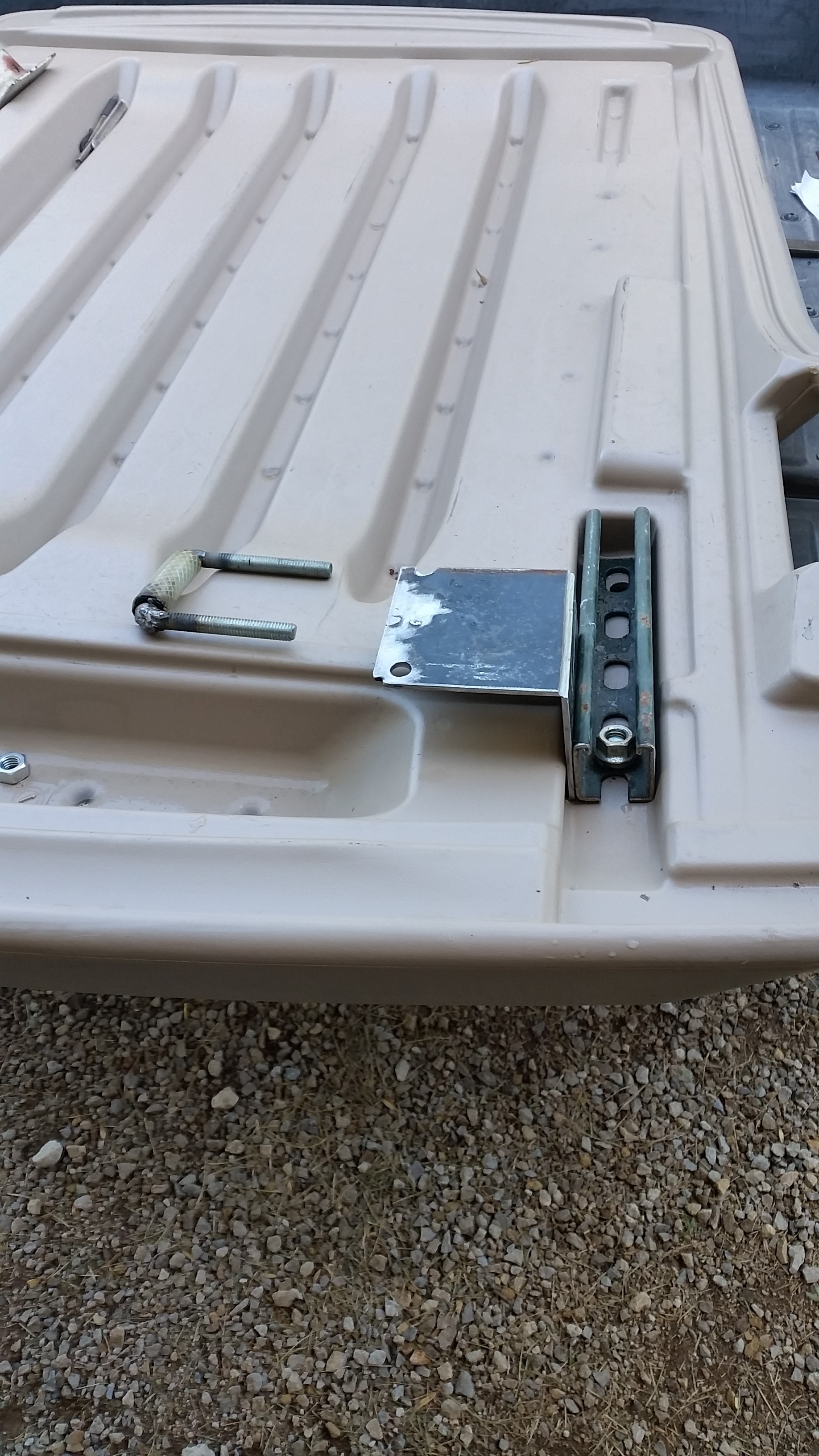

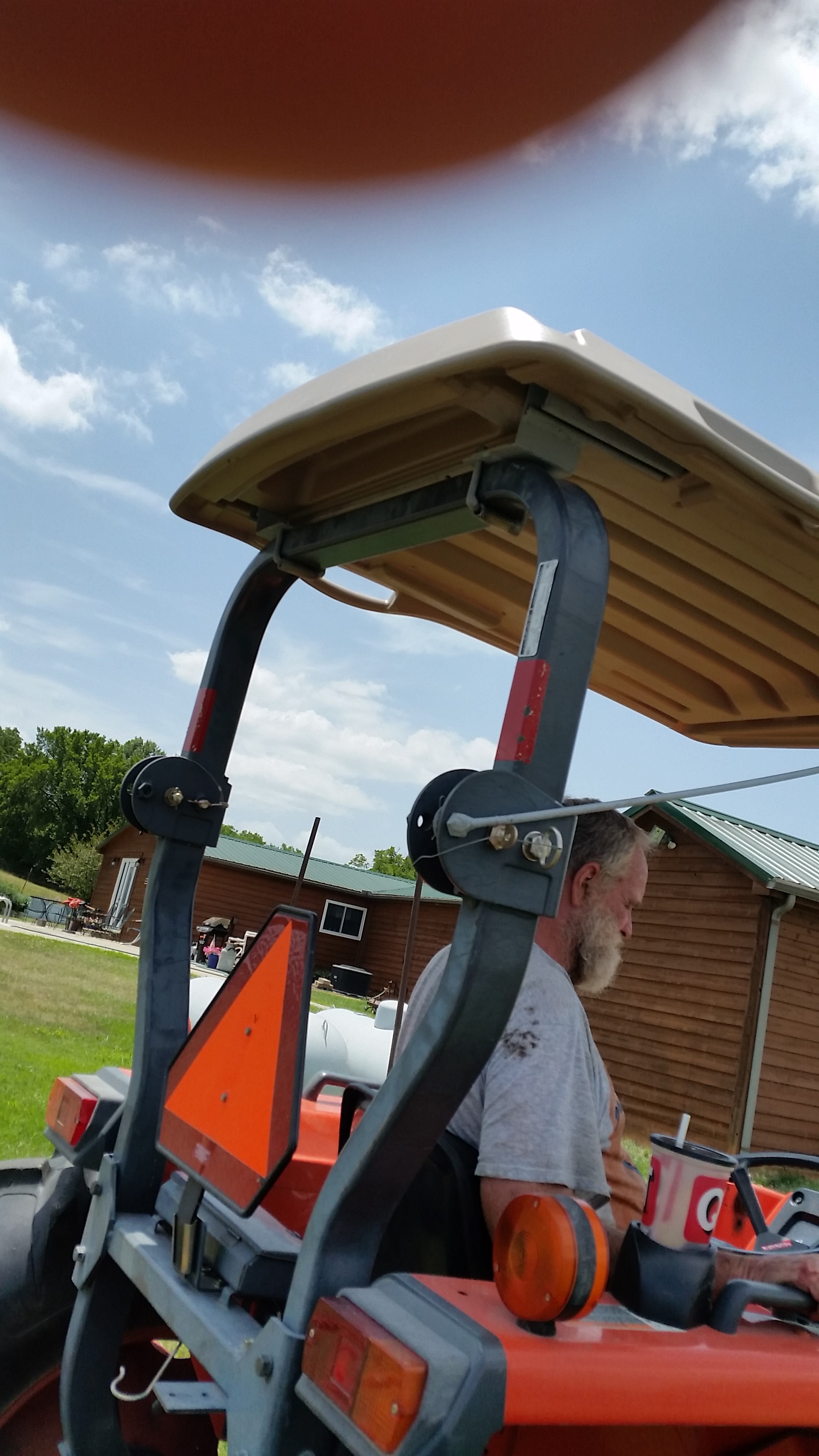

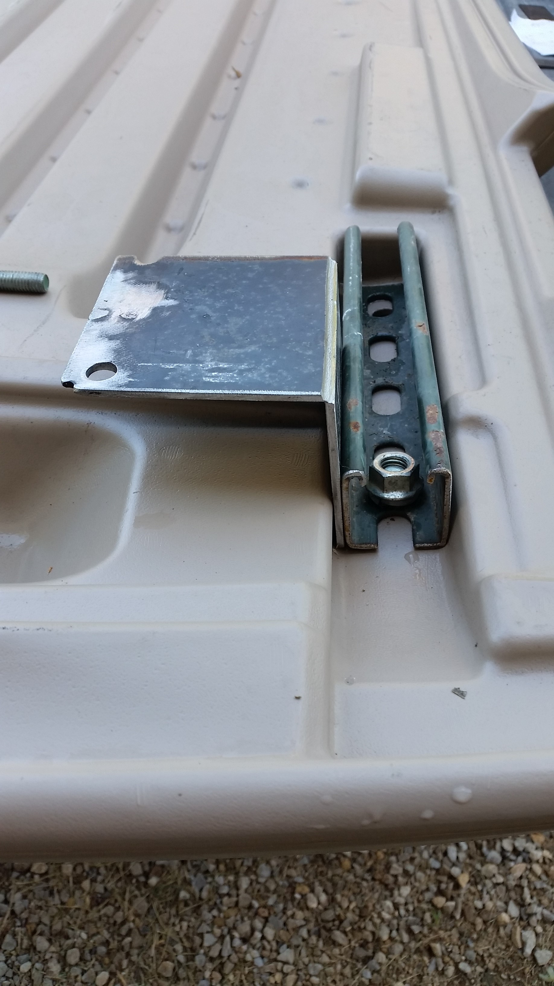

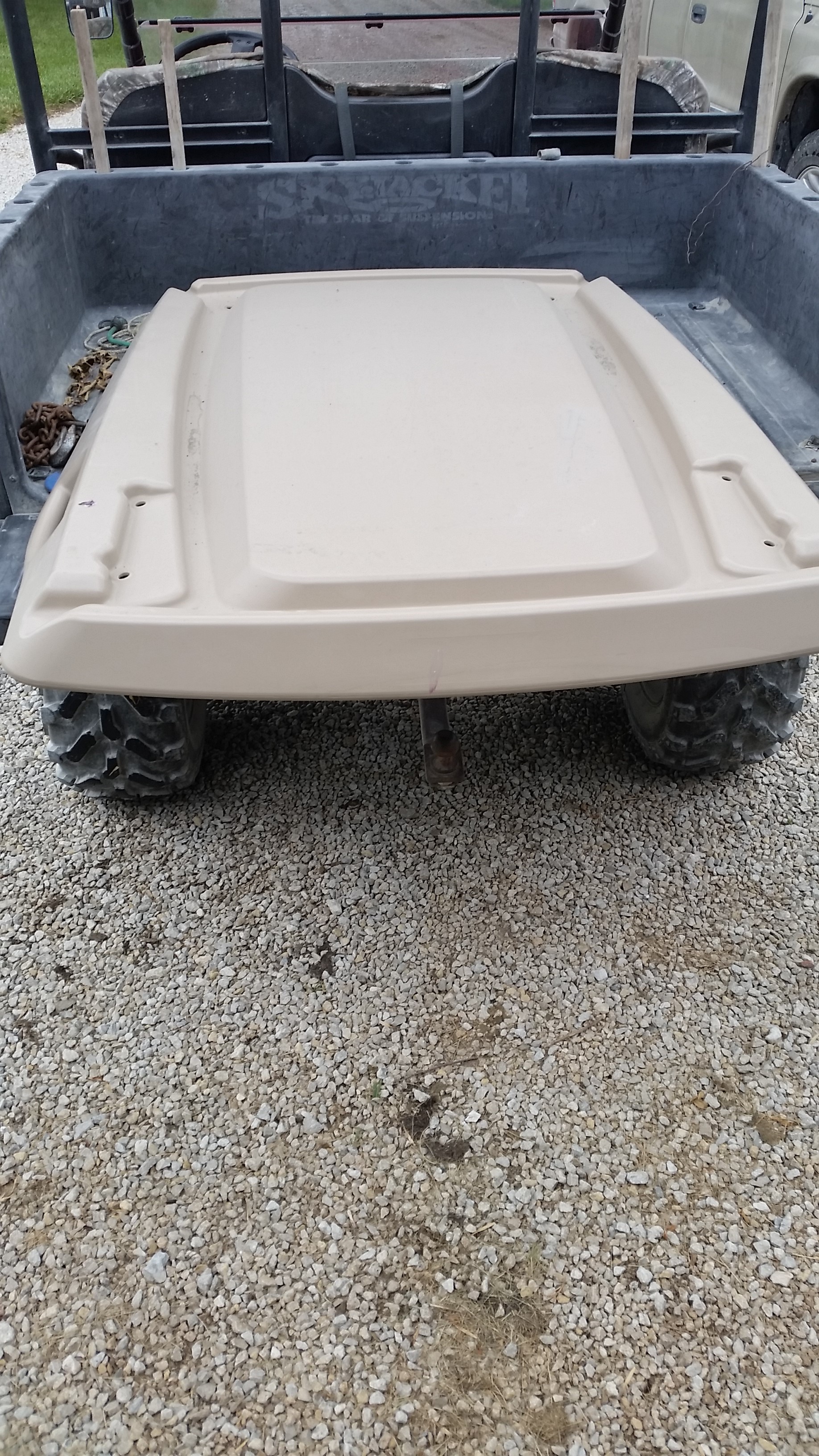

My neighbor put up some hay for me and wouldn't take any pay. His wife did most of the raking so I built a canopy for that tractor. Got the canopy for local golf cart center. Did not drill any holes in it, only used what was there. First picture is just laying in the back of the Polaris Ranger. I formed the U bolts from threaded rod because the ones at the hardware store were too long and not threaded enough. Brackets made from unistrut and scraps. Total cost about $40.
