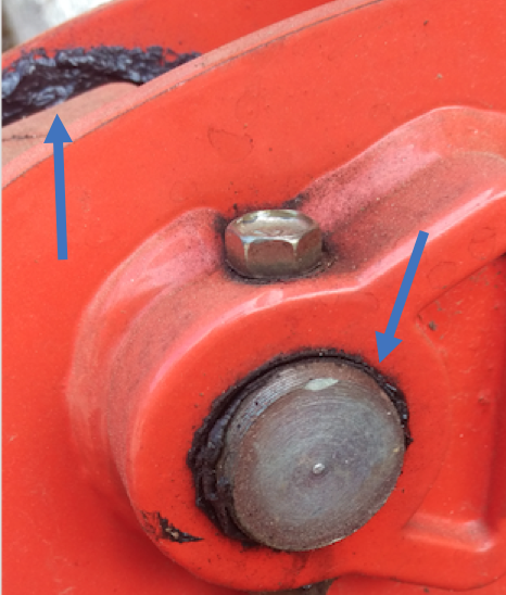

It’s a lock and lube attachment, I dont think the zerk or the fit on the zerk is the problem because grease is definitely traveling from the centre of the cross drilled hole in the pivot bolt back out on the side of the head of that same pivot bolt. I was thinking of putting some kind of gasket material behind the head of the pivot bolt to try and force the grease to come out at the right place
   / Where is the grease supposed to ooze out from when greasing loader? #14
Since the grease is traveling down at least half the length of the pivot pin the joint is getting grease. Grease is going to take path of least resistance so if side clearance between loader arm and support is tighter than diametrical clearance it will come out around the end of the pin.

Just wondering if its normal that the grease comes out from the side of the bolt and not from the joint itself on some of my grease point.
I took it appart and made sure that everything is clean inside but the grease still comes out from the side of the bolt.
Would you guys call it a well greased joint if grease only came out from there?

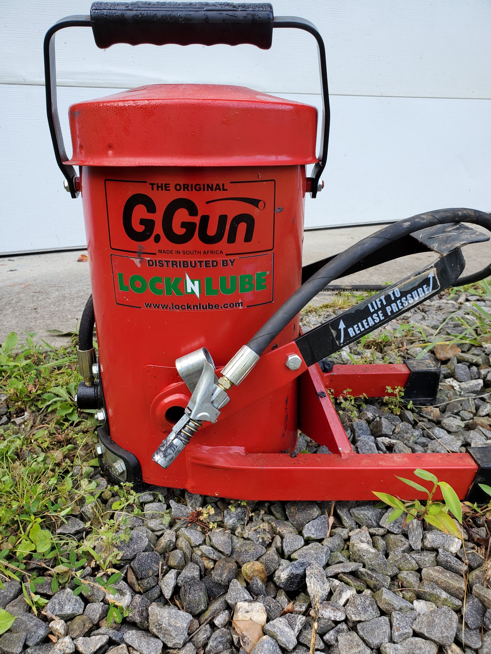

Here is pic of what a properly greased bushing ( rotating joint ) should look like. I exclusively use Moly ( molybdenum disulfide ), a high pressure grease that lubricates via the grease but also with the fine molybdenum particles suspended in lithium grease, because I work the machine hard in sandy soil, creek beds, mucking out silt settlement ponds, and digging clay. This is a high pressure, temp stable, water insoluble grease that keeps water and grit out of working joints and lubricates under high pressure even when most of the grease has been squeezed out of the joint. All the pins/ bushings are in near new condition after thousands of work hours.
Based upon your picture, I expect you have a blockage somewhere or your gun is leaking at the tip where it mates to the grease nipple. I use a foot operated grease bucket with a lock n lube nipple attachment that locks on to the nipple. The foot operated pump develops much higher pressure than hand operated tube loaded grease guns and pushes old grease and grime out of any nipples and joints. Buying bulk grease is much less expensive than expensive messy tubes.

When I grease any point on my tractor I try to "unload" the joint. An example would be the loader where I put it on the ground and roll the bucket forward causing the front of the tractor to be lifted off the ground slightly. Now when you grease the loader you are putting the grease into the portion of the joint that actually has the wear when in normal usage.
Same applies to the rock area of the front axle and backhoe assembly.
Put the grease where the wear happens.

There was another thread here about how to tell if enough grease got in there. Some people said the grease would come out mostly at just one spot. And that's understandable -- once the grease has found the easiest path out, why would it also take other paths? I remember somebody posted that, if they're not seeing grease come out someplace (and recognizing that not all the escape points are visible, especially while pumping the gun), they give the gun three strokes and call it done. So this is what I do -- I pump until I see grease coming out one of the spots it should, or I've done three strokes, whichever comes first.

That the thing, I am 99% there is no blockage, I took the pin out and cleaned every thing inside, I even tried to grease it with it off the tractor and grease comes out the pin hole no problem. The only way I can make grease come out from the joint is to loosen the bolt, grease it and then tight it back after.
