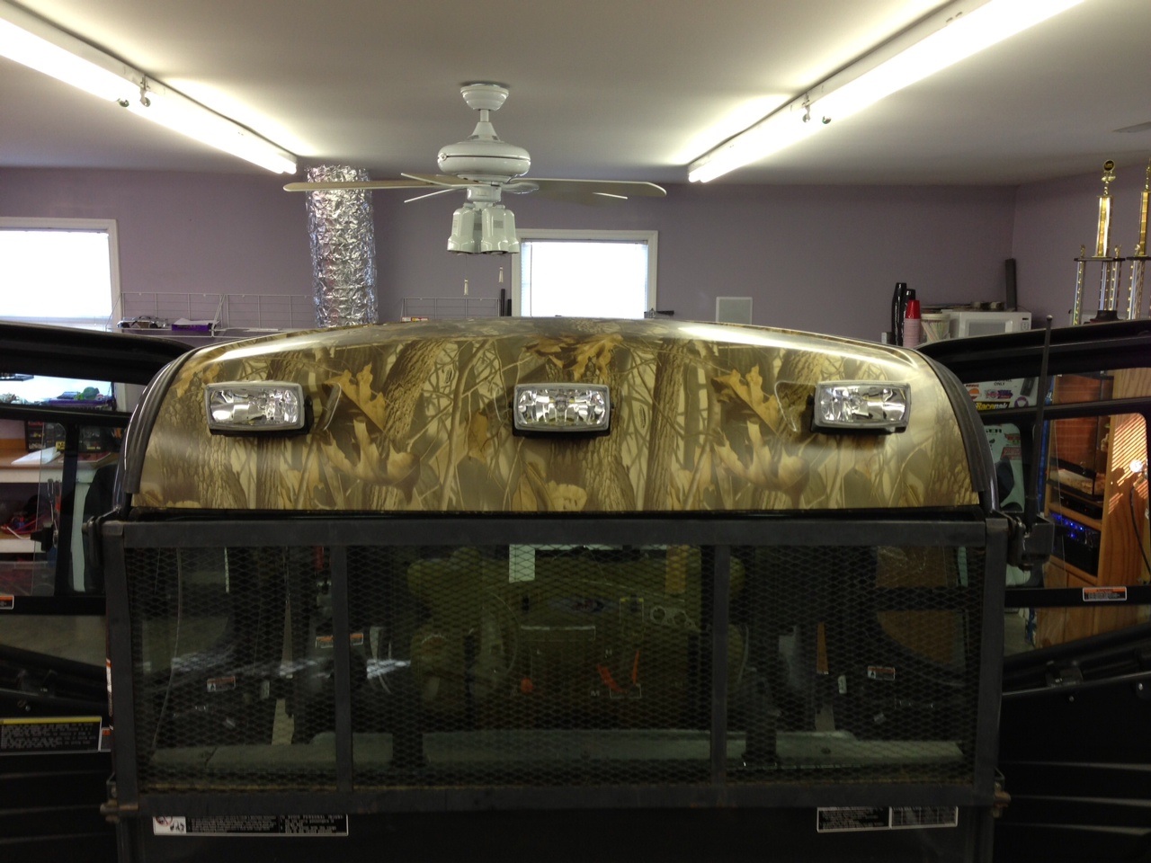

I recently purchased a Kubota rtv 1100. Love the machine, but pretty disappointed in the lighting. I just don't have enough light at night for front or back. Anyone have some pictures of rtv with front and/or back work lights. Also, what do you recommend for improving the lighting situation?
   / Where is RTV work light harness connector? #13
Here's the front view..One more in the back...OEM Kubota, they work well. I believe the wiring is already in the headliner and in the dash behind the switch blanks...Kubota installed them and I remember the tech telling me that the install is easy.

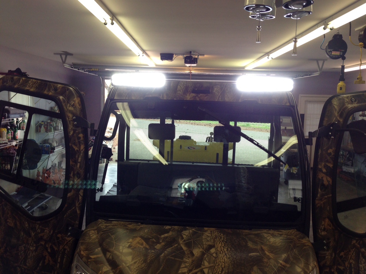

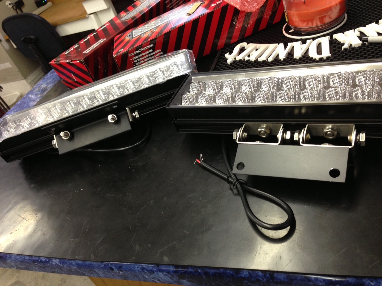

image.jpgimage.jpgimage.jpgI recently put 2 72 watt 14.5 inch led light bars on my rtv 1100. Together they put out 10,800 lumens. I moved the 2 factory front lights to the rear to go with the factory rear light that was already back there.
