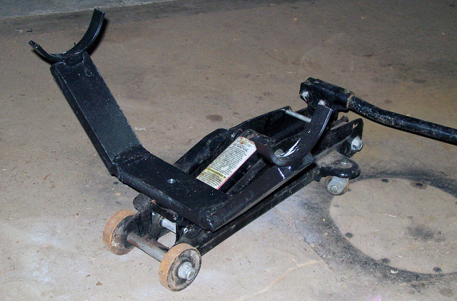

On a smaller tractor like yours do you have any kind of sub frame that you can put a stand under, say in front of the rear tires. The OP's tractor is a 30 HP which is a little smaller than my LS XR3037HC. I do have room for the stands under the rear or under my loader sub frame which runs under the tractor to the rear.
Or you could make an adapter for your floor jack like this one.

/ Where is a good jacking point?
Since I will be replacing the complete rear axle & housing on one side I'll have no real place to put jack stands, the sub frame will also have to be removed to do this. So I guess I'll need a central jacking point (transmission housing) and once I remove the tire on that side all the weight should rock the tractor to the opposite side (I hope) with the tire. Safety is of course the prime issue so I'll have to check if there are other locations where a jack stand could be placed to prevent tipping. Also considering building up a support platform to put under the transmission so as not to rely solely on the jack.
