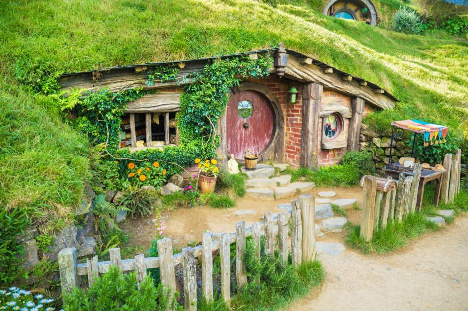

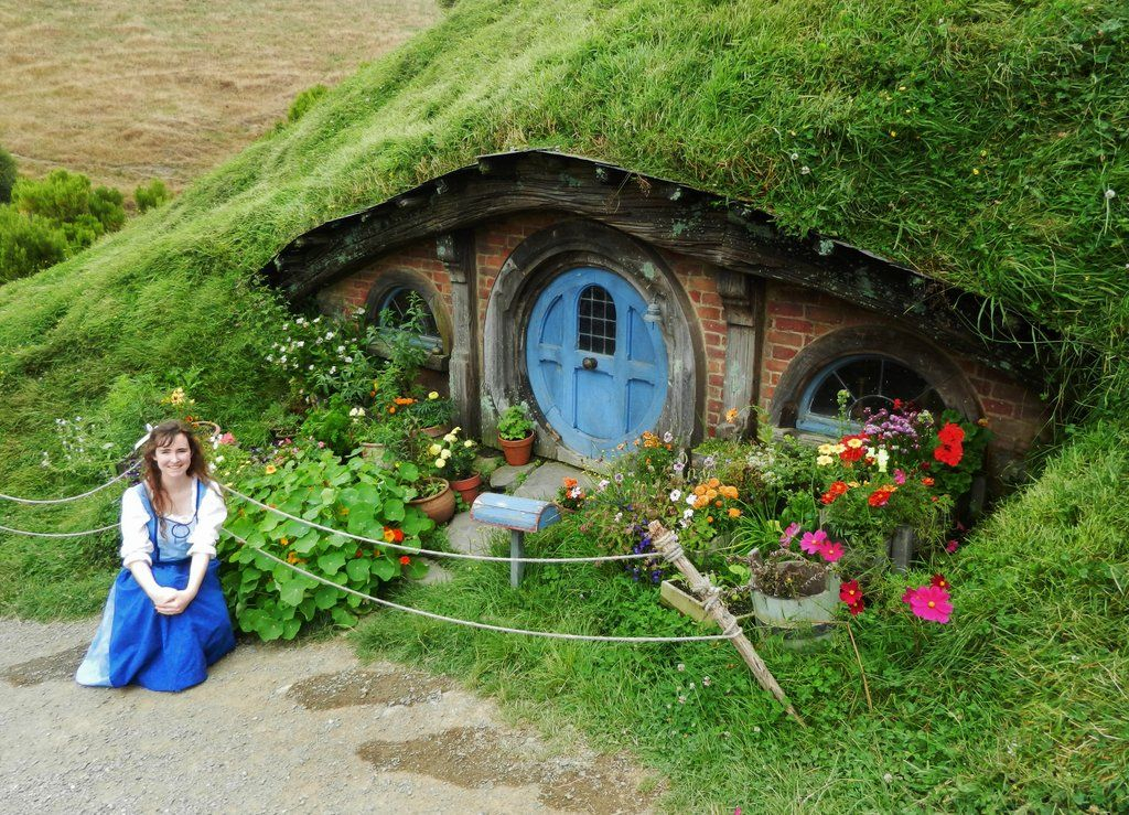

Unless there's a fire with minimal escape routes I like earth berm homes.
I have built an earth sheltered home. The only rooms that require code egress are "habitable" rooms. The kitchen, utility, bathroom, closets, storage, etc. are not considered habitable, so only the bedrooms and family spaces like living room or family room require emergency egress. You line up all the non-habitable rooms along the back wall, and all the habitable rooms on the front. Kitchen codes may vary, but I'm not aware of any code that allows exiting through a kitchen. Since earth sheltered homes are typically heated with passive solar, they have open floor plans.
