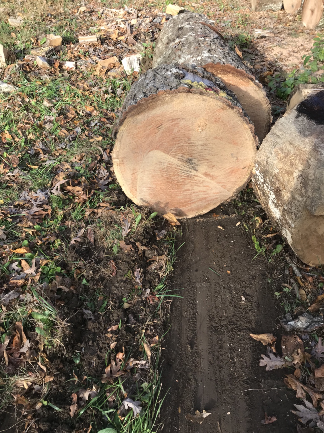

I cut this red oak in which is 25” in diameter in 37 seconds excluding the 2” on the ground. How do other people’s saws in a similar size class compare?IMG_0421.JPG
