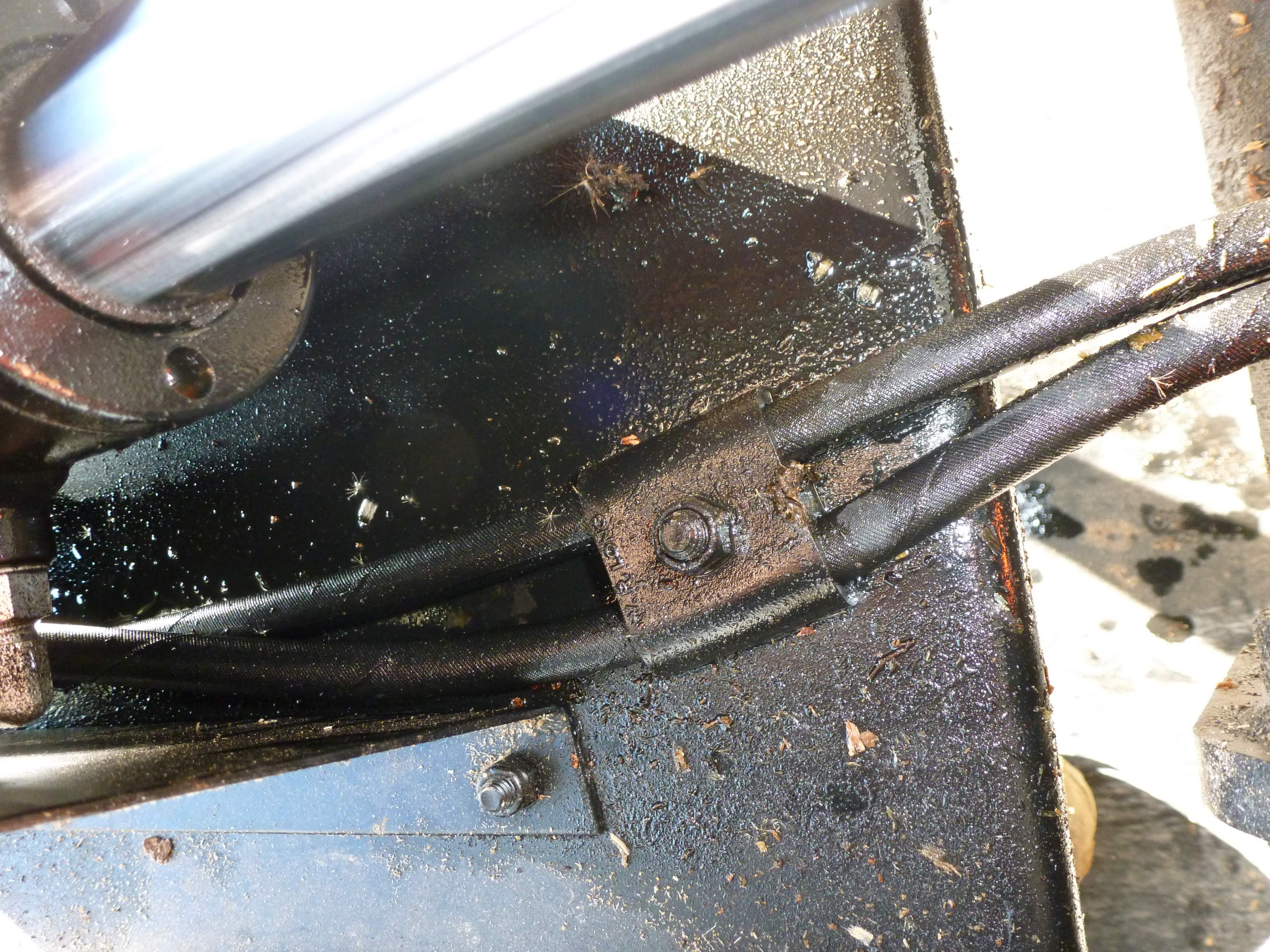

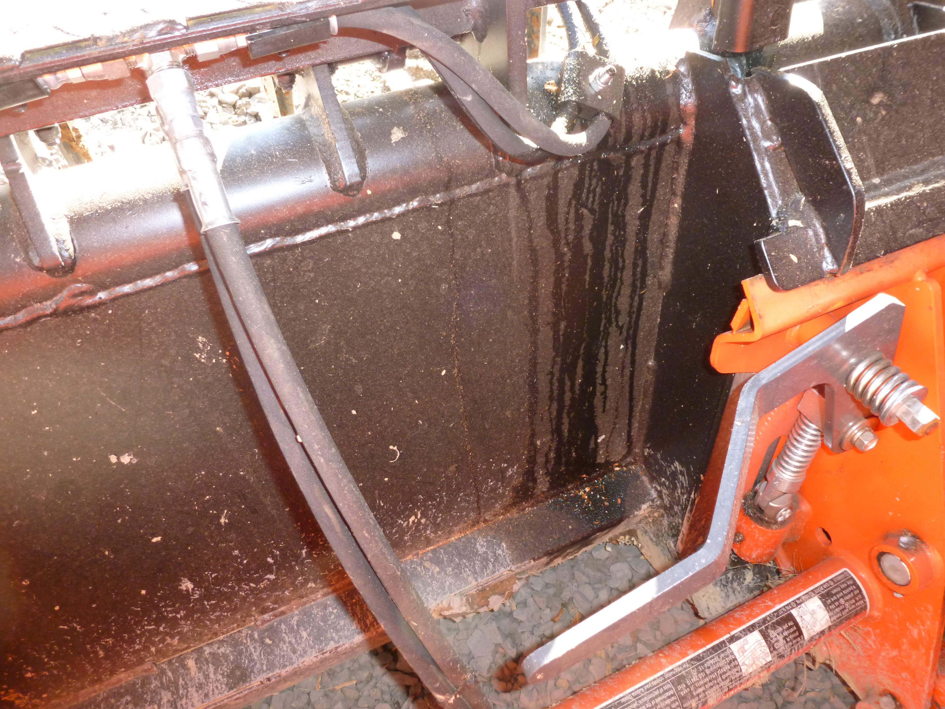

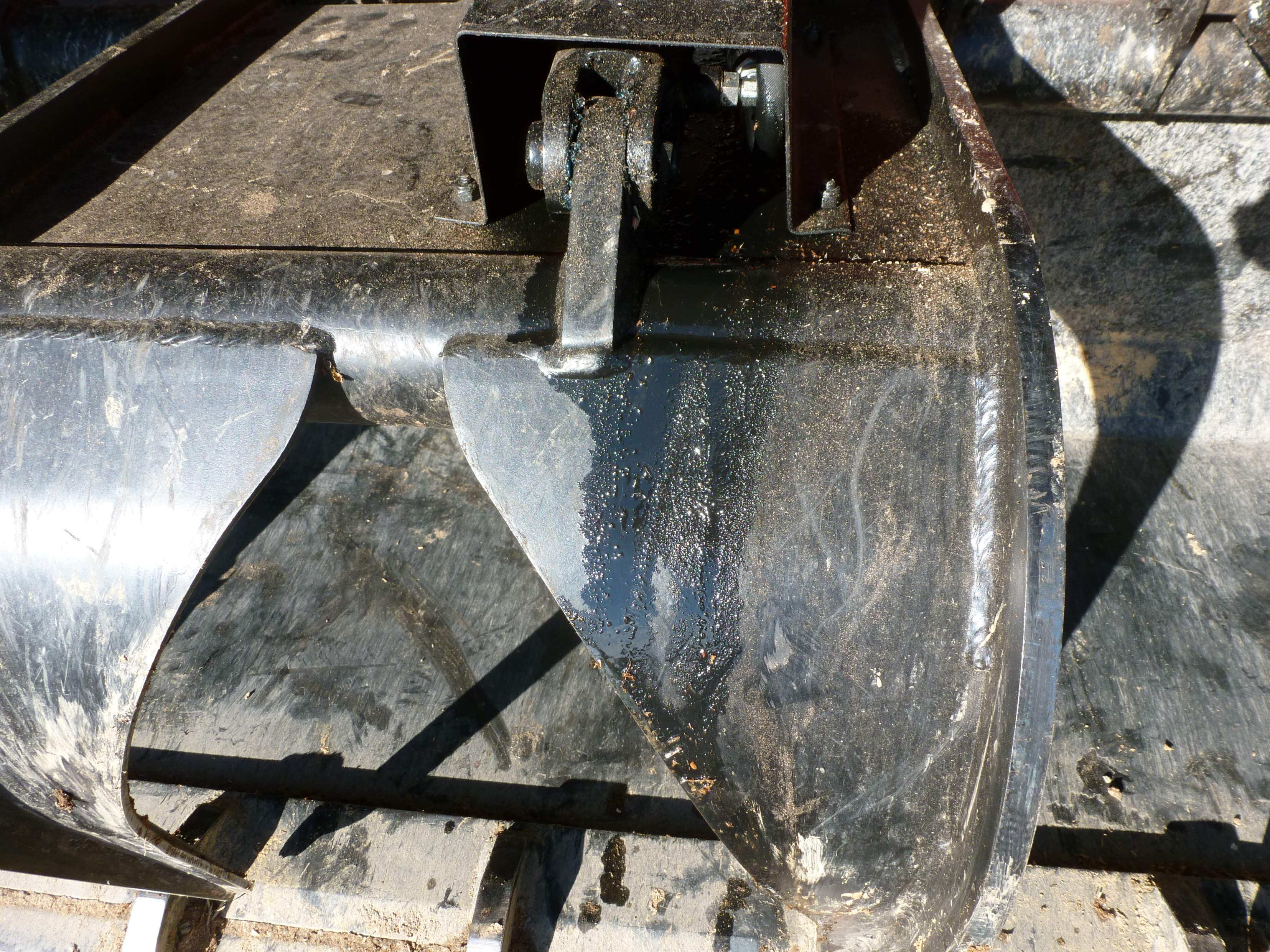

I have little experience with hydraulic cylinders, other than what I read in the Northern Tools catalog. Never had one break before.
And now on my new bucket/grapple, one of the two small upper cylinders is leaking nicely. Could well be operator abuse so I'm keeping an open mind.
Though the implement is seriously heavy duty otherwise.
What breaks on cylinders? Bending the rod? Pushing out an end seal?
Easily could have been some side pressures applied.
Just curious; headed in for warranty repair next week.
It's a small cylinder but hard to see in there due to the covers on top.
Are these things normally repairable, or if say the rod is bent, they head to get recycled?
thanks

should be able to get a seal kit.
disassemble and inspect the shaft for scratches, gouges and straightness.
you may find a bad seal when you inspect
if you have acces to a lathe you could have it spun and look for runout.
no lathe
find an extremely flat surface and have someone hold a light behind it. roll on the flat surface and look for light on the bottom where it meets the flat surface as you roll it.
use small feeler gauges and try to pass between the flat surface and the shaft at different locations as you roll into different positions .

Before you send it in for warranty repairs, do yourself a favor.......with the cyl off the equipment, pull the rod all the way out, then rotate the rod (to see if it's bent), then see if the rod is wiggling in the gland (to see if the gland is sloppy or egged out)
If the rod is bent or gland is not snug then the seals will blow out, guaranteed.......then time for a new one
While you have it out, check for cyl stroke travel......the cyl shouldn't be pushing around corners (if a stick gets in there and the cyl binds when extending the rod will bend)

I kind of suspect either repair/replacement to the cylinder will be covered this time. But when closing the grapple fingers, the distance between the individual fingers is sometimes the size of the log round, and things get stuck.
Trying to "rub" them off on other wood is likely the cause of this damage, or possible just getting pushed on from the wrong direction. I've picked up some logs that taxed the capacity of the FEL and the grapple could barely hang on to the log. Am also thinking that those "stressful moments" might have contributed, but this is all speculation.
The cylinder is fairly short. There is only so much room under that cover. So going larger isn't likely an option. Are tie rod style cylinders stronger? Are US made cylinders better? (no HF cylinder is going on my Kubota...)

When you take a hydraulic line apart, you discover that it is numerous layers of tough stuff, including metal braiding. Sure, something COULD always catch stuff just wrong and mess a line up. However, I expect that thorns on bushes, etc. will not be a real problem. I'd wait and fix a problem when it actually occurs rather than fix something that isn't yet broke. That said, I don't have a grapple thus haven't faced the problem personally. Any extra armor, other than a metal cover, doesn't sound to me like it would be particularly effective in preventing problems...you are dealing with extremely powerful forces, hydraulic and diesel, so, best solution is to watch for things catching the lines while you are using the grapple.

Sure it's leaking at the seal ?
Maybe it's a leak at a hose fitting or the hose itself.
/ when do you toss a cylinder? #11
Prior to panicing, it's very likely that it's something simple and free or very cheap to repair.
Run the cylinder out of the grapple and see where it's leaking;
1) check hose fittings for tightness.
2) check hoes for the end coming off of the rubber hose (it happens)
3) check that the cylinder gland is not loose (if it is a screw in/on gland)

one more thought. The FEL can exert a lot of pressure, and if I pushed against the grapple, let's say drove it backwards
against its current position, pushing the rod into the cylinder. What gives assuming it isn't driven through the other end?
Seems to me the most likely culprit would be the outer retainer (the cylinder gland? sorry) that got crushed under a side force.
But I also could have, shall we say, compressed that cylinder against its will. Maybe normal wear and tear, or poor operating procedure,
and not necessarily a bonafide warranty claim. But with forty hours on the tractor, my guestimate would be a first time replacement.
The dealer is also working on the hydraulic system, increasing its overall pressure. Now I don't think this cylinder "popped its cork" from overpressure, but
rather from an overwhelming opposing force. Which begs the question, do I need bigger, stronger cylinders? I'll hold on that until I find out, if I do, what went
wrong. Springing a leak with no visible damage in less than forty hours of operation is not a situation I would like to repeat.
