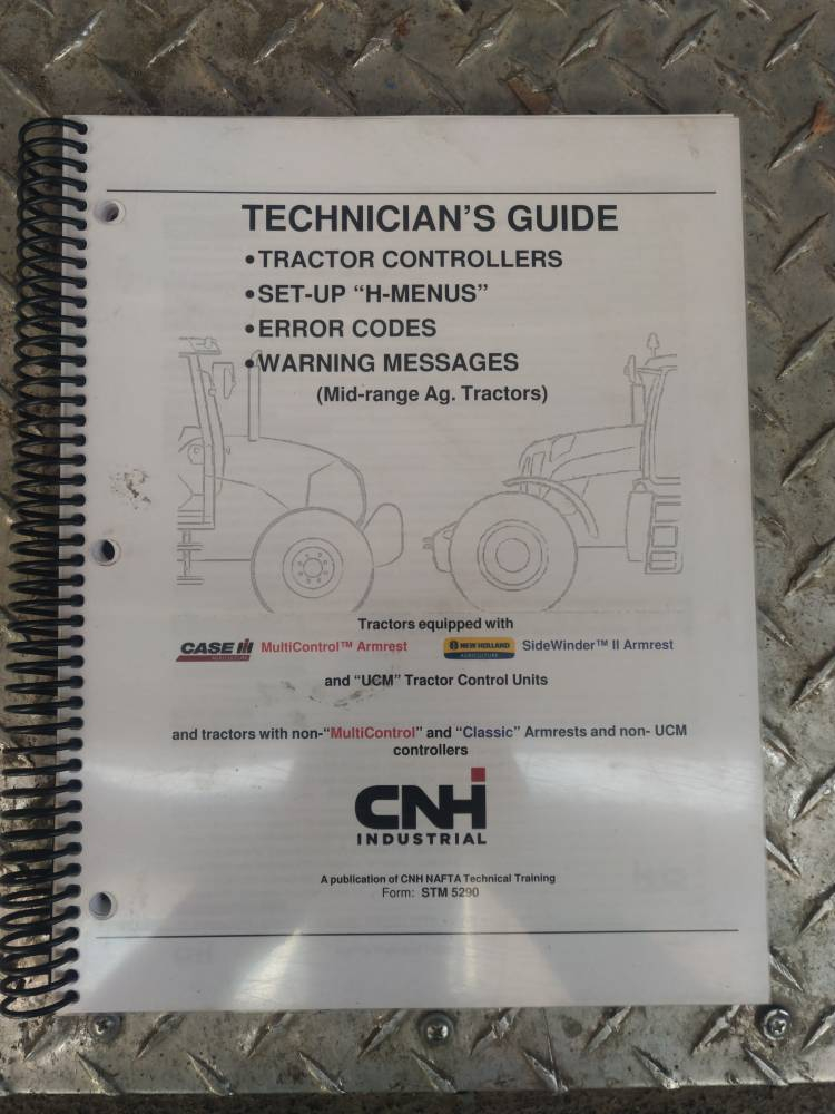

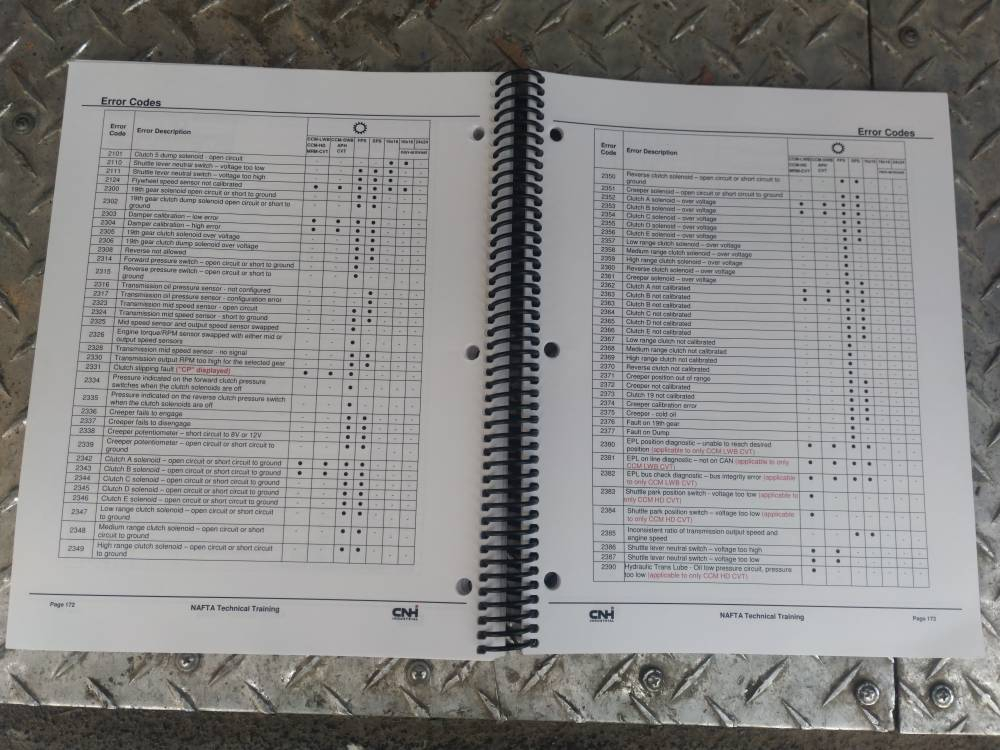

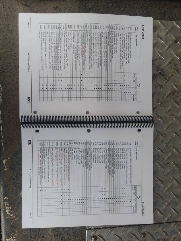

Workshop manuals are just that, workshop manuals. You need the diagnostic books for whatever series machine you are working on. Kubota I can not really speak to as they don't really have issues that often and all I've had to do is read and clear codes. New Holland on the other hand you can do all kinds of stuff, read and clear faults, recalibrate clutches, replace components... Sure there's things you can't do, but you can do a lot of stuff without a laptop.
See the attached pictures...

Well I deal with Kubota and NH up close and personal every day at a dealership. Workshop manual is Kubotaspeak for a service manual. If it isn't in a WSM the guy on the street isn't getting access to it, similar to him not having access to the stuff you have pictured.
And like I said, you aren't eliminating a de-rate on either brand by looking at a display and punching buttons on the dash or A pillar.
But those facts are the root of the problem. BTW
I'll let you guess all night who started it. I really don't know or care.
