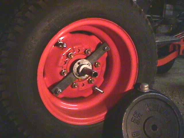

   / Wheel Weights #9
gerard, I use bar bell weights on my B7100-100 lbs per side and they work fine. You may want to check out some pictures I posted a while back on how I attached them. I made brackets similar to the ones you are considering, but was able to do it without welding (only because I don't know how). I think the post was under attachments or customization....explained how they were made.....the picture of the attachments is included here. Due to wheel size I could only use the 25lb weights. If I remember, cost was only about 45-47 cents per lb. Total cost for 200 lbs of weights and the mounting hardware and bolts was well under $100.
Also, if you can find Mike Simpson's Tractor Page, there are pictures of some pretty heavy duty wheel weight brackets made for a B2400 on that site.
