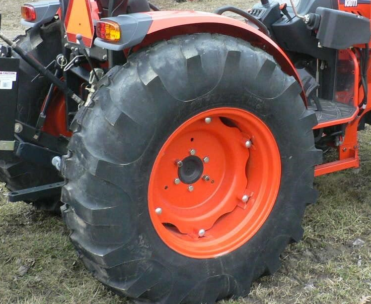

Sep 19, 2021 / Wheel weights for DK10se series #1 M McTowner Member Joined Sep 19, 2021 Messages 29 Location Towners Tractor Kioti DK10se, JD (Jim Dandy) Can someone provide me the measurement for the wheel weight hole spacing on a Kioti DK10se series rim (r4). I have New Holland weights off of a TC33D and they appear that they may work, probably 3 - 10 1/2" OC. thanks Bill Attachments kioti rim image.png 732.7 KB · Views: 142

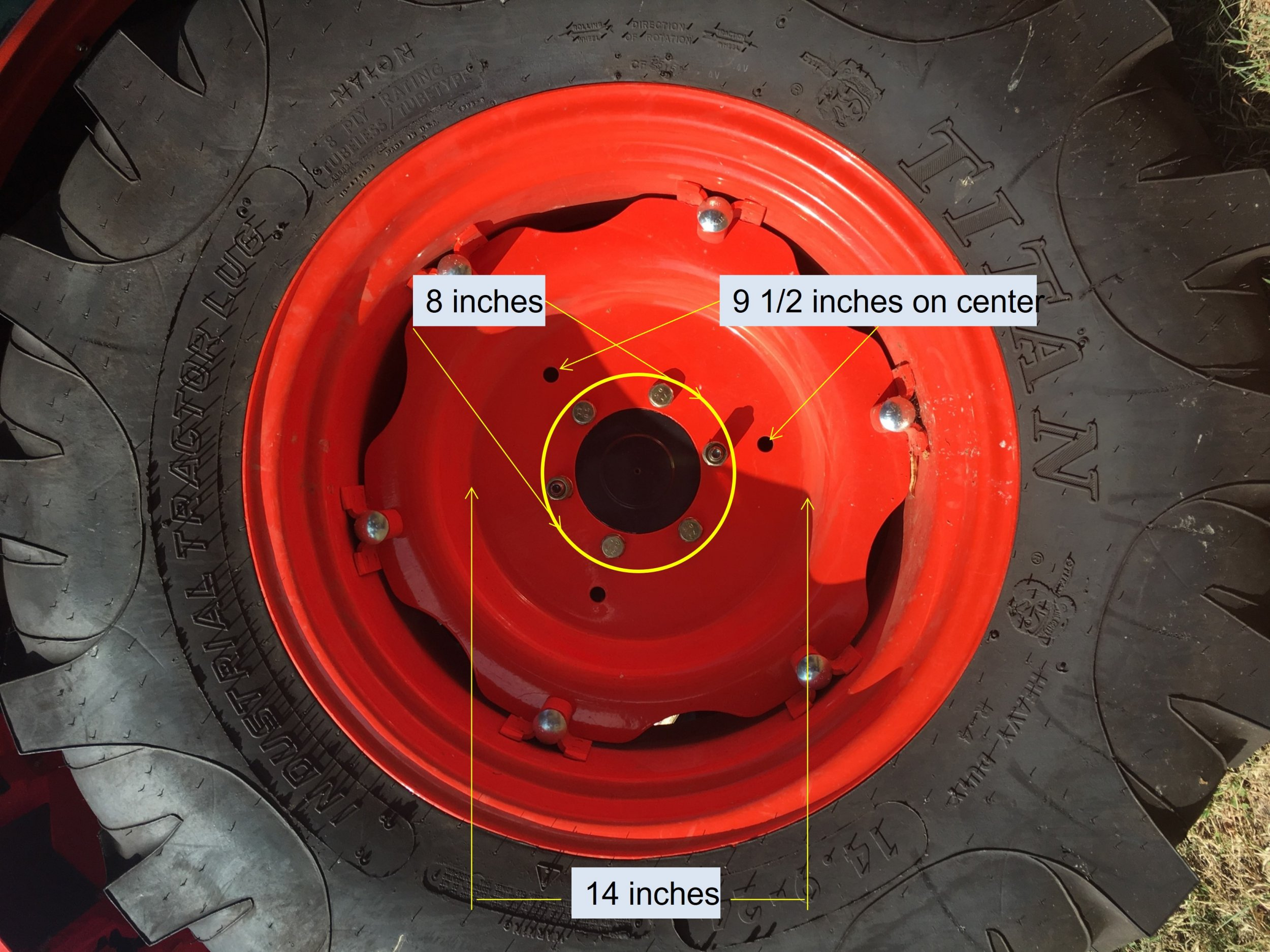

Sep 25, 2021 / Wheel weights for DK10se series #2 A AWSubie Platinum Member Joined Jun 9, 2013 Messages 766 Location Fort Worth, Texas Tractor Ford 2N, Kioti NX5010 HST Cab I have a nx5010 which I believe uses the same industrial rim. The dimension is 9 1/2 inches center to center. Attachments 5010rim.jpg 2.2 MB · Views: 147
Sep 25, 2021 / Wheel weights for DK10se series Thread Starter #3 OP M McTowner Member Joined Sep 19, 2021 Messages 29 Location Towners Tractor Kioti DK10se, JD (Jim Dandy) Thank you AW! Nice graphic
