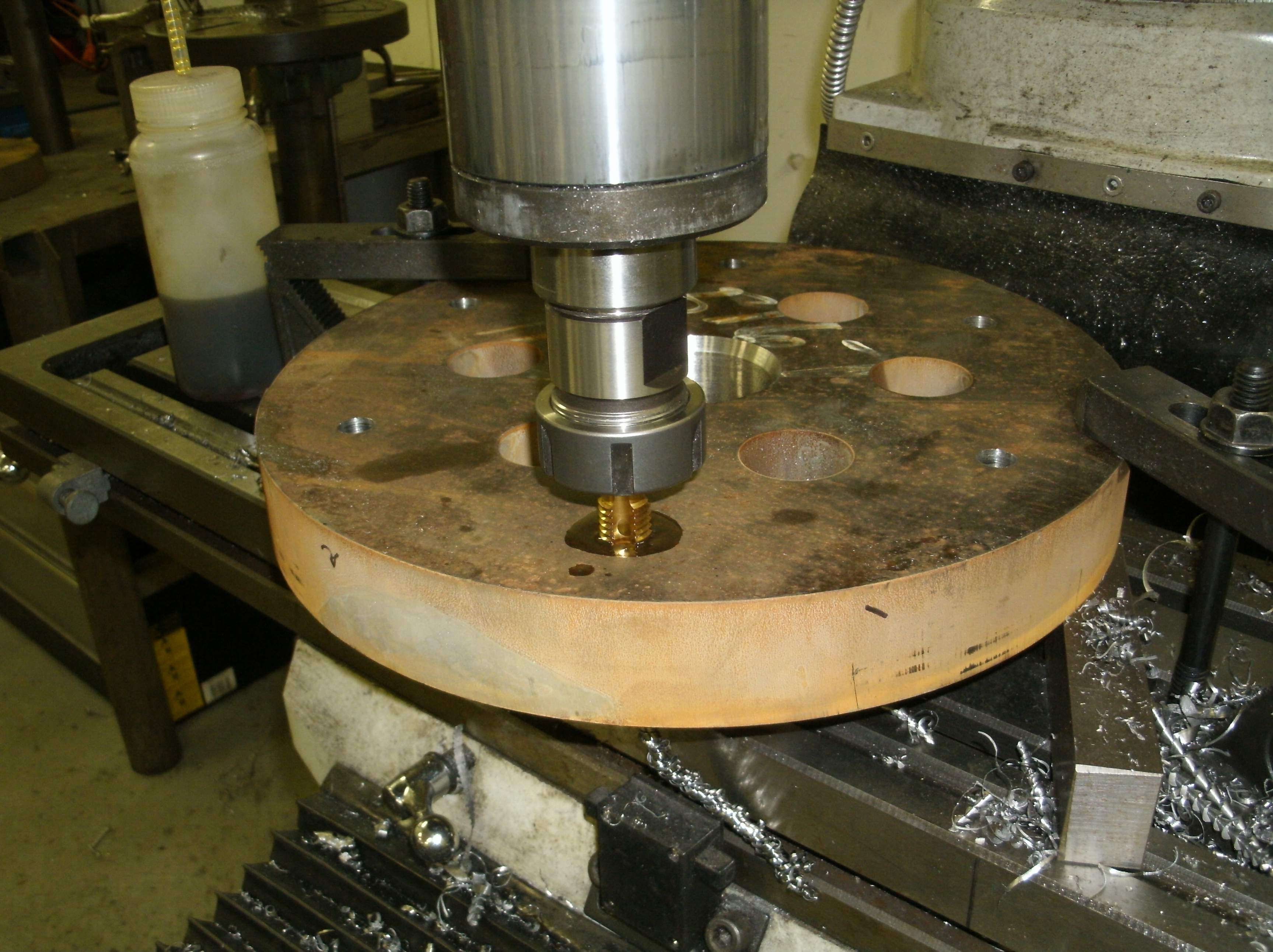

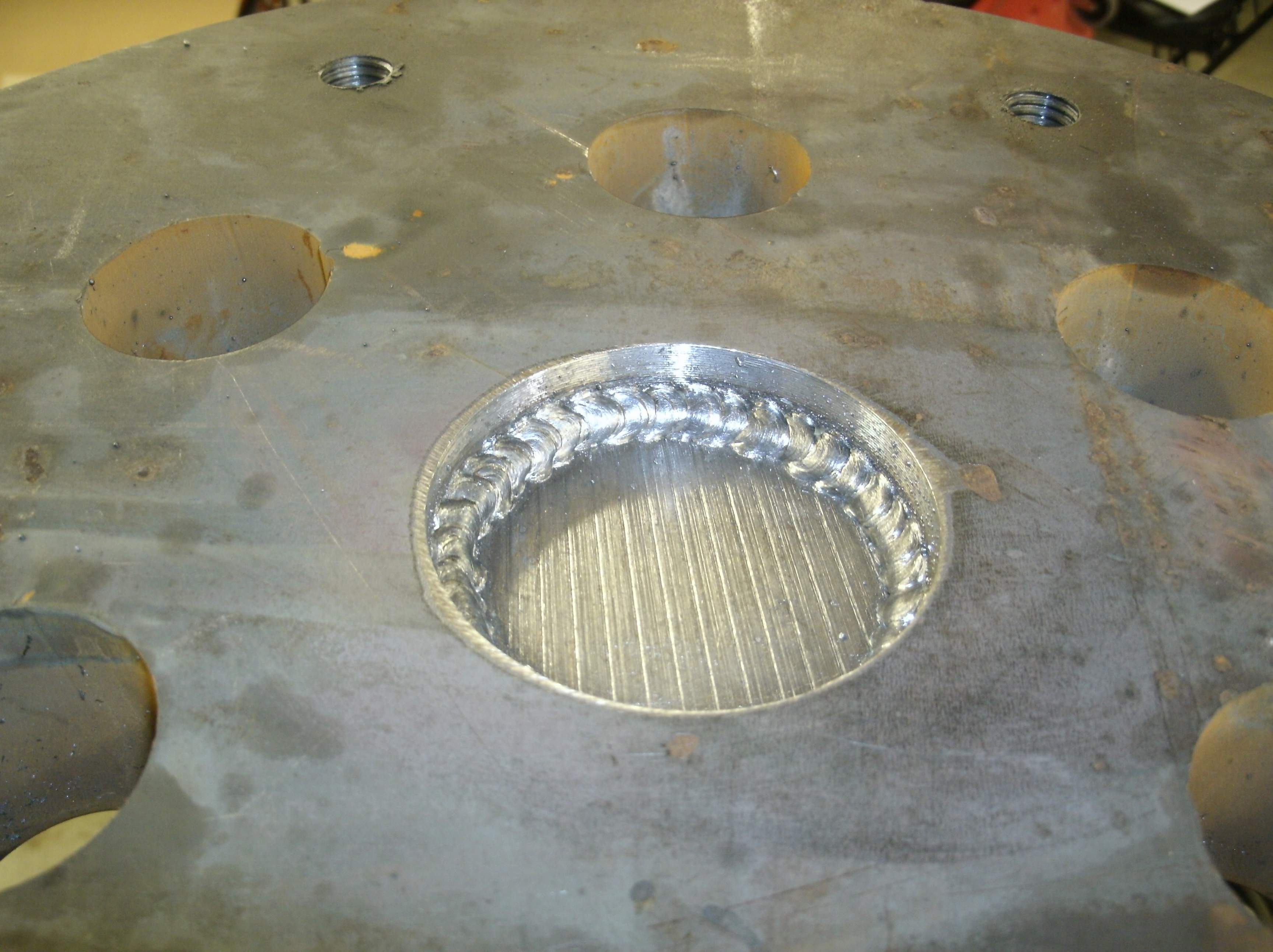

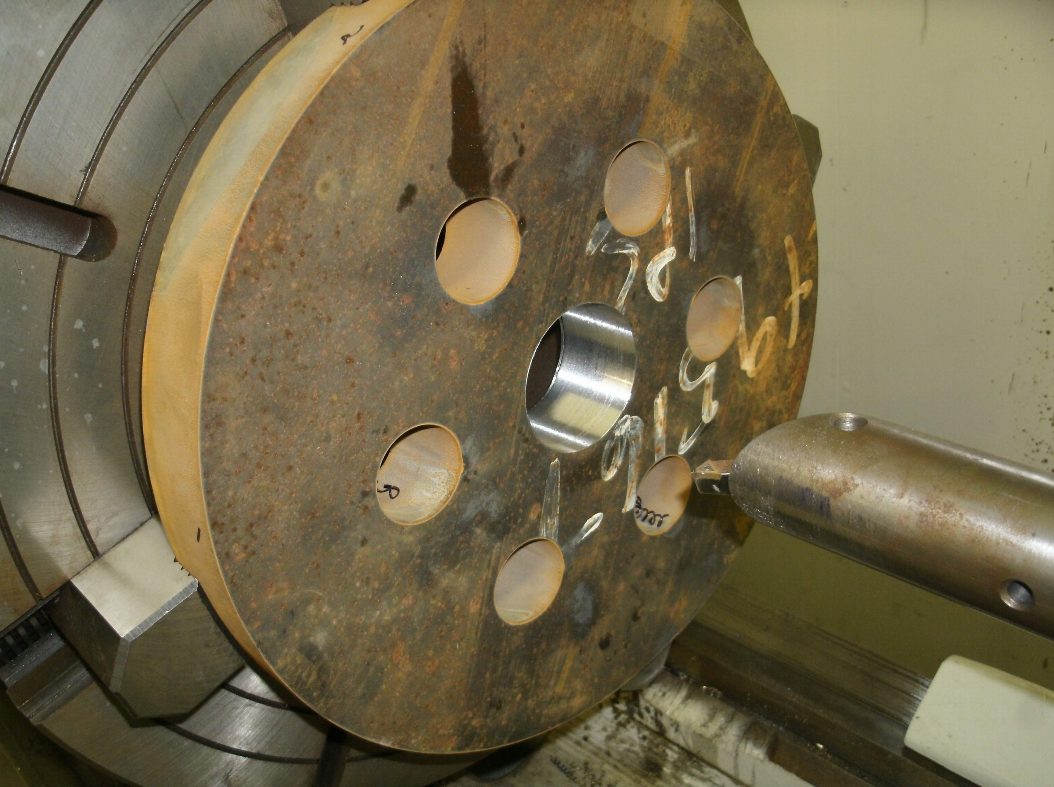

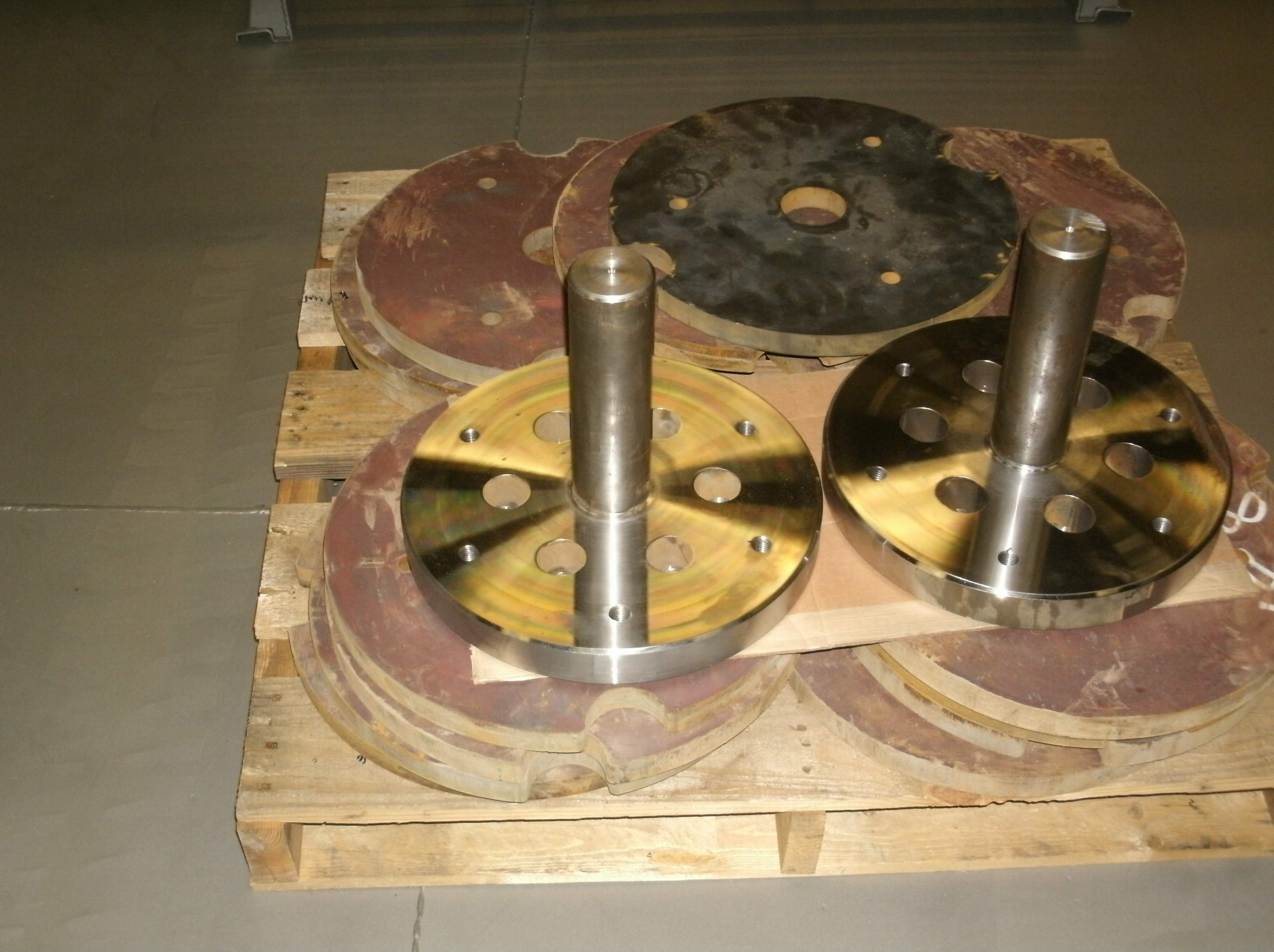

Need some rear ballast for my tractor and I don't want to make its footprint any larger because of some of the tight spaces I get into. So my wishlist goes like this: I like to fill up the center of the rear wheels with weights and I want them to be fairly easy to lift. My idea is for a mounting disc with a center pin so I can slide the weights on and bolt them up. The mounting disc is 1-3/4" thick x 13-1/2" so it will bolt up flat to inside the wheel. I had these water jetted with the inside hole slightly smaller than the 2-1/2 pin I'm going to use so I can machine it for a press fit. I had clearance holes for the wheel bolts so I can fit a socket through if I need to remove the wheel or torque the bolts later on. For the weights, I went with 1" steel plate x 16" diameter, total of eight per side. This should get me around 500 lbs per side plus I had the tires filled with Rimguard. The pictures show the mounting disc being machined for the center pin, indexing and tapping the holes for the mounting studs and the weight bolts, welding the pin in and the mounting discs after machining along with the individual weights. More as I go----

Thanks! The press fit is just for the pin going into to the mounting disc. The reason for this is because if you have any play between the pin and disc bore, over time it will crack the weld on the backside. The weights themselves are sized to slide onto the pin with a minimal amount of play.
I coated them up yesterday and got one mounted on the left wheel. Should be able to wrap it up tomorrow and yes, more pictures forthcoming!

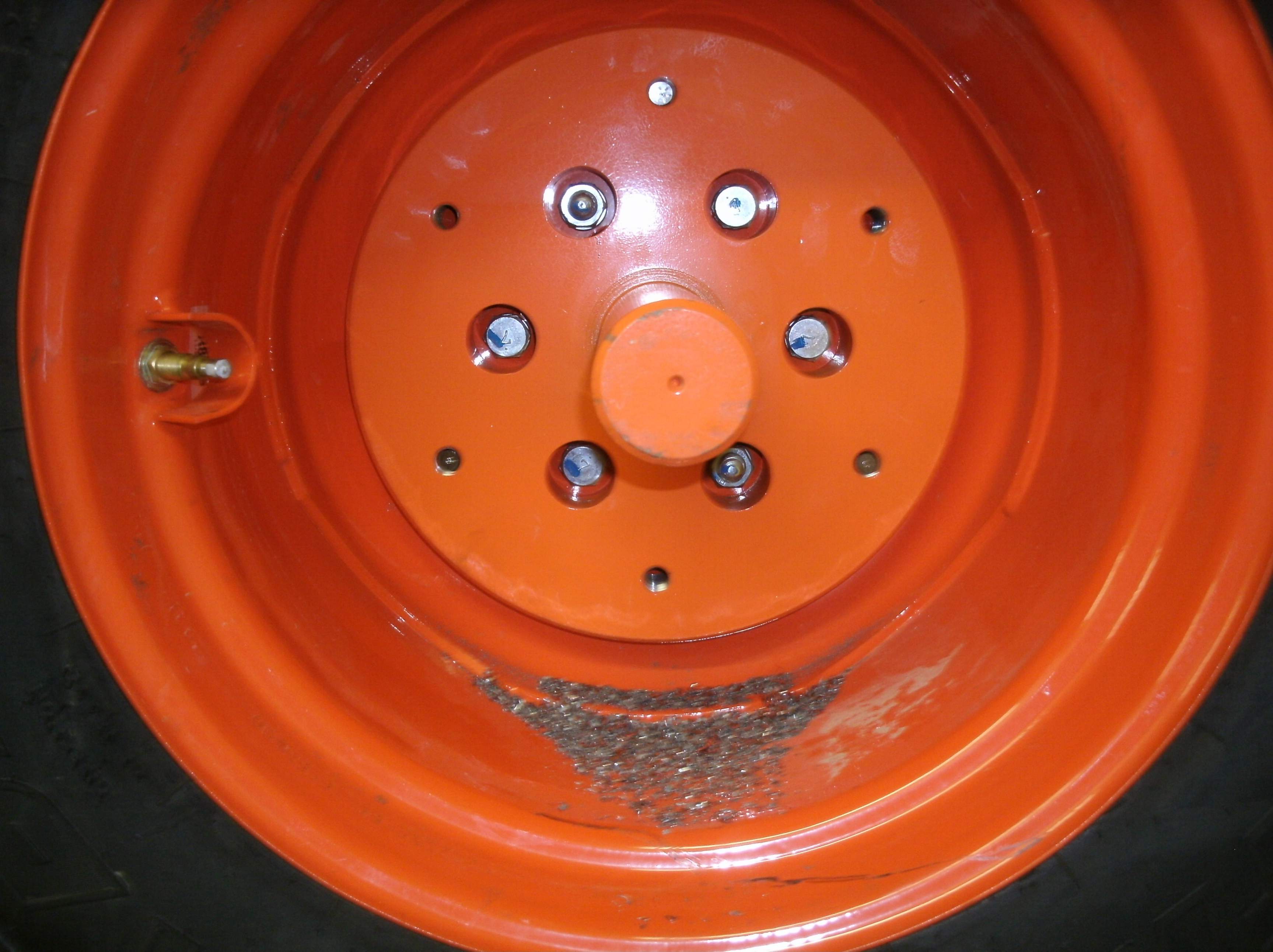

They do, but I wanted to max out the weight without going beyond the edge of the rim. Don't think i could get the weight i desired with the factory weights. I will be in the range of 500 lbs per wheel and the weight will be riding on the pilot hole of the wheel instead of on just bolts. Pictures of the final product tomorrow.

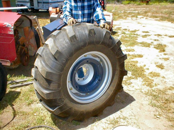

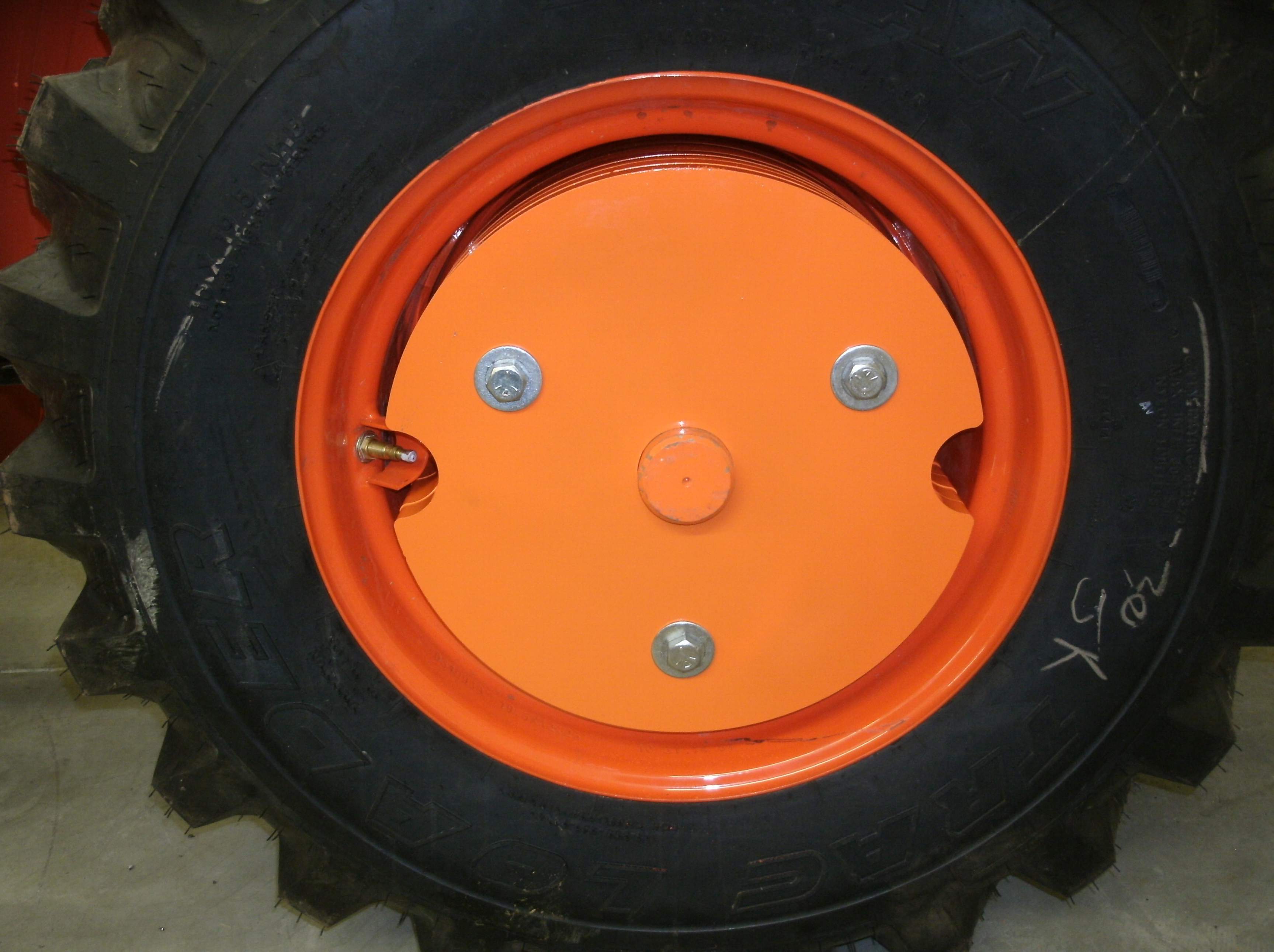

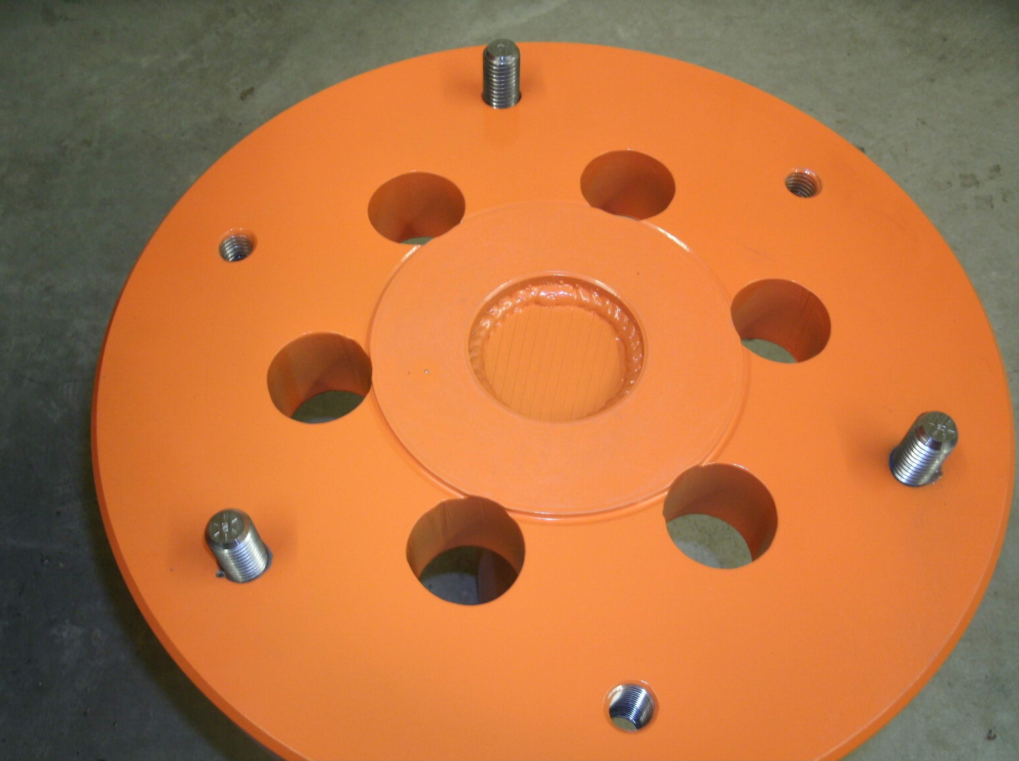

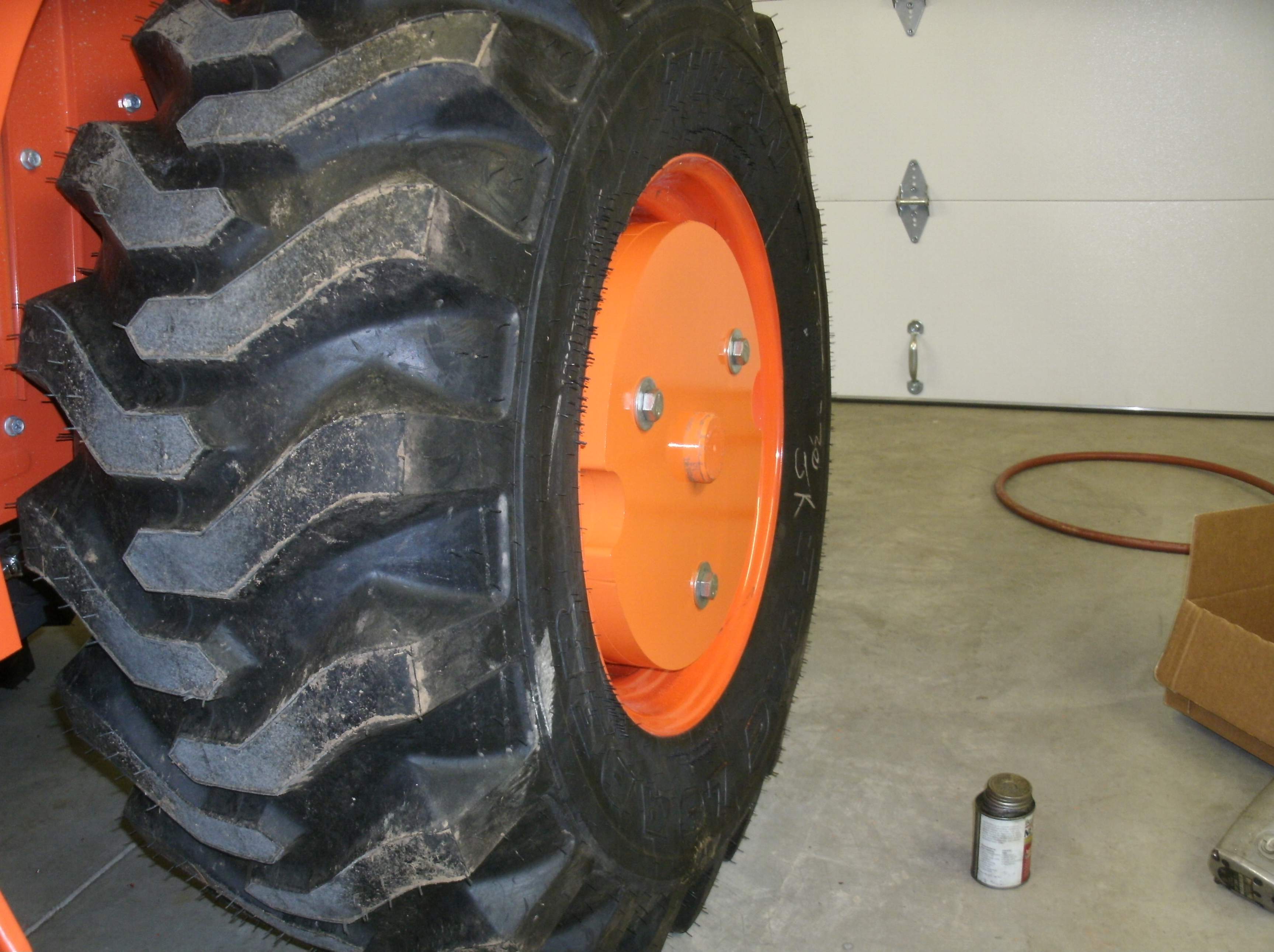

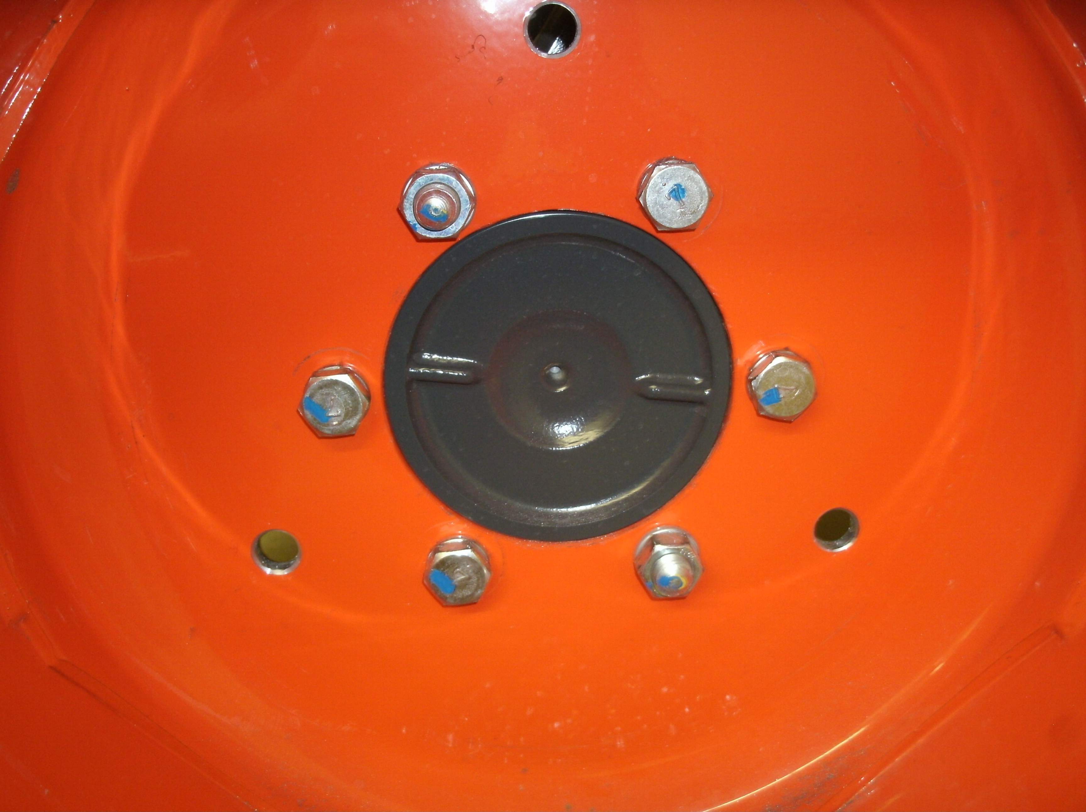

The first picture shows the least fun job of this whole project, drilling holes through the wheel! No other way to do it except by hand, but we got through it. The second picture shows installing the mounting studs with Loctite plus punching the threads for a little insurance. You'll also notice the male pilot hub I machined to fit into the pilot hole on the wheel. Kubota didn't give me much to work with, only about .075" but it should work. The third picture shows the mount installed and torqued. The fourth and fifth show the weights installed and how they don't protrude past the rim.
Hoping to put it through some sea trials this afternoon and then retorque the bolts and nuts.

Did some grapple work with it today and was pleasantly surprised with how it handled. Was noticeably more stable on the hill especially with the grapple full of wood. The FEL will be the better test in a few weeks.

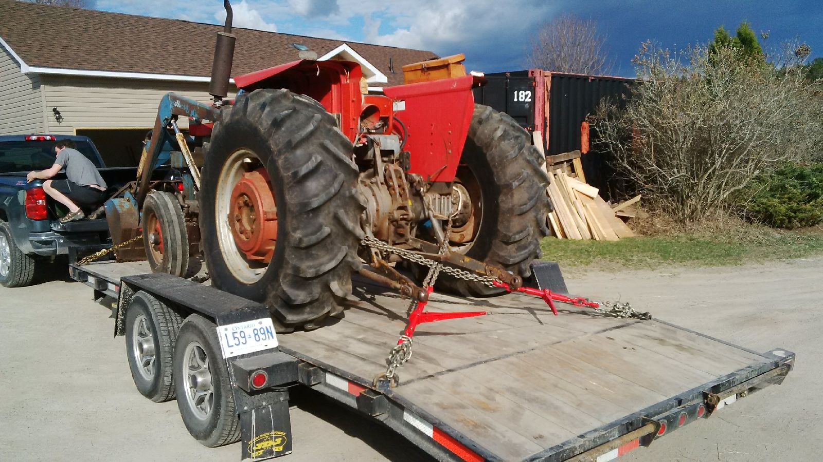

I am not a big fan of tire ballasting for FEL work. It does zero to take the load off the front end. Its perfect for added traction when pulling impliments. When I look at commercial equipment, it either has a monster backhoe on the rear for ballast or an articulated steering system. If you do mostly field work and occassional loader work, its a good compromise. One only has to have a tractor with no or non-functioning power steering to understand the stress on the front end, steering componets. I have a MF165 with loaded tires and wheel weights. At about 1500lbs per tire it will pull a house but I still need to drop the loader, lift the front of the tractor, turn the wheels, raise the loader and then go in my new direction (hoping my power steering pump leak is solved lol)
