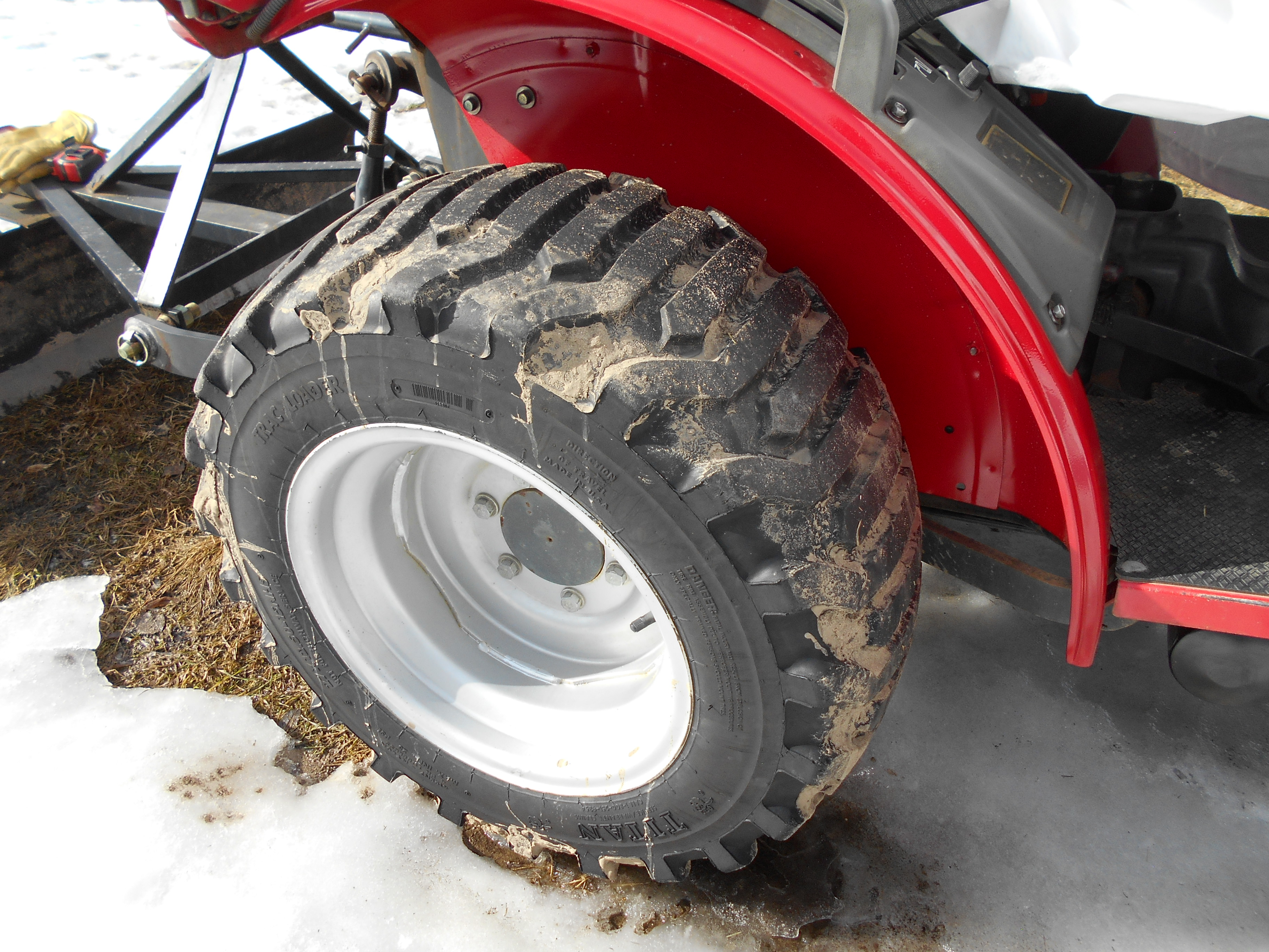

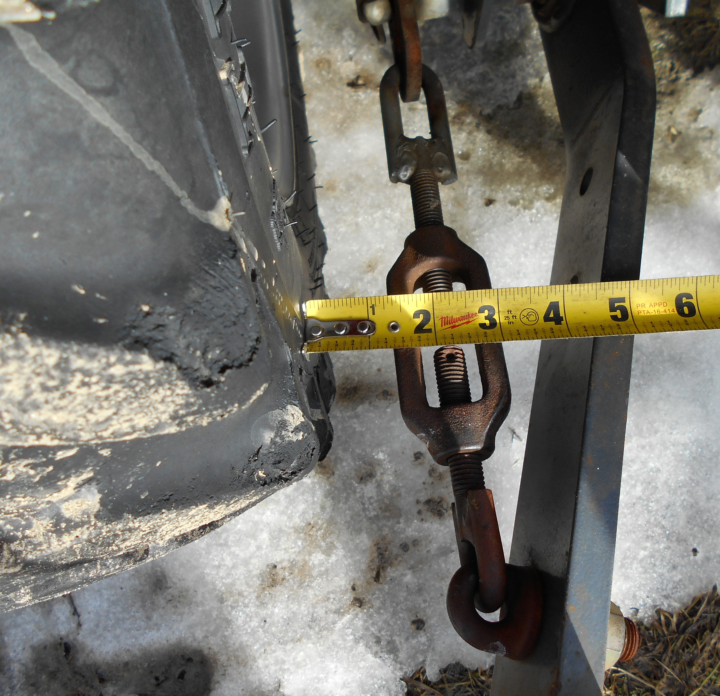

Glad you brought this up, I hadn't thought to check clearance before ordering rear chains :rolleyes:
My 1815 doesn't appear to have this problem, lots of room front of tire to frame and about 1 1/4" rear of tire to 3-point turnbuckle.
I have ordered these ATV chains ATV Twist Link Tire Chain Diamond Studded - Part no. ATV3DS they seem to fit your tire size.
They appear to fit the tire in the picture very snug, could be a lot different on an industrial tractor tire though.
Hope this helps?

Thats not all that much clearance, sometimes the tire chain connector will take or need more clearance room depending on the connector and then if the chains get loose that might start hitting parts of tractor, that bang bang sound of chains hitting something is not a good sound to have. But there are usually some ways of making things work...........
