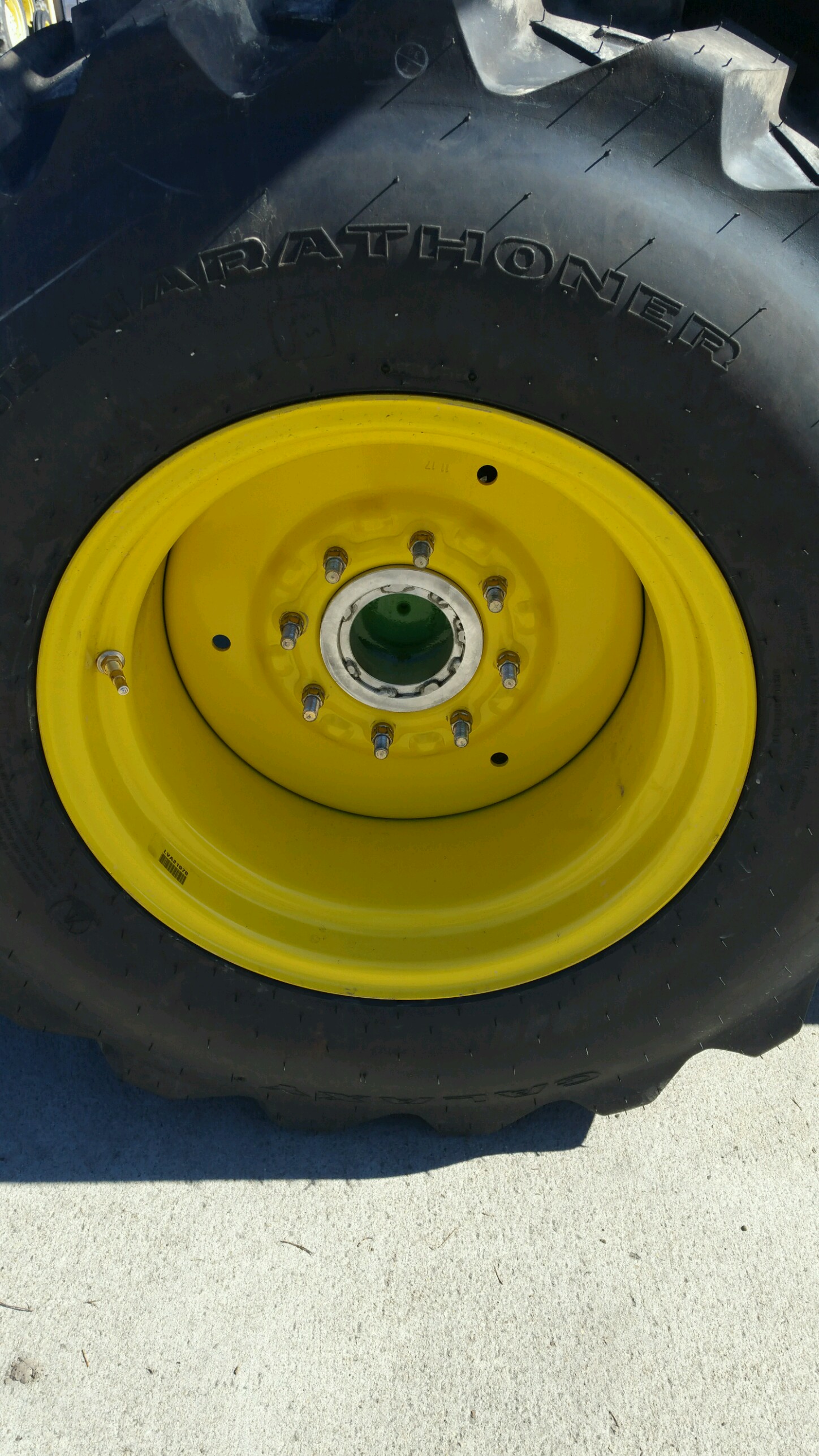

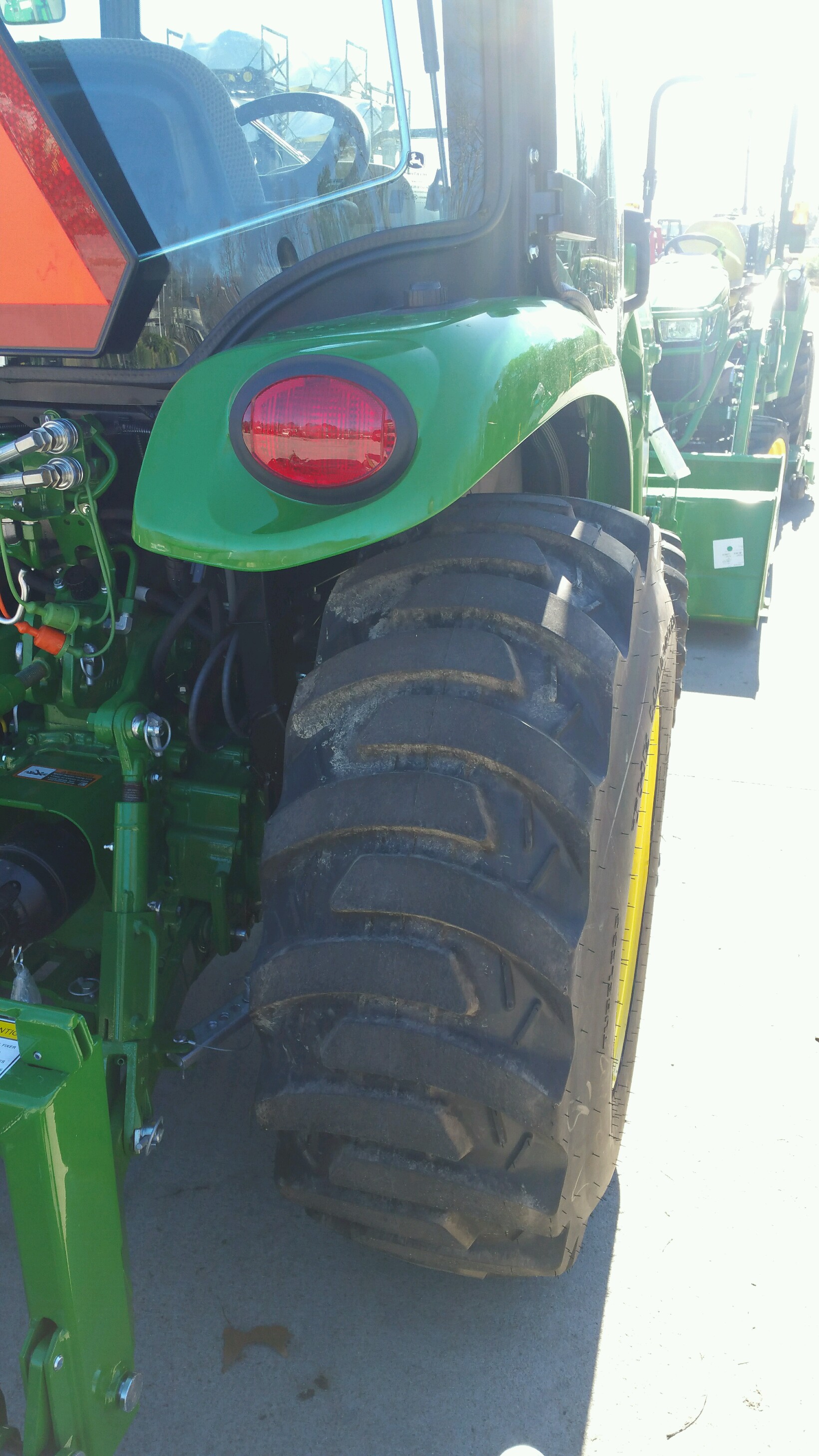

Can anyone recommend what width for spacers on a John Deere compact tractor 2320 (front and rear) all help would be grateful. Thanks
I put 2 inch rear on my 3046r. Reversed the front tires and they seemed to be too far outside the rears so I went back stock on the front. A0FEE5E2-3A66-4CB0-8203-2994161A8411.jpeg939D4C58-4244-4D9B-AD87-87BAA0D81663.jpeg
