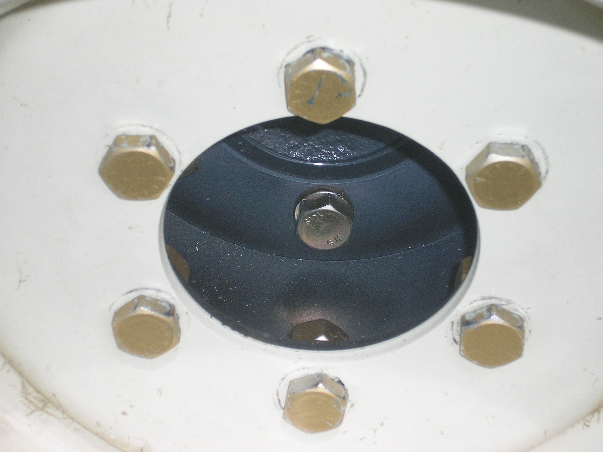

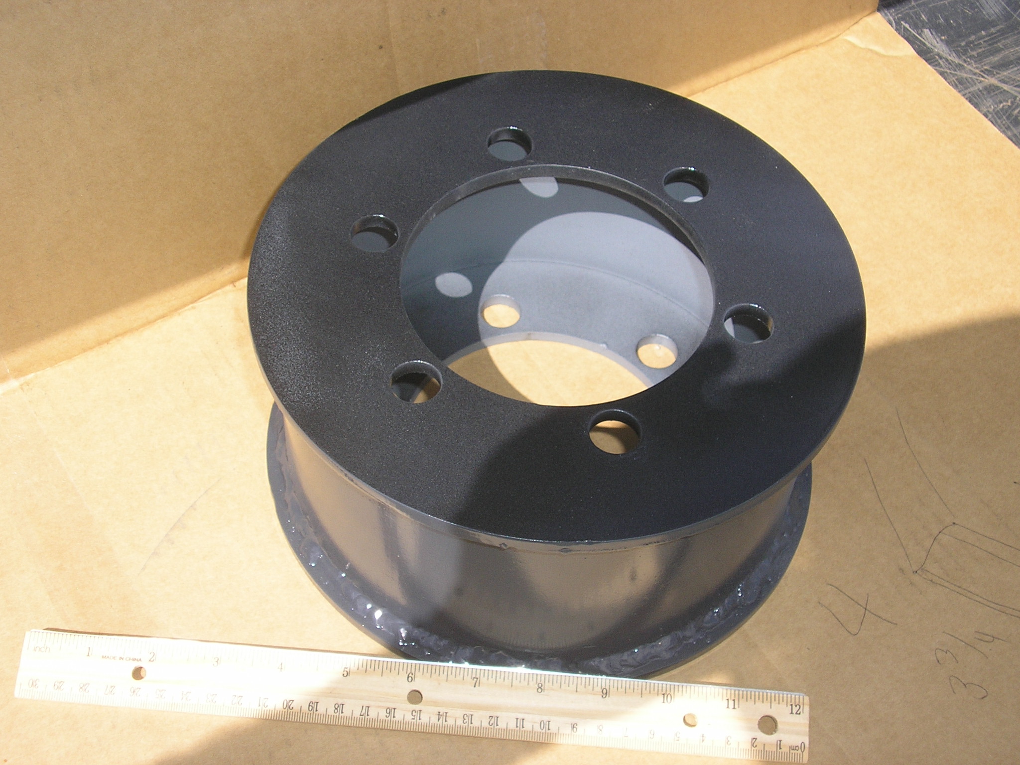

I built mine out of 0.25 steel plate and two 4" long pieces of 8" Sch. 40 steel pipe for a pair of 4.5" spacers. Made a template for the plates from the wheel holes and took it and the stock to a local machine shop. Made the diameter of the plates 0.5 wider than the pipe to give me a flange for a nice welding joint. I did everything but machining the 4 plates. Stock was about $40 and machine time was $100. In attaching the plates to the pipe, ensure that the holes are lined up so that the shaft extension for the impact tool can stick through the outer hole to get to the socket on the inside bolts securing the spacer to the axle flange.
Note: I had to use decimals as there is some kind of error in uploading if I use fractions.....sorry about that.
