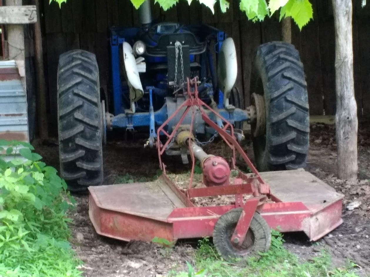

I'm of the wider is better school of thought. Actually in my case, wider is a necessity since a lot of my property is literally the side of a mountain. That is a 6 foot hog.
