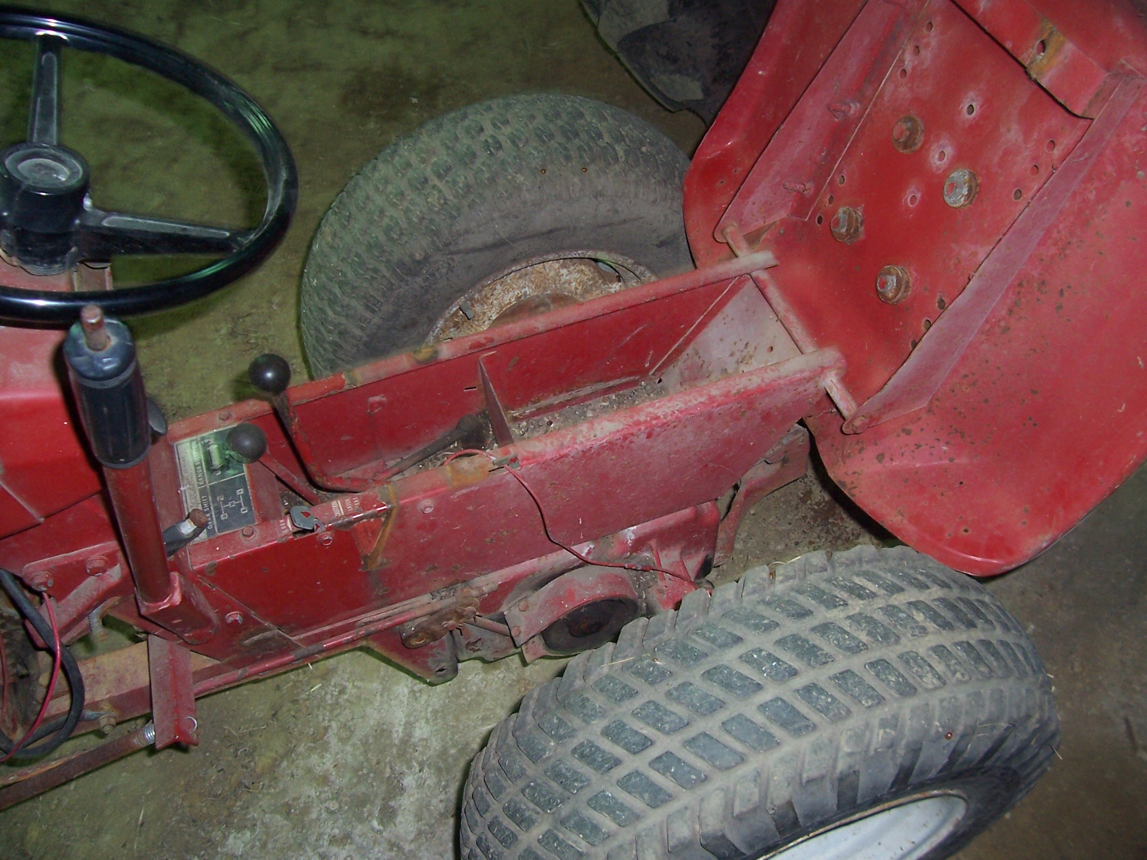

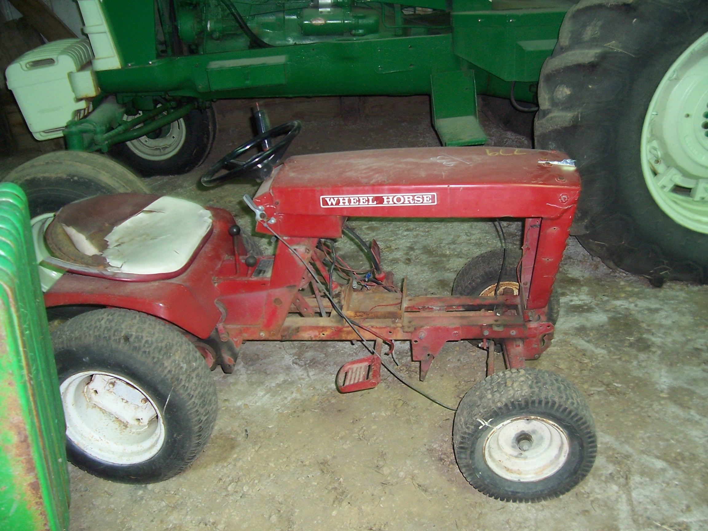

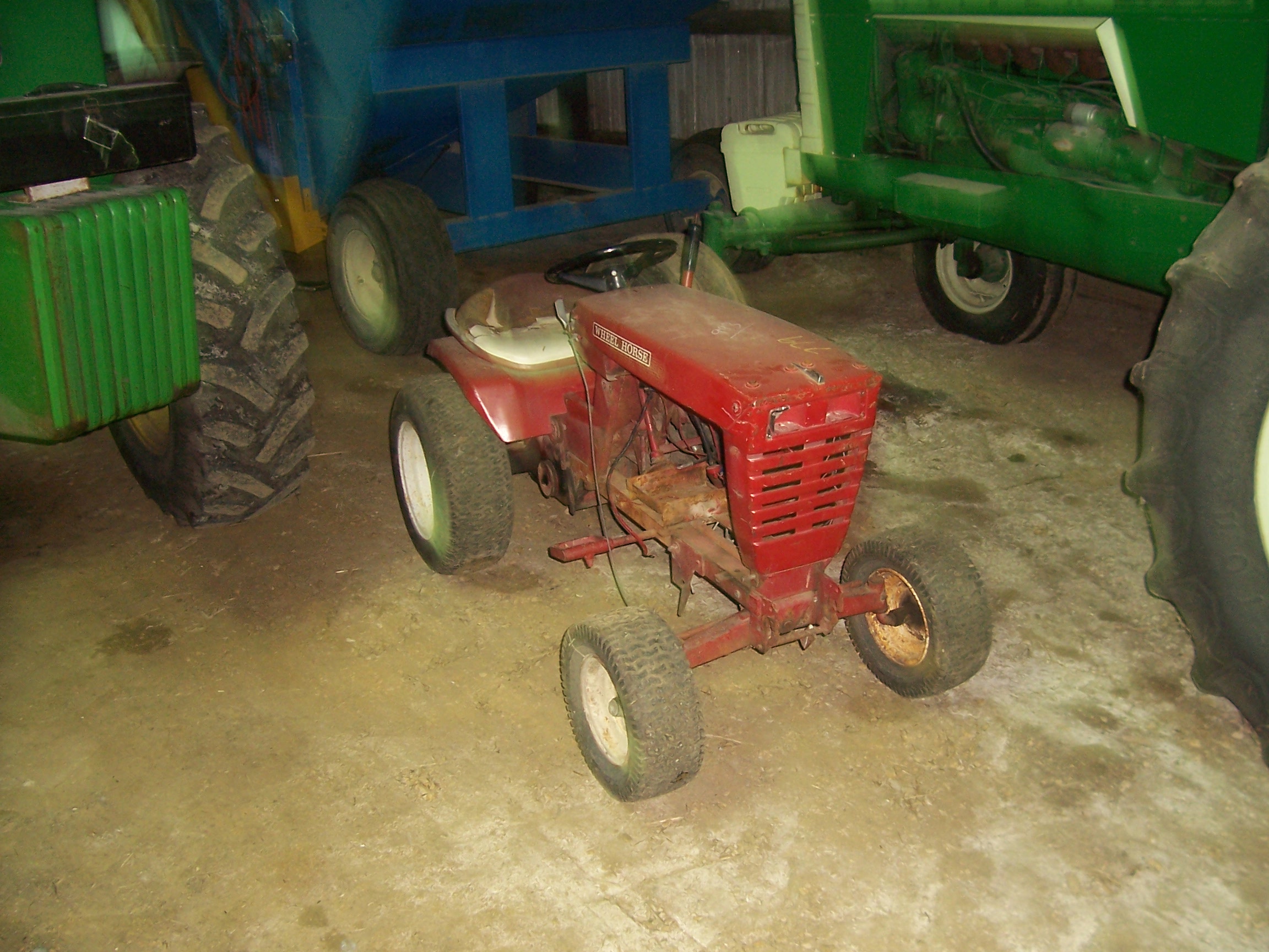

here are 3 pictures of the wheel horse hopefully they are helpful

Well, it's definitely late 60's or early 70's. It also has an 8 speed transmission, (including reverse), judging by the high and low range lever, along with the normal gear shift lever. The hood sticker, (although it might not be original), in my mind is pushing more towards the tractor being from the late 60's. My 61' 401, 551, and 63' 633 all have the serial number on the bottom right or left front of the frame, just behind the hood. Off hand, I can't remember where either of my 68' Commando 8's have it listed. Hope this helps.

I had a model very similar (1968), and it had an 8 HP Kohler. With this having the high/low range (mine didn't) then I might think it had a 10 HP Kohler, and be early 70's.

No, 1056's only had 4 speed transmissions. In 1967 the first 8 speed transmissions were introduced in the WH tractors with he 1067 and 1267 models. In 68' the Raider 9 and 12 were debuted featuring 8 speed transmissions. The 69' model year didn't market any 8 speed tractors to the public. In 1970 the Raider 10 offered both a 4 speed and an 8 speed trans, and how it was equipped depend on which 10hp Tecumseh engine it had. The Raider 12 for that model year was also an 8 speed tractor. In 71' the Raider 10 and 12 again both had 8 speed transmissions, but only came with 1 standard engine for this year. 72' kept the Raider 10 and 12 with 8 speed transmissions, and also introduced the Raider 8 and 14 models featuring 8 speeds. Just looking at your pictures, I would think the tractor should to be within those model years.
