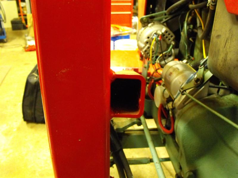

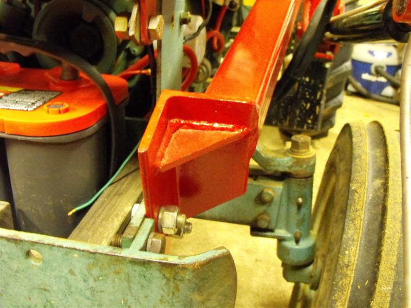

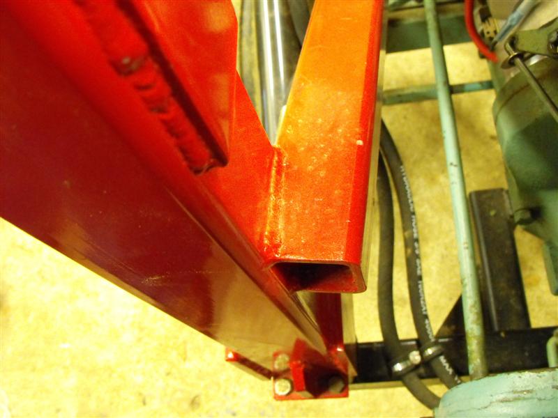

Looking good! Angle of the arms and bucket placement look right from the pics. The sub-frame doesn't have to be overly beefy but it needs to be strong enough to take side to side twisting. I've seen some fairly small frames work though. Be sure to tie it to the part of the frame the engine is mounted to also. Keeps a lot of pressure off the bell housing if that is where you wind up attaching the frame to. Here are some pic's of the arm brace on mine. It is 2" square tubing and 12 gauge if I remember correctly.
From the looks of it so far, I think you are going to have a good loader setup.
