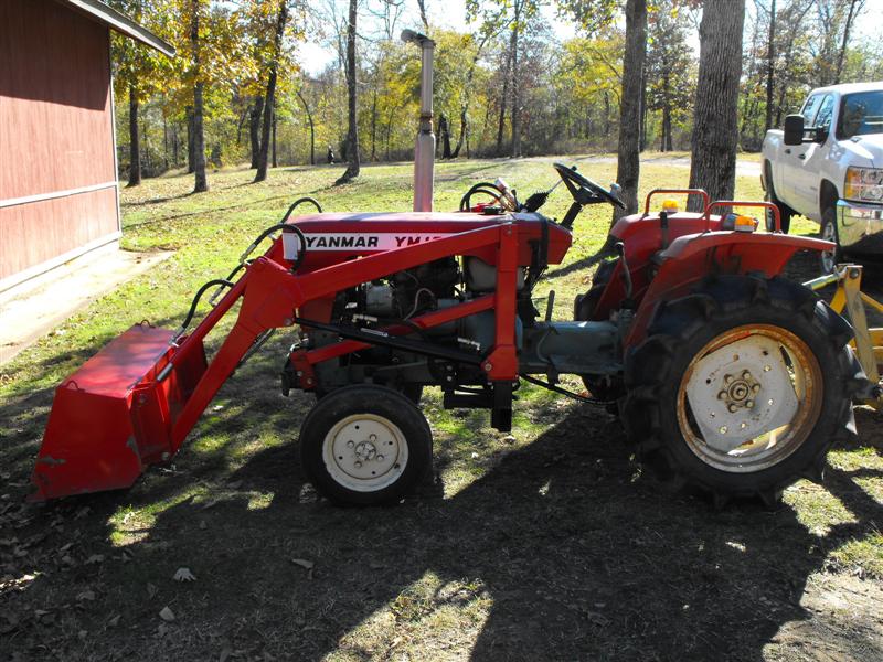

Update:
Pretty much got the loader mounted and working.
I still need to remove all of the parts and paint the sub frame but I'm out of energy today..

Looks like you have a nice loader now.
   / Wheel Horse Loader, install on Yanmar #56
Good job:thumbsup: The fit looks good on the tractor and you did it rather quickly too. If you haven't used a loader before, they take a little getting used to. Mostly in learning when the bucket is level. You will find a ton of uses for it. Nice work!

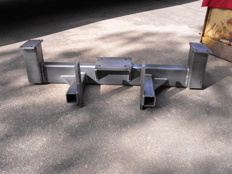

Ran the tractor around and noticed if I cut sharp the front tire tries to grab the sub frame. I'll have to cut a little more out of the way.
If I could only weld like a pro instead of a dirt dobber :)
When I was welding the support arm from the tower to the front of the tractor I had a hard time not blowing a hole in the lighter material. All I have is 1/8" rods, so I'm guessing a smaller rod would work better?
Need some bondo to fill in the holes :D
Any suggestions...

The guys in the welding section can probably tell you several ways to fix it. When I blow a hole in thinner metal I use a thicker piece to fit the hole or cover it and weld to that and let the weld travel to the thinner piece. Thicker piece will take more heat. Ideally it would be easier to fix with a wire feed welder but not everyone has one. I have both and rarely use the arc welder except for welding on the Case backhoe. I built my entire loader with the wire feed and so far no welds have broken.

Awesome job! You will think you've died and gone to heaven and wonder how you ever did w/o it. Be careful though, there's a real learning curve to having a FEL on a tractor your used to running w/o one. It will help immensely to hang a box blade or other heavy implement on the back when using it. That counter weight will not only help it to lift more and get better traction but be safer too. Always travel with the bucket as low as possible. With the FEL, they are much easier to turn over in some situations so always remember it's a different machine now.
