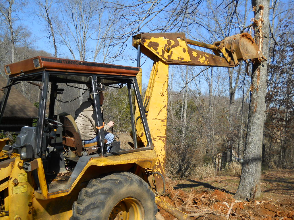

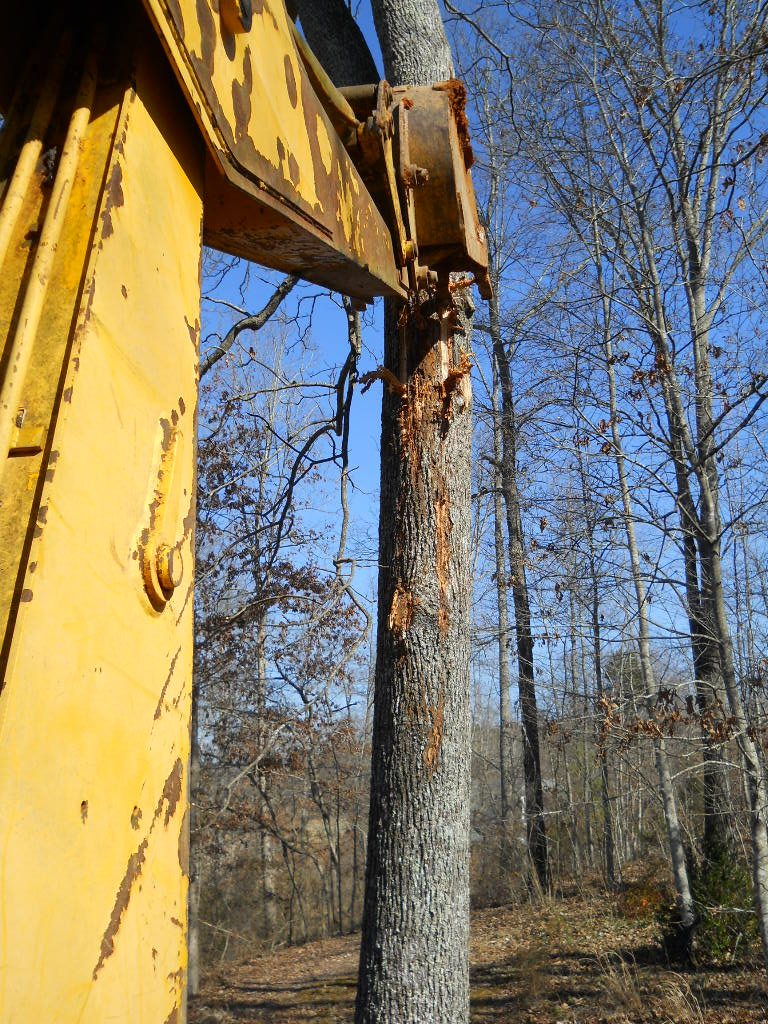

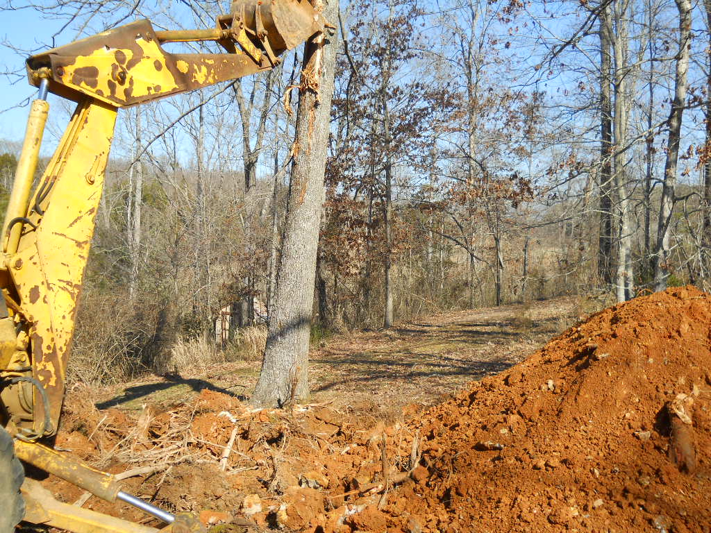

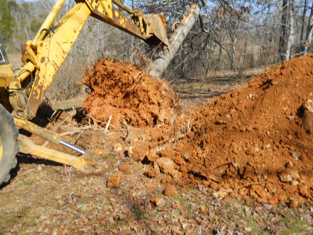

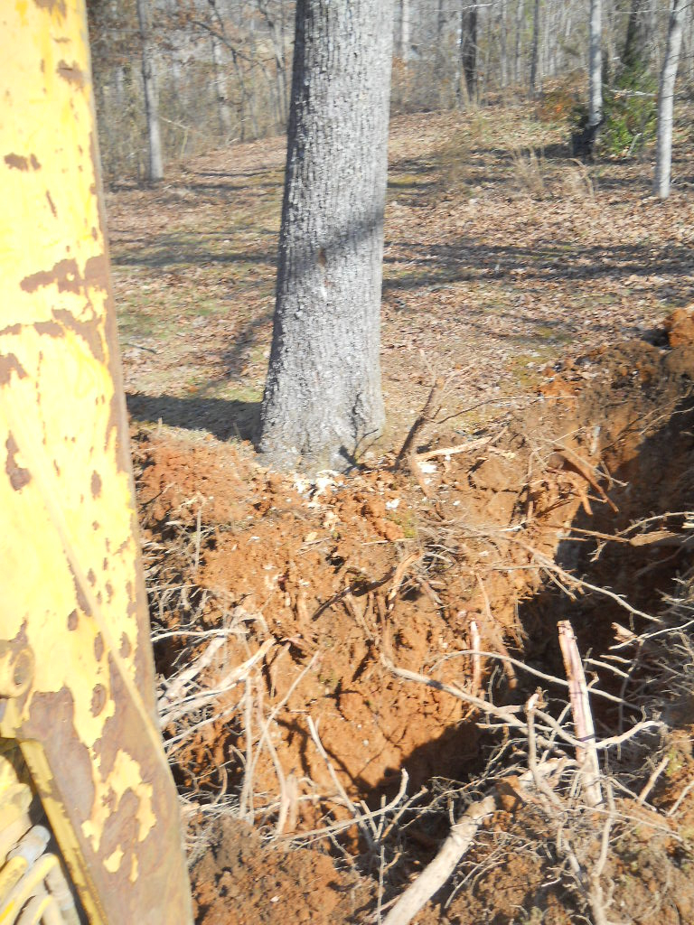

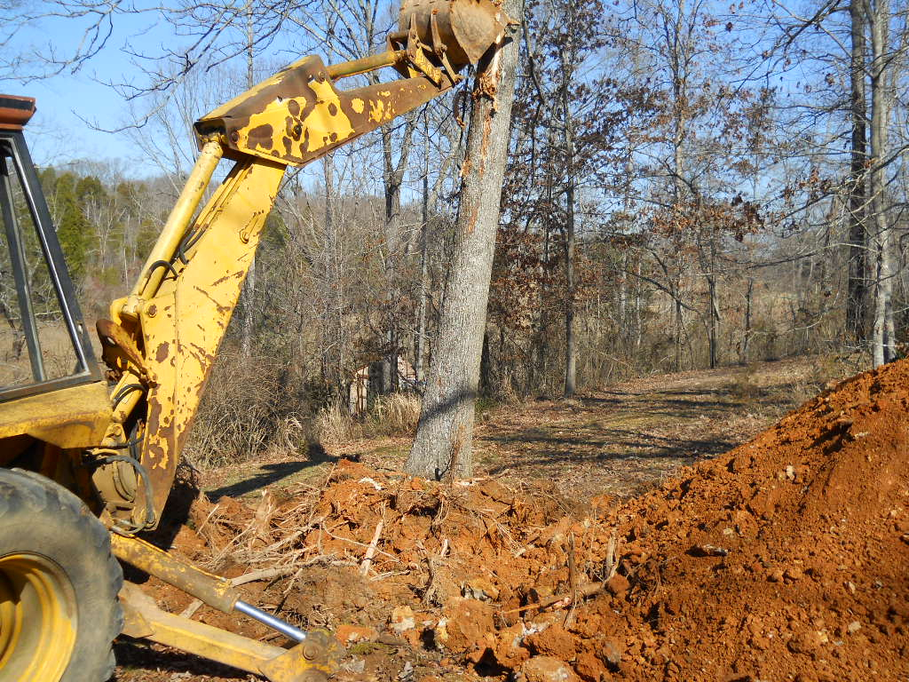

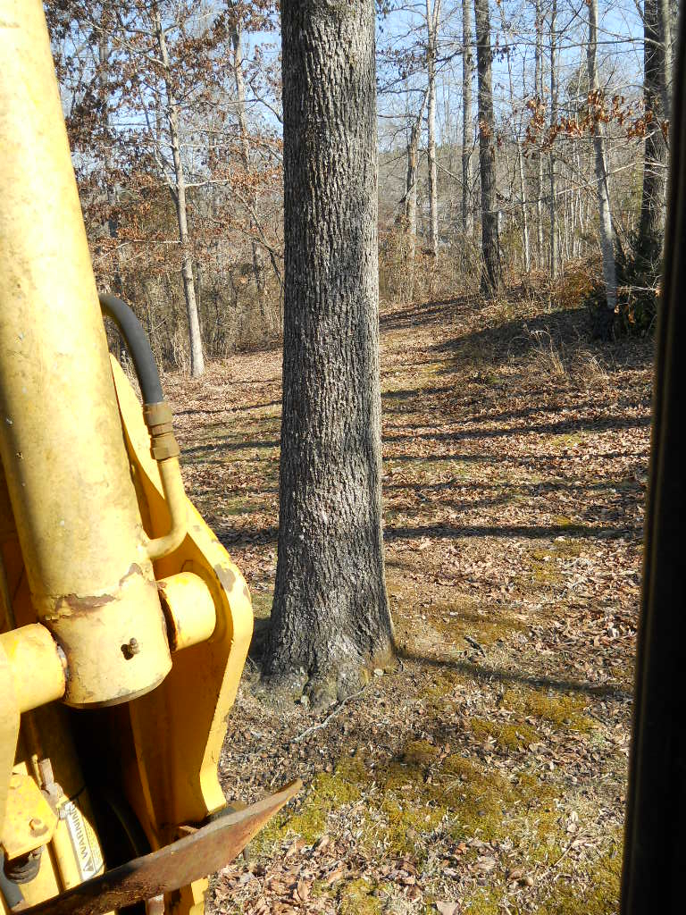

I use my hoe to dig up part of the root ball and leave part of the ground untouched to (hopefully) act as a hinge to keep tree from falling a direction I don't want.
My wife's cousin lives next door. Had a tree that was too close to the house, wanted it down....didn't trust himself with a Stihl... I said what about digging it.... he thought that was interesting.
I've shared these before so if you've think you've seen them, you might have.
   / What's your technique for removing trees/brush with your grapple? Here's mine.... #72
Best part was, I got to make the mess, drop the tree..... when done, I got to go home. He & his helper used his smaller tractor/loader to cut it up and dispose of it.
