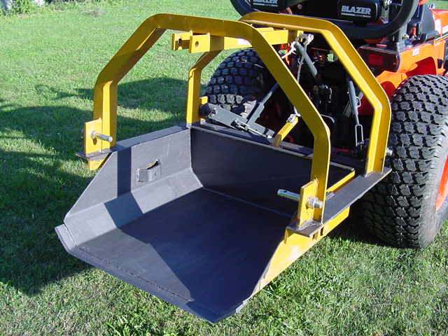

I borrowed (okay, stole) this picture off the forum from Cchoate (thanks!). It's a dirt scoop. It looks as if it could be used in place of a FEL. I know, a FEL would be a lot more versatile. But if I'm on a budget and I'd be a lot better off paying $12,000 instead of $15,000, AND I don't have a lot of digging to do, wouldn't this be a pretty good substitute for a FEL? Just curious.

Second question -- can it be mounted on the front?

sorry, here\'s the picture
I guess my CRS is acting up again. Here's the picture.

I soft soil etc..you should be fine,but the hard stuff..rocks etc..I would be gentle,for you don't want to damage the 3 pth etc..backing up to fast while loading.
You may also want to consider some front weights.

I have a scoop like that, and it has been very useful. I used one to dig a 300' long swale along one side of our property. They can be mounted to FACE front or rear, but not ON the front or rear. It would be easier to get a FEL than adapt the scoop to the front.
The scoop has limitations. It has very limited lift, gravity dump, no down pressure, doesn't "curl" and is difficult to excavate (evenly) a width greater than the scoop width.
All I had to work with for a long time was a scoop on my Ford, and I moved a lot of dirt. It was far far better than a shovel and wheelbarrow. I got the 'Bota w/FEL last year, and have been surprised at how much easier it is to do small projects around the property. Spreading stone, light digging, gathering up big storm-damaged limbs, transporting heavy things, picking heavy loads off (and onto) the pickup, piling snow, etc have made the FEL one of my most appreciated attachments...................chim

That dirt scoop has been great for the jobs it's been used for. In 4 months I have:
- edged around my pond
- dug a big overflow for my pond (30'x20'x4'deep)
- moved and spread 3 big hills of road fill
- leveled off some rough ground
- carried rocks, bricks, ect...
Yes, a fel does more, but the dirt scoop was $260 at TSC and the fel is $2800. Check out the picture of just dug pond "muck".

I had a scoop before I got my loader. For $300, you can do a lot of stuff. For 1/10 the cost of a loader, it'll work just fine while you save up for the $3000+ loader.
There was a guy on this forum a few years back that built his own rear loader. It was effectively a wider scoop. He added a "tip" cylinder/valve and could then "curl" the scoop. His scoop was pretty much the same size as a loader bucket for his sized tractor. He made it all at home for cheap. In fact, before I got my loader, I emailed with him; he made a couple more for his buddies.

We sell a lot of these new material scoops (in various widths) to customers that cant justify the FEL dollars. They are not as handy as a FEL-- however a New $260 material scoop seems to be a resonable alternative for your situation! --Ken Sweet

NOPE! can't be used in place of a fel, can u dig with it? can u lift and move dirt with it? can u back drag with it? the scoop is a nice implement, but won't take the place of a fel.
