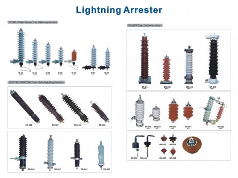

If it's connected to the power line and ground, it's a lightning arrestor. See lower right of pic

I'm not sure what it is but I wonder if it is some sort of inductive monitoring device. I heard they were rolling that stuff out now as part of the smart grid for monitoring fuse status, lightning arresters, and capacitor banks for faster diagnostics when there are outages. I really do not have a clue what it really is but just throwing it out there.
Yea, some sort of grid monitoring system powered by a Rogowski device is what I'm leaning toward so far, although I'm really enjoying some of the answers. I was actually enticed into researching Southwestern Bug Bats for a minute or so.

There is a tap on the left most phase. From there the wire goes down to the vertical devise which is the knife switch/fuse [ poor picture ]. The fuse opens up and the vertical insulator fluting helps break the arc during failure. The line goes from the base of this fused device down to the bell shaped insulator. Bell could be metal/some type of lighting drain device, or it could be just an insulator. But if it was and insulator, it would normally look like the one lower down the pole that the ground line comes off on. The users 7000 volt power line goes off to the left from there. The lower line on the pole is the ground, and the users ground goes off to the left from there.
