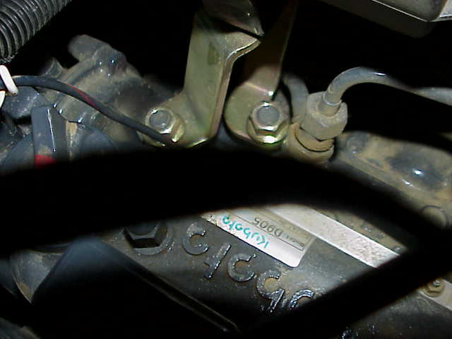

The remedy that I have found is to leave the two air cleaner to engine mounting bolts a little loose. I set them with Loctite and they have never vibrated loose and neither has my air cleaner bracket broken. I have explored other simplified corrective actions, but this is the most simple and successful method to date that I have found.

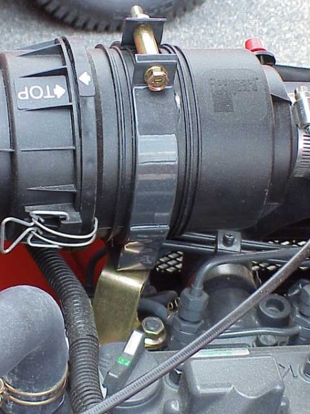

Here is a picture that I took this week of a BX23 air cleaner. I just wanted to see if it was any different than my late production BX22. From my recollection, it is the same. I resolved my possible failure by leaving the mounting bolts a little loose.
