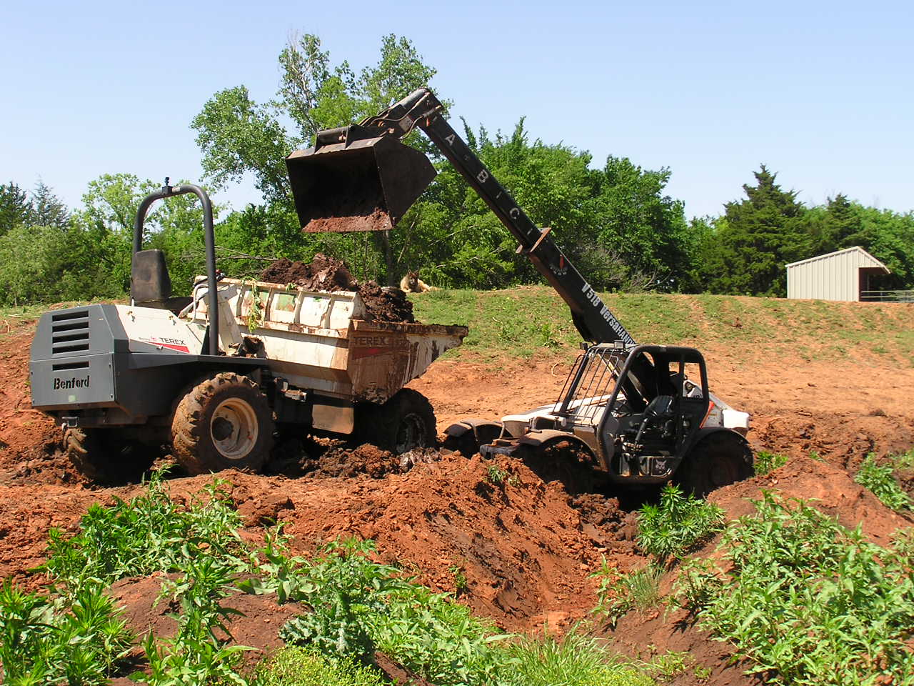

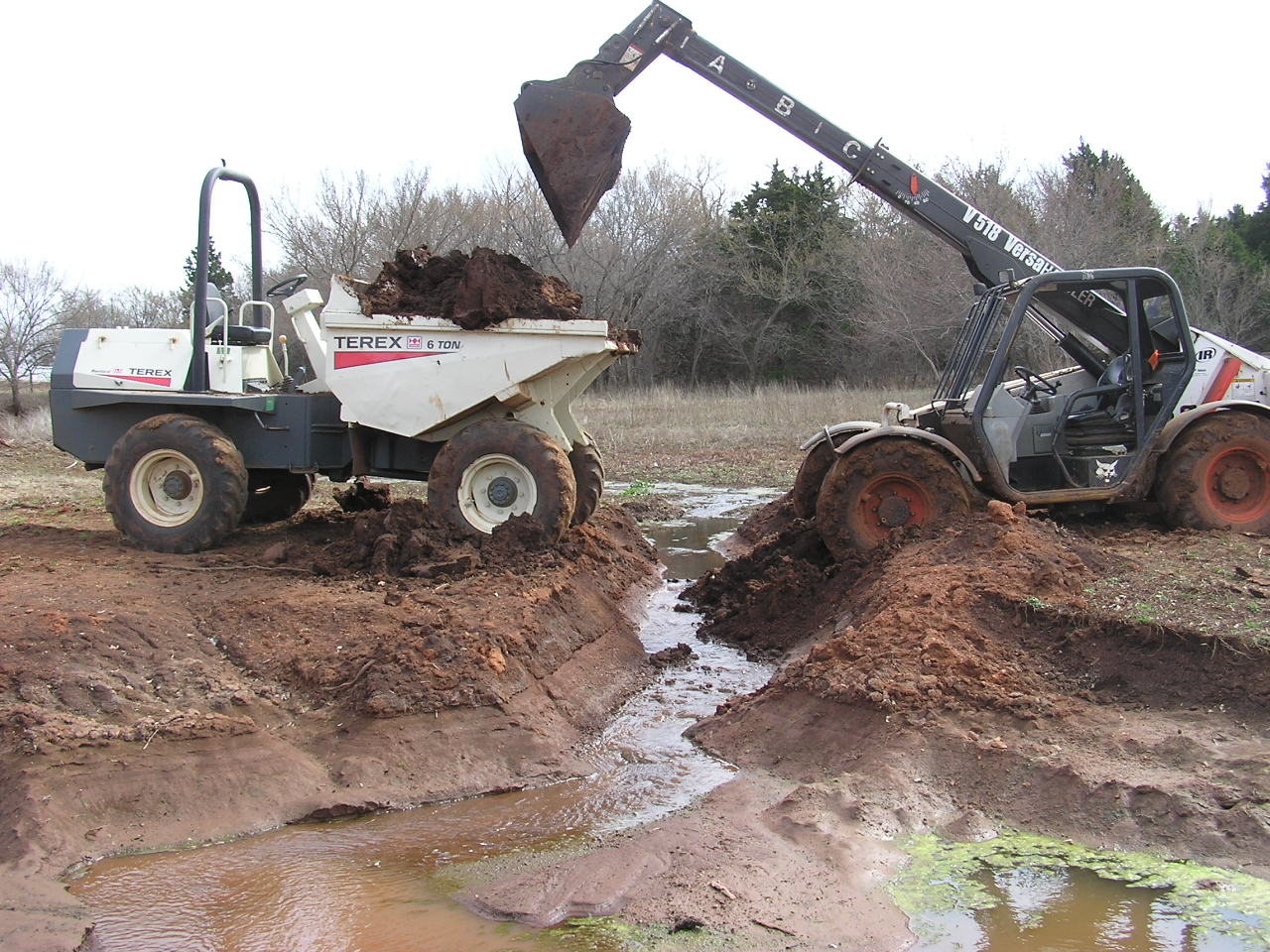

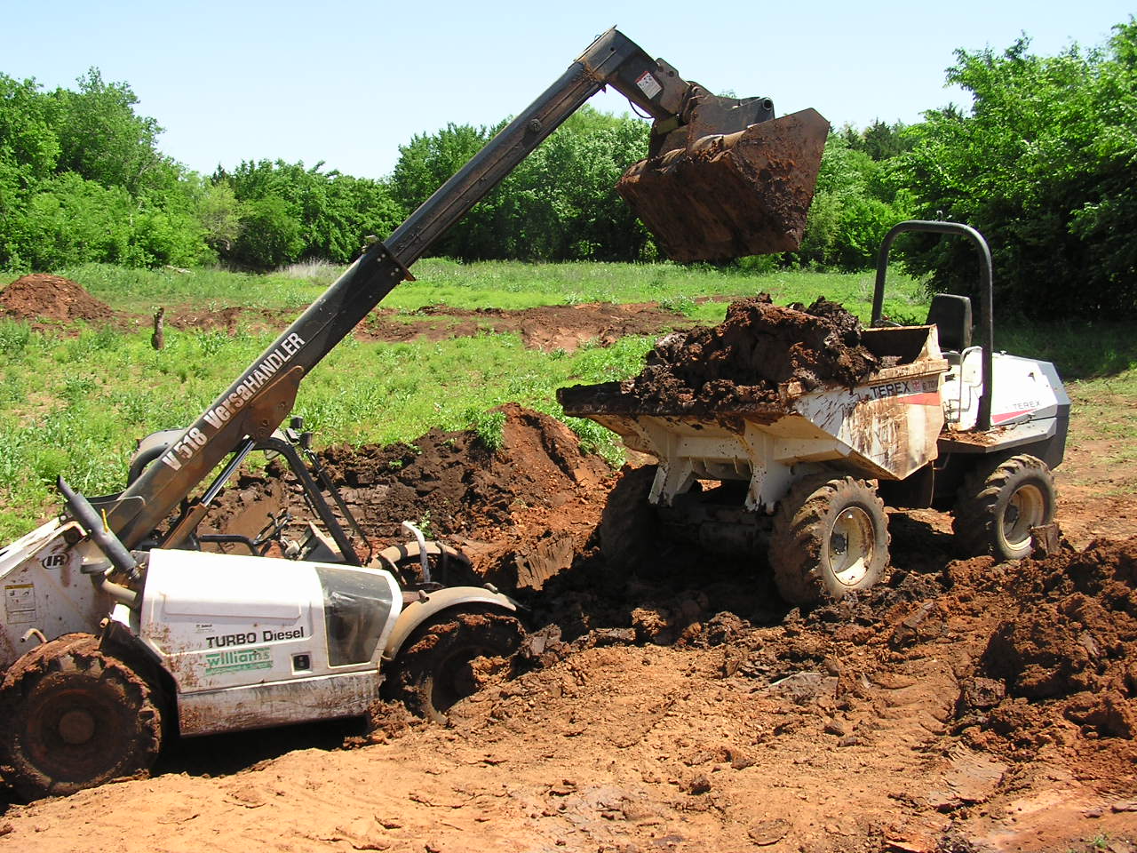

In September 2009 I bought a used V518, to clean out our 30 year old 2 acre pond. The silt was 5' deep in the middle, the plan was to dump the silt on the backside of the dam.
The silt pile.
The bucket held 1.25 cubic yards, and I soon spent more time driving than digging and dumping.
Found the dumper on eBay and it sped up things considerably!

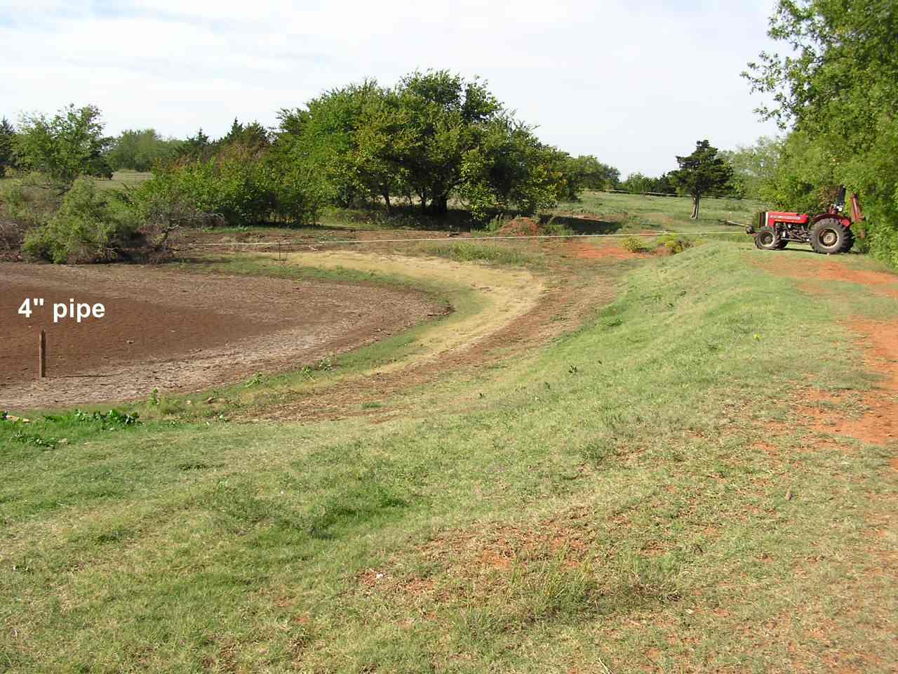

I would be interested in hearing how you kept the pond so dry while you cleaned it. Before they built the dam in 1971, they laid a 4" steel pipe in the creek, with a valve on the north end, an elbow and vertical pipe with slots cut in it at the south end.

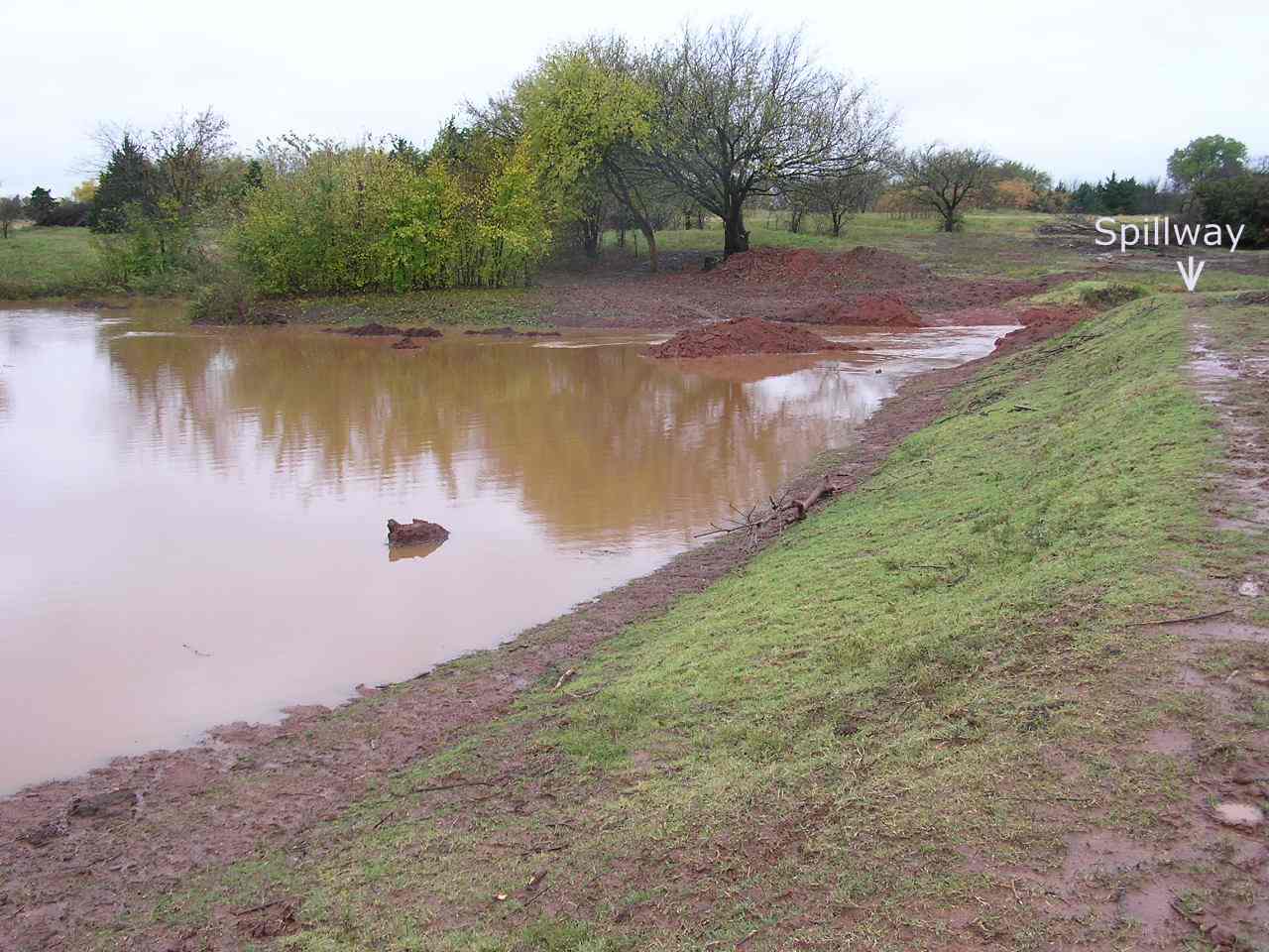

Also some pics of it after it filled again. It filled after every rain! That is why it took two years to clean it out!
Where did all the silt come from? 958 acres of farm land to the south. That seems like a bunch of silt! It took 38 years to get 5' deep.
The 4" pipe.

There was no big overflow pipe, just a spillway. A one inch rain would raise the water level two feet. You can see the higher level rushing in from the creek in the last picture.

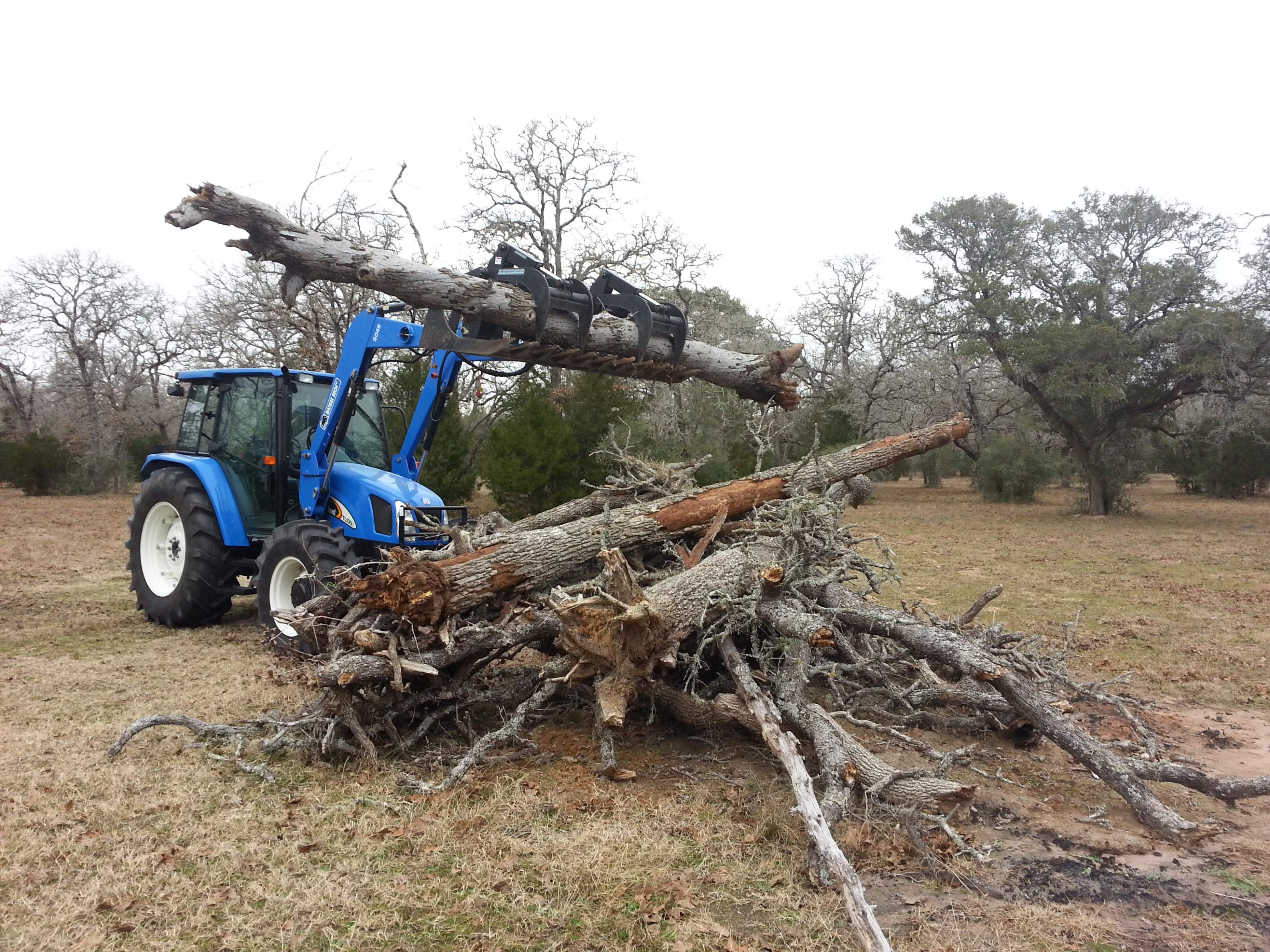

I love ripping down trees with the back hoe
love the crunch
