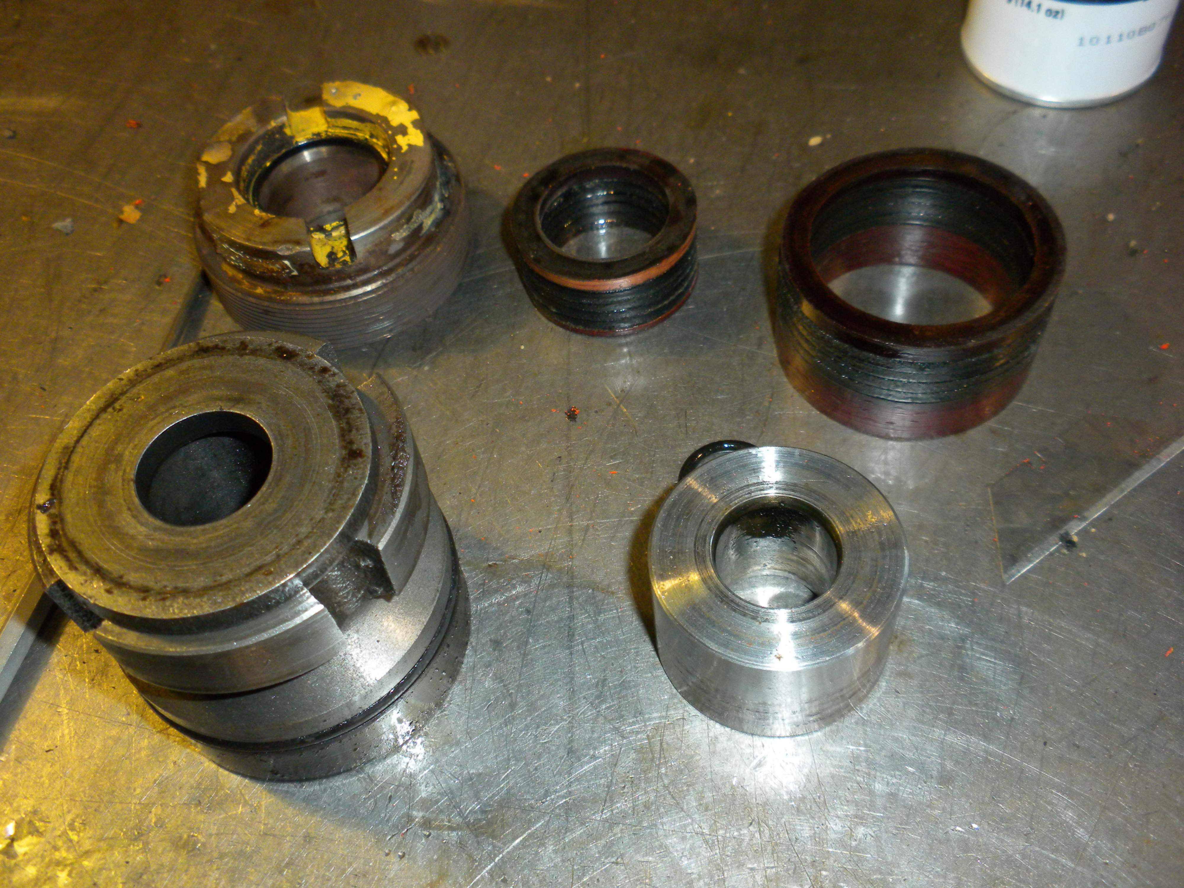

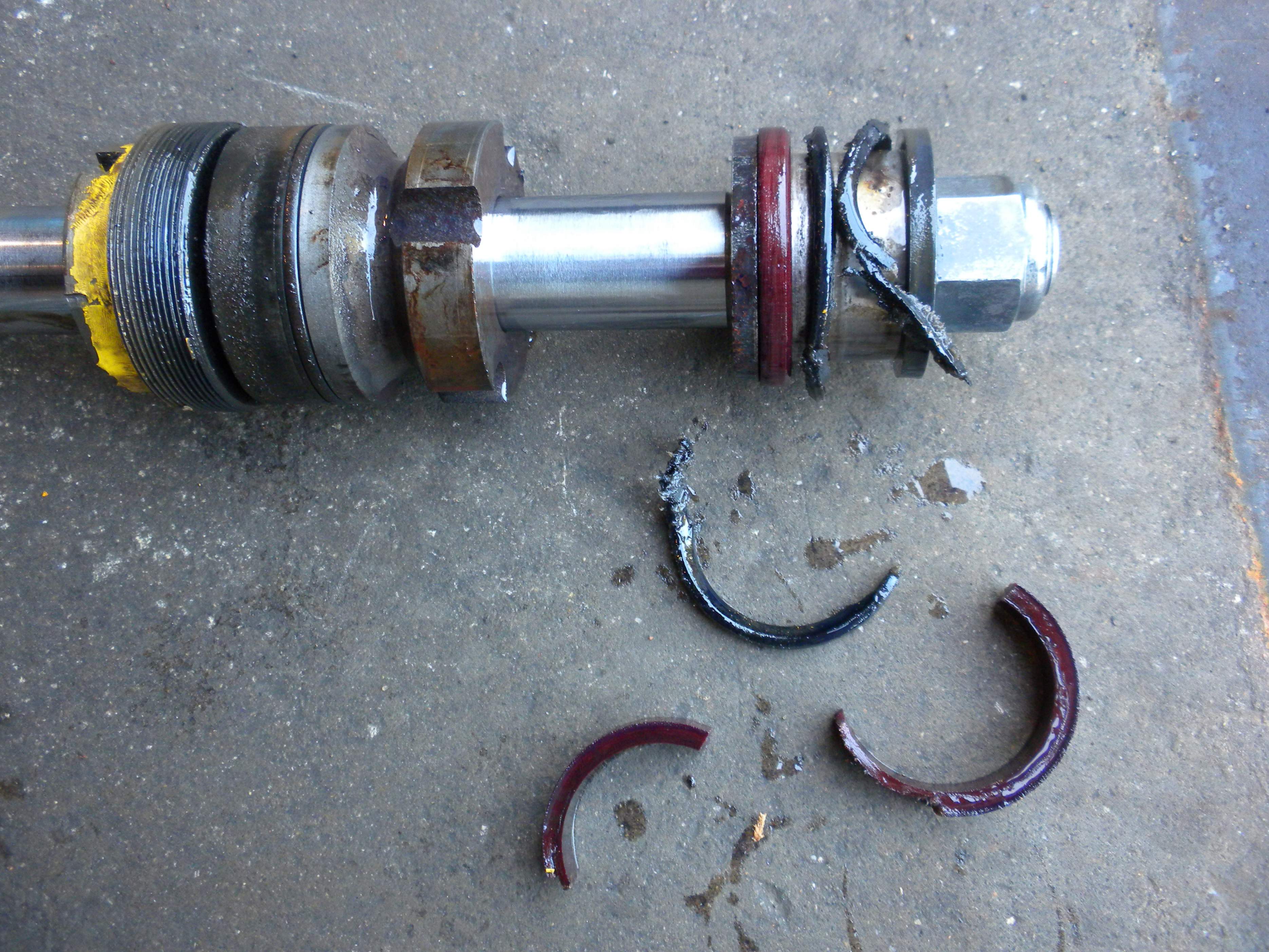

Which composition came in the cylinder? Usually, seal composition is more a factor of seal style than anything else. Post some pics of your seals so we know which style they are. Also, when you call the seal company to order, they will help you pick the best seal for your application.
/ What's the difference between...
The style is simple Vee. Stacks are 1.0 inch. I don't know what the exact composition is of the current seals. They are black with fibers in them and pretty stiff. Black with age? wear? temperature exposure? Stiff with age? Some are brown and more stiff and others less stiff. The cylinders don't have the same materials in each -- obviously rebuilt at some time. That happens with 40+ year old equipment.
Of the 3 listed materials - what are the characteristics of each? That's what I want to get educated on. (Thanks!)

They probably look like these....Ford 3500 Tilt Cyls....'72

Fordtractor,
I take it your ovh'ing Ford hyd cyls????
OEM Ford used Neofab V rings and phonelic male and female adapters......
I prefer in my repack jobs what Allegheny York calls a HI-LOP V pkg set......the male and female adapters are nylon and the vee packings are neofab/hytrel stacked alternately
http://www.alleghenyyork.com/pdf/vee/packing_sets.pdf
These stand up very well.......:thumbsup:
This is exactly what I do. The "cloth" appearing seals are great for high pressure but tend to let a cylinder creep down. So, I'll alternate a rubber one in there somewhere, depending on the height of the stack. Oh, probably isn't rubber, but I don't have my seal catalog in front of me. I use www.herculesus.com. But I also buy from Allegheny-York and have had good luck with them. Hercules makes a much more user friendly catalog.
