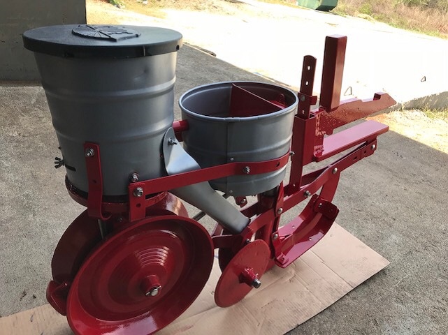

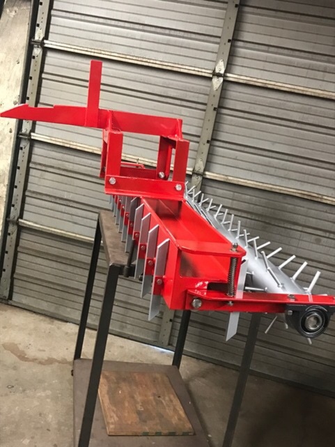

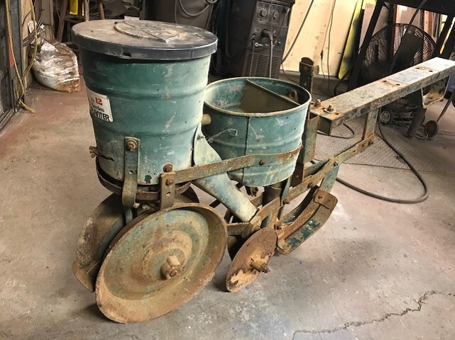

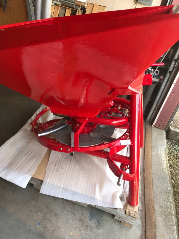

I have a friend who owns a powdercoat business and he does a lot for me, farm equipment of my own. I just ask him why powdercoat from overseas comes off in chunks and doesn't hold up. He said they don't clean the surface good or cure it long enough. He also said he knows in the Philippines they use rain water as a rinse. He has a multi rinse system and is constantly adding chemicals to do it the right way. Everything I've had done by him has held up well and that's a lot and most of it sits outside.
Here’s a few things he’s done for me.
