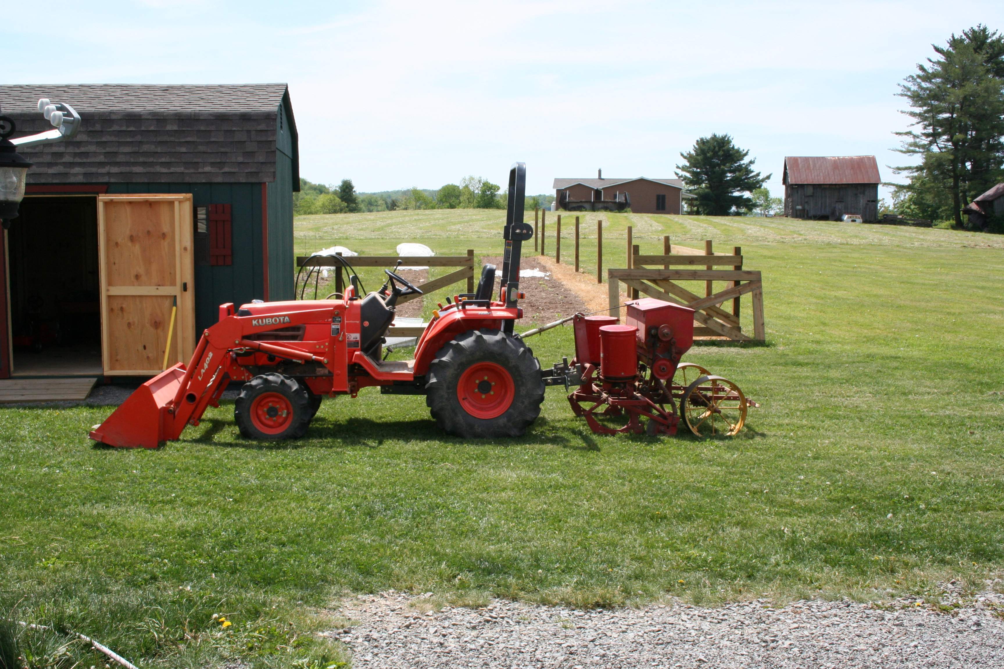

I have a two row JD 71 that is absolutely fool proof. Anybody can use and operate it and does a great job of planting corn. They are in demand but worth the money.
