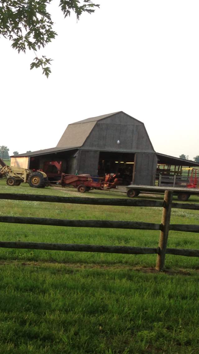

From what I found so far that the hay dogs must work, wedges in place, keep blade sharp, match ground speed to windrow. I find that older New Hollands more plentiful for sale. They will make good bales but there is a learning curve to it. A good manual is the first place to start which ever baler you pick. Pic of old iron pulling older iron. They are not pretty, but they work. 2013-07-02 21.19.44.jpg
