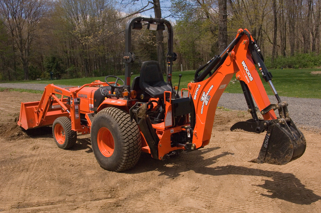

   / what's the best backhoe for b7800 #5
I would vote for the Woods BH70-X with the thumb for the B7800.
