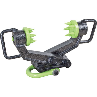

LouieJunior said:
I just looked at the brush grubber. I would think it would work better pulling straight up with the front end loader -- rather than using the 3-point hitch. I notice there is the original Brush Grubber, Brush Grubber HD and the Brush Grubber Xtreme.
I have the brush grubber x-treme and it works great. It is very heavy and has pulled out anything up to 4 inches diameter. I think it would work well for the willows even though it might take you a long time to hook it up to all of them. I wrapped a chain around the FEL and just drove backwards to pull them out. Keep the bucket low to the ground Its nice to have a helper.
I bought the brush grubber chain too and that is okay, but the x-treme is easier and doesn't slip off the brush.

I ordered a brush grubber x-treme today. I'll report on how well it works. Looks like it might be useful, on occasion, even if it proves too slow tackling my willow problem. When I get tired of pulling them out, I'll spray 'em (plan B). Thanks all for your expertise!

Report: The Brush Grubber arrived and works like a charm. I pulled out some fairly big size trees with it. The only shortcoming is this -- every tree requires I get off the tractor twice: once to attach the device to a tree after positioning the tractor, then again to remove the uprooted tree from the grubber. Be mindful that getting on or off the tractor, involves shifting into or out of neutral and engaging or releasing the park brake. Two people would have been four or five times more productive than I was today, working alone. Anybody wish to help next weekend?
