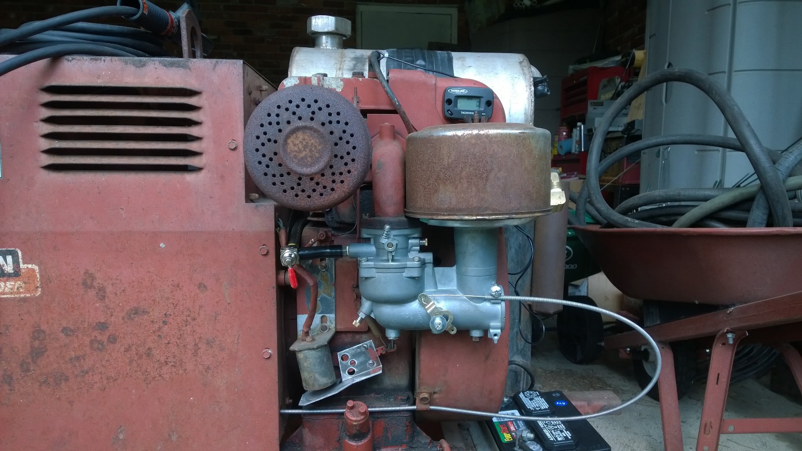

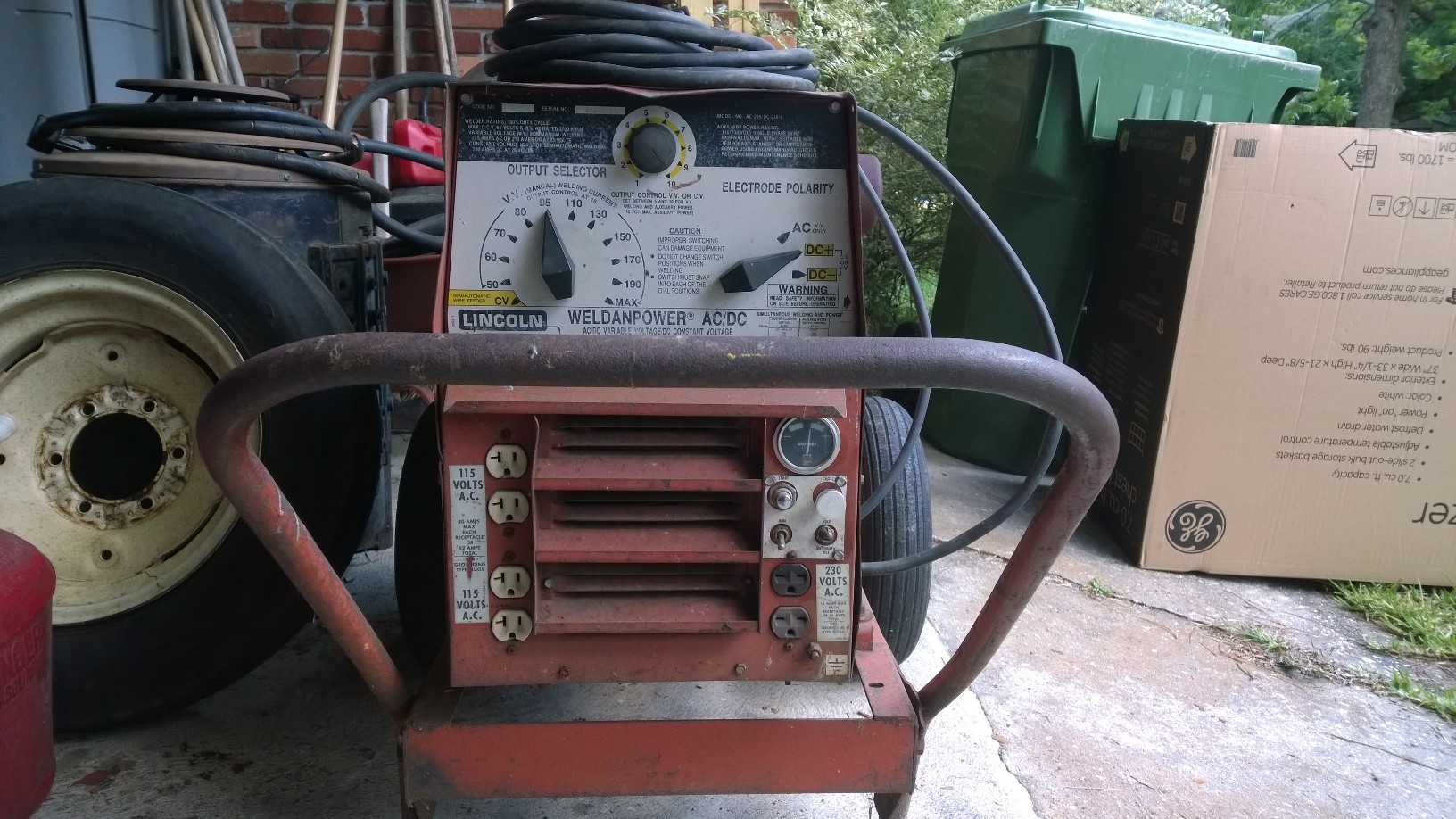

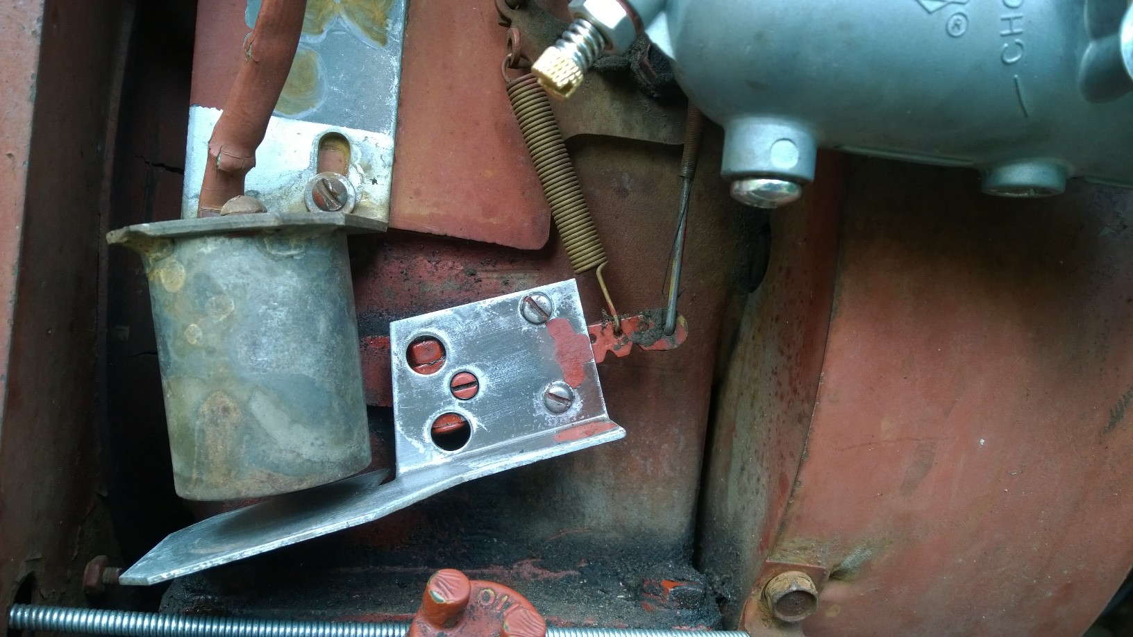

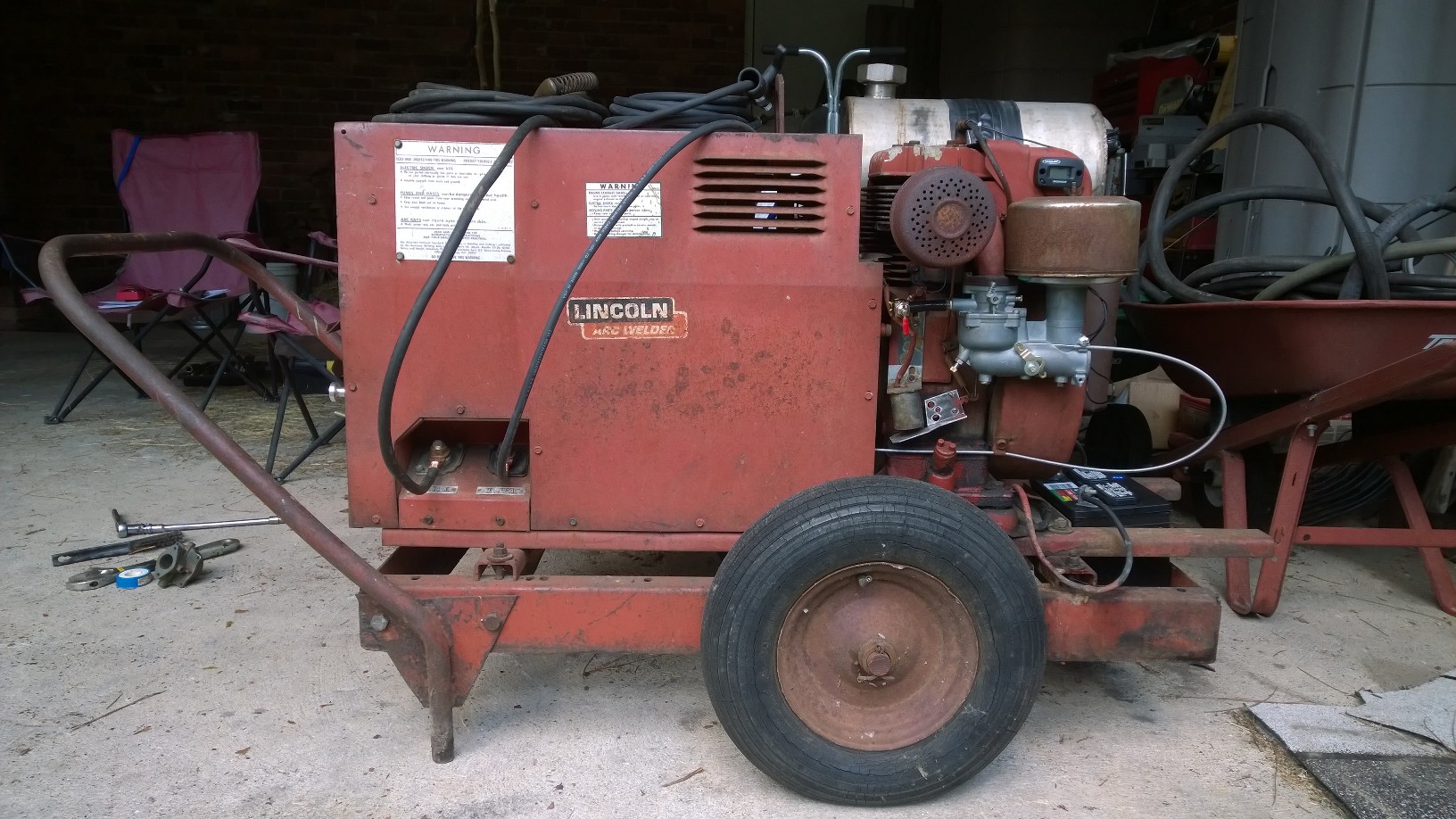

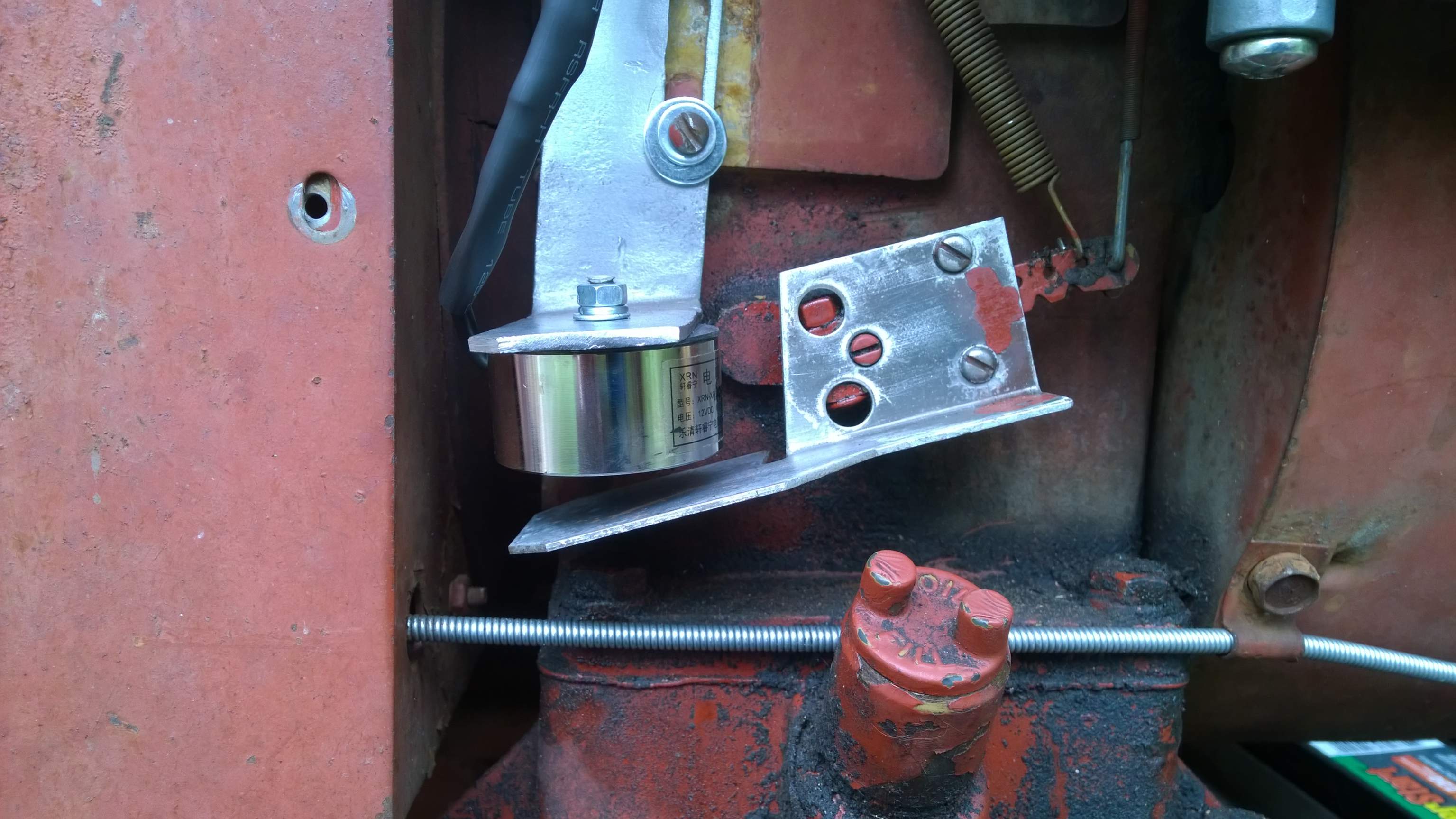

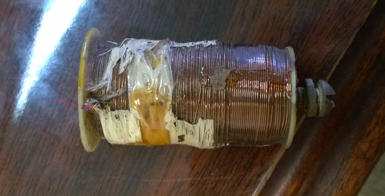

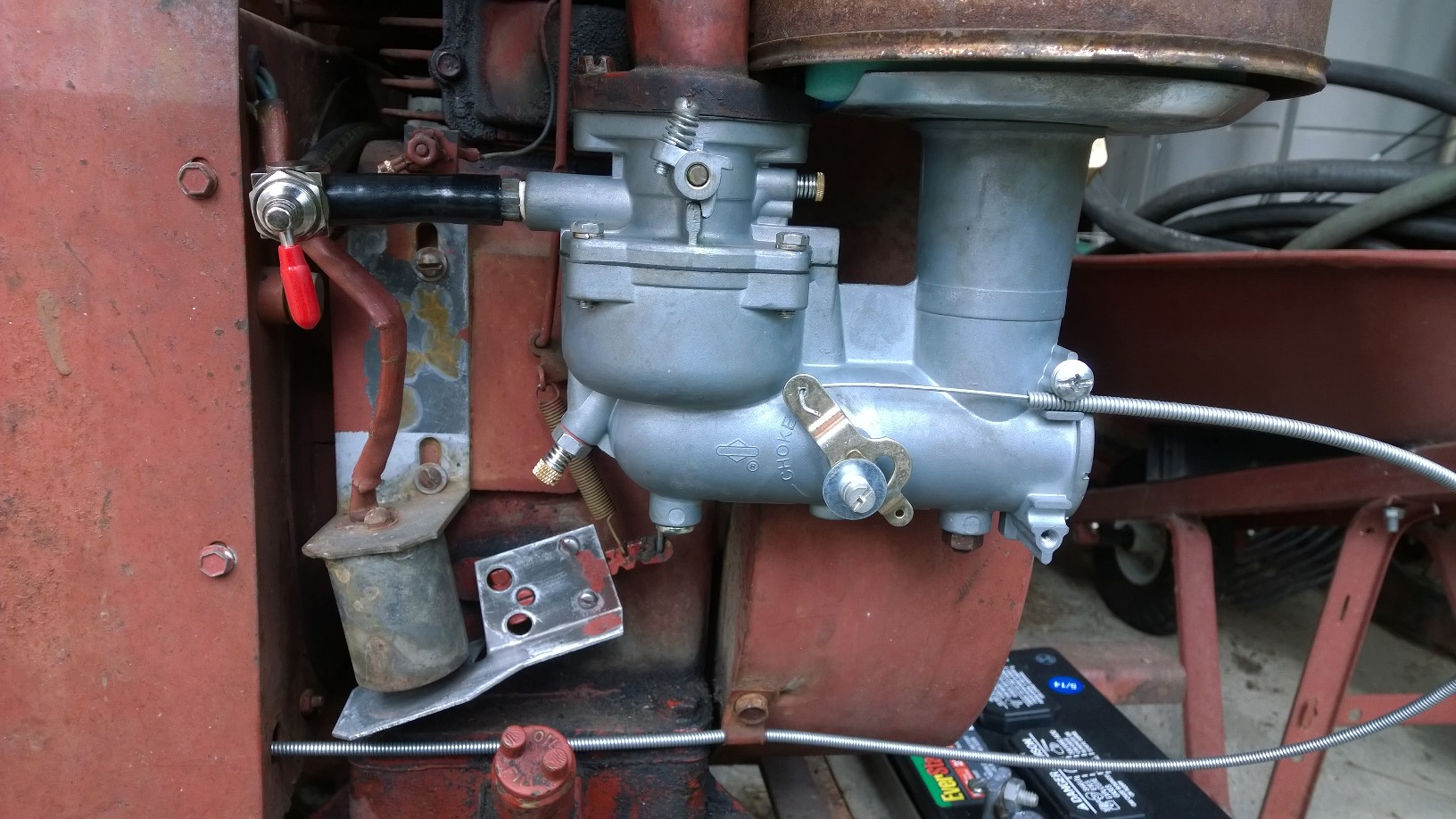

It's all working now. I found an electromagnet of close to the same specs and mocked up a new idler bracket. Auto-idler works and I've got the high-idle set to 3600rpm.. Front receptacles putting out 117volts. <img src="http://www.tractorbynet.com/forums/files/welding/383515-whats-worth-thread-wp_20140719_16_04_54_pro-jpg"/><img src="http://www.tractorbynet.com/forums/files/welding/383516-whats-worth-thread-wp_20140719_16_05_07_pro-jpg"/>
That is just too smart! :). Good thinking.
