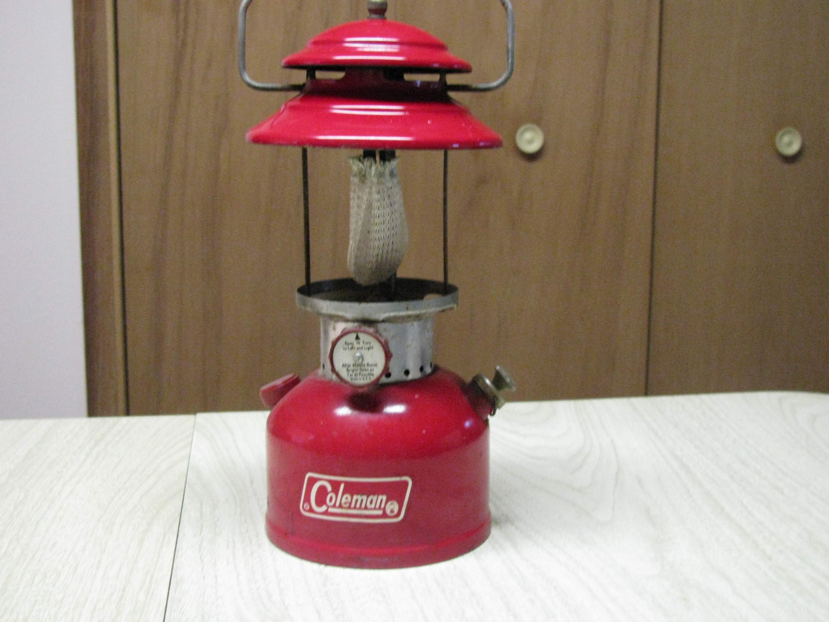

Does it look like this one. This is a model 200A. Also has 6-71 on the bottom of the tank. I can see a brass tube sticking down to the bottom of the tank. Havn't used this in years sense we got a camper and a generator for home.
Dan
