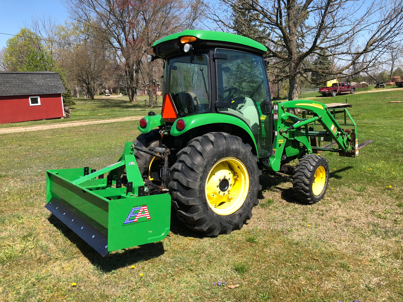

I have put in miles of trails using nothing more than a chainsaw, machete and a pair of hiking boots. Big trees I go around, small trees I cut down just below ground level. It’s easy and quick to cut with a machete and toss to the side of the trail, it goes really fast. Toss sticks as I walk.
My trails are usually big enough to drive a truck down. I haven’t made any trails to take a tractor down, I don’t plan to take my tractor in the woods, if I did I would prob clear it first then grade it with my box blade.
As far as a garden goes, I have always borrowed a walk behind tiller, it something I only use once a year and I haven’t been able to justify a 3pt tiller yet.
A big garden I could maybe justify it, but I like to play sometimes so I would prob do it old school with 2-3 bottom plough and disk, if I went that far I would get a 3pt planter and cultivator, I’m not a fan of chemical baths for weed control around gardens. But my tractor isn’t really suited for gardening and cultivating unless my rows were 36in apart, so I would prob buy a farmall cub for cultivating.
As Seabee said, many ways to do things.

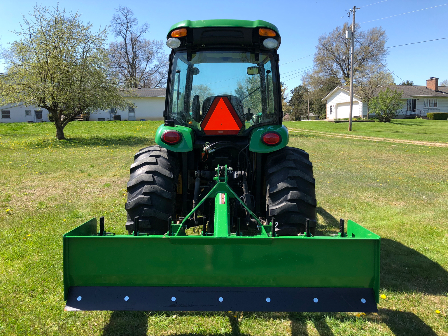

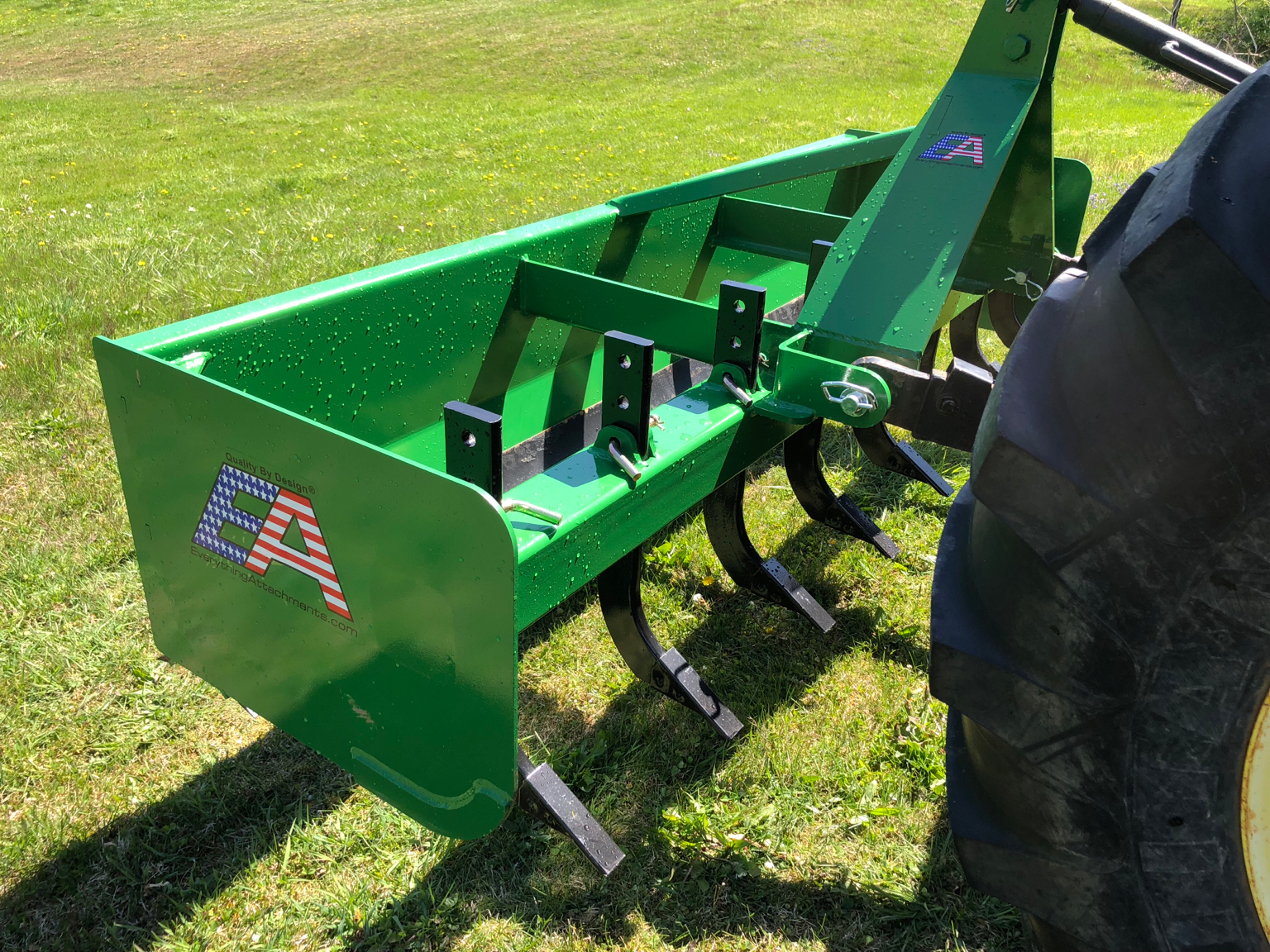

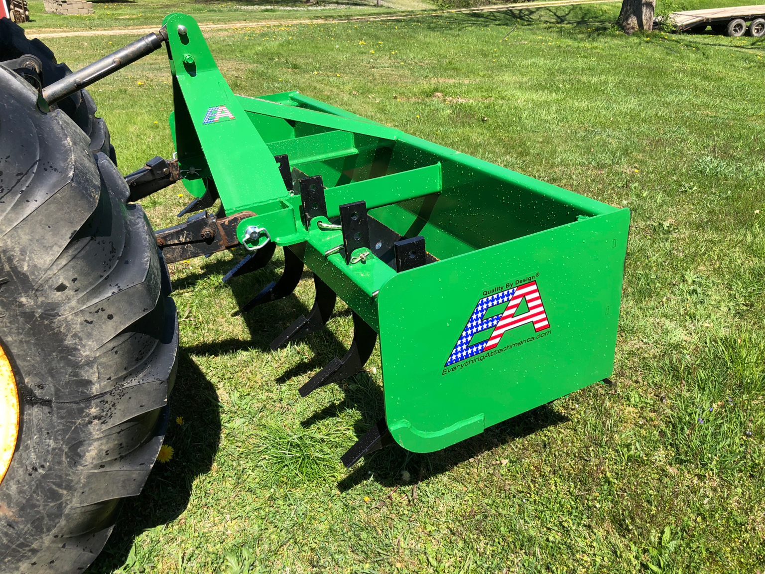

I own a tractor with FEL, I have a bucket and a set of forks, I picked up a used rear blade, only recently I bought a box blade because I wanted to do serious driveway work and didn’t want to act like my FEL was a bull dozer, so I bought a attachment made for that kind of abuse.
After a lot of research I bought an American made product, I’m still happy with my choice. Used BBs in my area were $400-$800 for one the size I needed, so I figured if the market was that strong on them, I’ll just buy new.
Edit: BB is a 78in from Everything Attachments

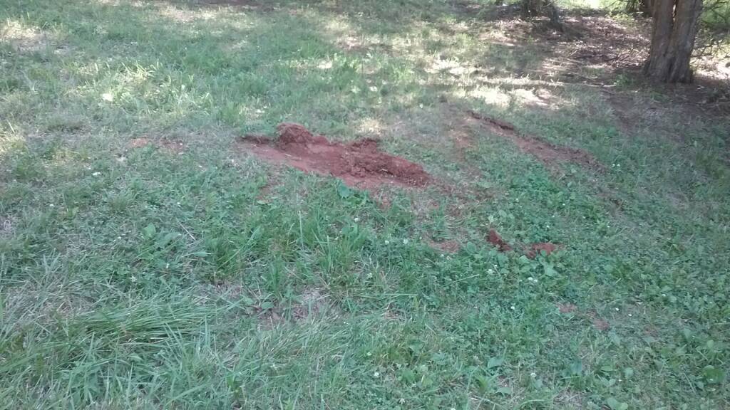

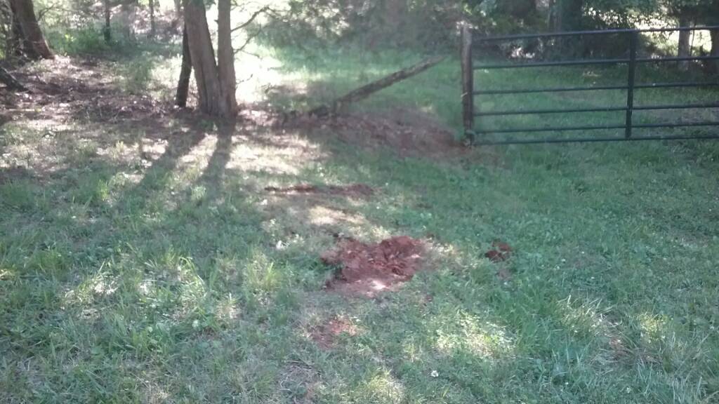

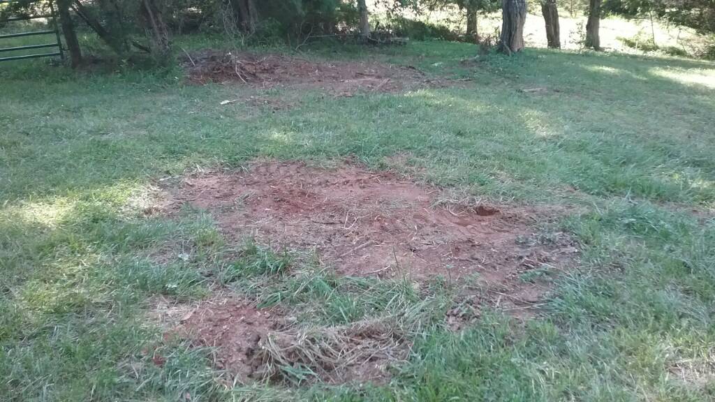

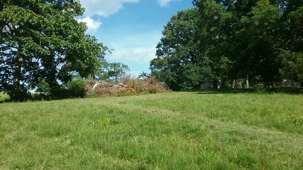

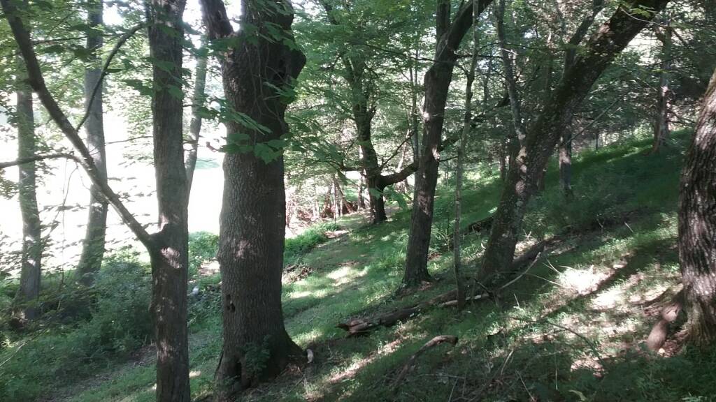

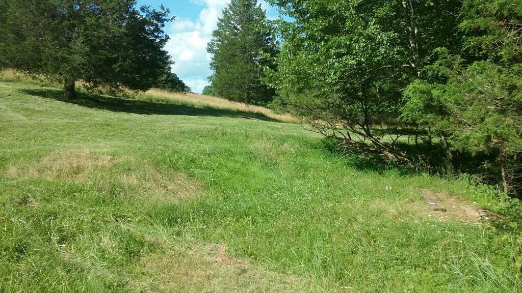

That's what I'm leaning toward is a box blade. Today I've been bush hogging a couple pastures.
Pictures show areas where Bush hog scalped the ground, I had it set at 4".

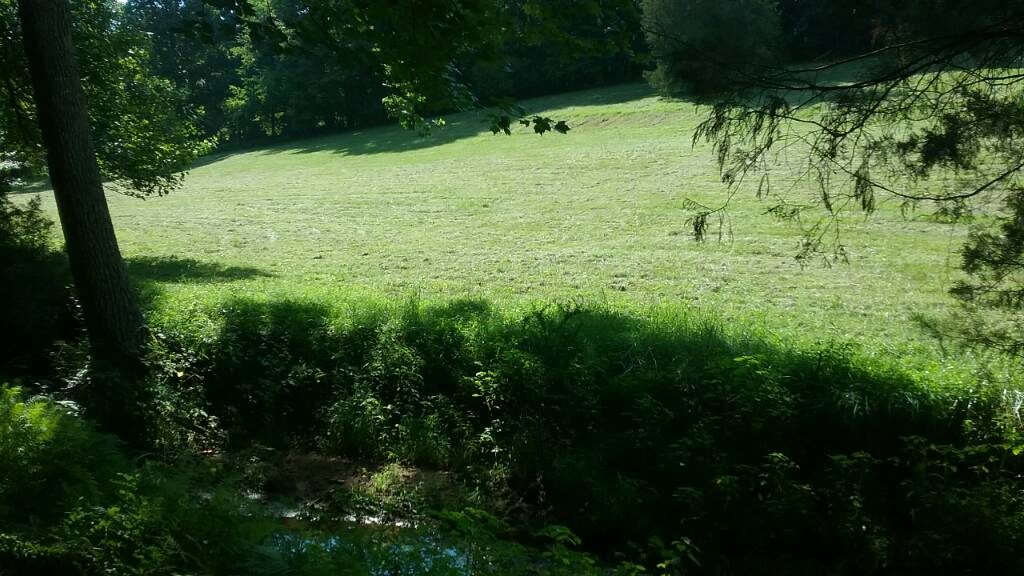

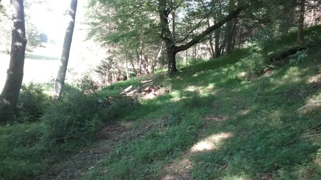

I believe a box blade (owners will know the answer) will fix those areas, probably not a big deal. The big project is the road through woods. I held my camera level and you can see how steep it is. I'd like it to be level as possible and 6-8 ft. wide is ok.
One spot near creek I'd like to have a small garden. 20x50 or so.

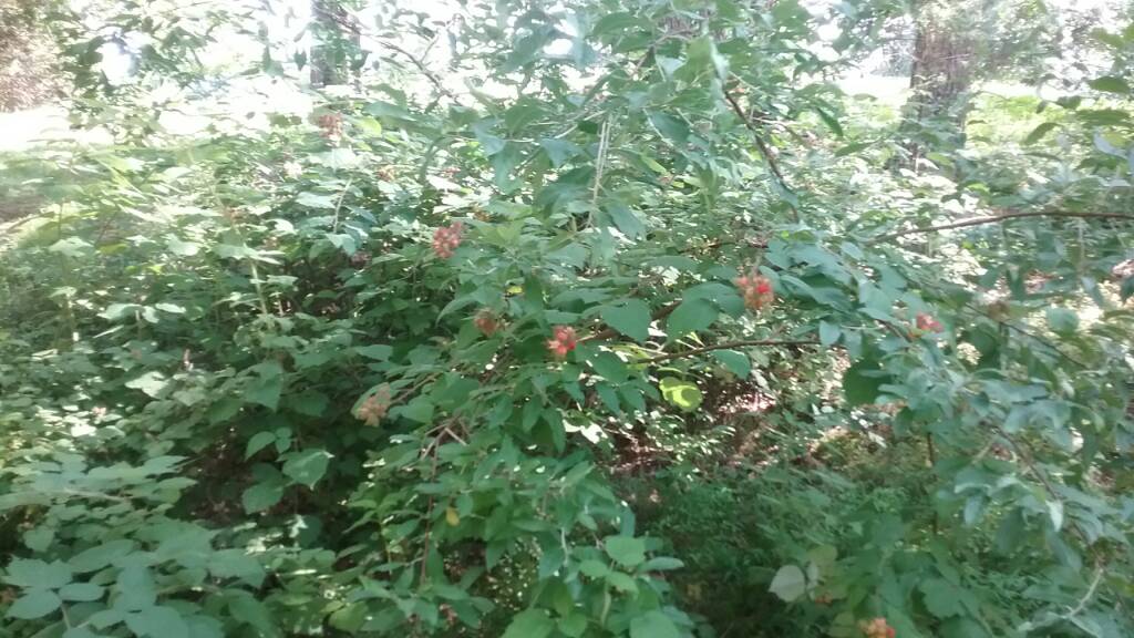

I have another small tractor and trailer I'd like to be able to go through woods for clean up. Lots of areas I want to keep natural, like the raspberry patch I discovered.
Hills are ok and no problem with 4x4. I take them straight up or down no problem, even if it has like some areas that go down, out, then down again like a step. What I need to fix are the hilly ones with dips where it's easy to flip.20180628_165633.jpeg20180628_165648.jpeg20180628_171029.jpeg20180628_170357.jpeg20180628_170018.jpeg20180628_165932.jpeg20180628_165902.jpeg20180628_165726.jpeg20180628_170208.jpeg

For leveling and filling and moving dirt around short distances then you need a box blade. Works great on drive and road maintence also. A bit wider than your rear tires, with teeth / rippers that you can move up and down. Buy as heavy as you can afford. In fact I will say buy heavier than you can afford. Very likely one of the first things your going to wish for is that it was heavier. The weight makes it dig better, operate better and less likely to tear up. Now its not required but hydraulic cylinders on the side of the three point is really nice and the same for the top arm of the three point. More money but sure makes the box blade easier to use. It’s hard to stress just how much difference the top and tilt features make.
Tiller is fine for garden work. Not a lot else. In dirt thats relative rock and root free it could loosen up soil that would allow your front end loader to then move easier for leveling up the place. Such a combination would be way slower than a box blade but it would work.
Landscape rake would be handy for fine tuning and leveling up loose soil and gravel and for removing roots and rocks. Not much else so would be last of the three for me to purchase.
