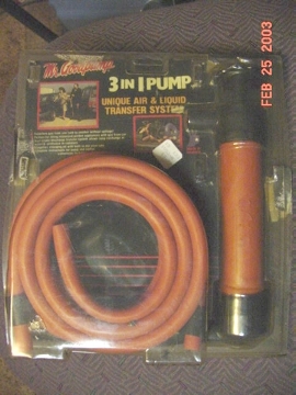

Has anyone tried using one of these? (see attachment) I used it to change the oil in my inboard boat. When I had one. :(

I swear I feel an invention coming on, except it has to already be available. What I'm thinking of would look like a grease gun, but would have a tube out the bottom you could stick in any bottle or bucket, and a tube out the top to put where you want the stuff to go. Heck, a simple pump-type soap dispenser would operate with the same principle. Surely there's something like that available? It sure would have made filling my transmission a lot easier. I could only squeeze about 3/4 of the chalk bottle into the very inconveniently placed hole in the transmission before I had to add more fluid.

Harbor frieght has several types similar to what you described. They have a bucket type pump, couple different siphon types, barrel pumps, drill attachment etc.. The drill pump listed says water only. I have seen what appears to be the same drill pump elsewhere with adapters for smaller hose. That one states water and oil up to 30wt.
