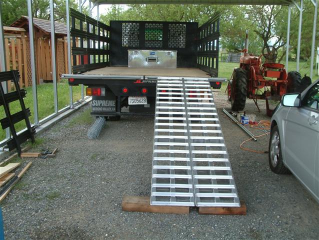

Yes this is how the ramps were connected to the trailer i got them off from,
I've been working on installing them today I have the old bars removed and the new bar installed all the way across with the ramps on the bar and supported in the middle, although is Tack welded on for now so that I might see how they lift and slide from side to side, so far so good and they can slide within 6" of each other giving close enough if ever need to roll hand trucks up them:thumbsup:
I'll more than likely weld them up so they cannot be removed, I'm sure I will regret it later when need to haul something longer and needing to remove the ramps:cool: maybe if ever need be I could simply let it stick out between the 2 ramps;)

Interesting how aluminum can be strong enough to hold this amount of weight, although is it 5000 lbs per Ramp what it means? Not sure I quite understand the suggestion of axle weight has to do with the ramps:confused:
It's 5000 lb per axle, not per ramp, and 8500 lb max with the vehicle completely on the ramps. Most two-axle vehicles have more weight on one axle than on the other.
Here's how these ramps are rated
"Rated at 5,000 lbs per axle. How Do I Determine Axle Capacity?
The best way to determine your vehicles axle weight is to drive the heaviest axle on a scale. Normally the front of your car, SUV, or pick-up truck is the heaviest axle weight because of the engine. Not recommended for forklifts, steel track vehicles or skid loaders weighing more than 5,000 lbs."

Could you make a cat eye bracket to hold the bar and put cotter keys in both end of the bar so you could slide the bar out if you ever wanted/needed to!:)
So basically the weight capacity for these ramps would be 4250 lbs. each max.... this is still quite impressive for aluminum,;)

Back to the ramp question; I recently bought an old car hauler and put a set of ramps on the back that fold up. Because some of the cars my sons have and work on have ground effects I did not want to put braces under the ramps. I can back into a ditch and the ramps are nealy level when down. I also wanted to be able to slide them close enough to load my lawn tractor if I wanted.
My trailer is not here so I can't take any pictures, but here is what I did.
I used a piece of 1" round rod for the rod on the trailer and welded pipe with slightly over 1" ID on the ends of my ramps.
I attached the round rod on top of the steel on the back of the trailer with a 2" long weld on each end and about 4" in the center. I left about 1/4" clearance between the rod and the top of the steel. The pipe on the end of the ramps is about 1/8" wall thickness so when nothing is on it the pipe barely clears the top of the trailer steel. I can slide the ramps easily from all the way out to just a few inched apart.
When I drive up on the ramps with a heavy load the 1" round stock flexes enough that the pipes on the ramps are resting on the steel of the trailer.
So far I have loaded my ck 20 a few times, my lawn tractor and a 1/2 ton Dodge quad cab truck. They are still working great. If anyone is interested I can take pics tomorrow.
