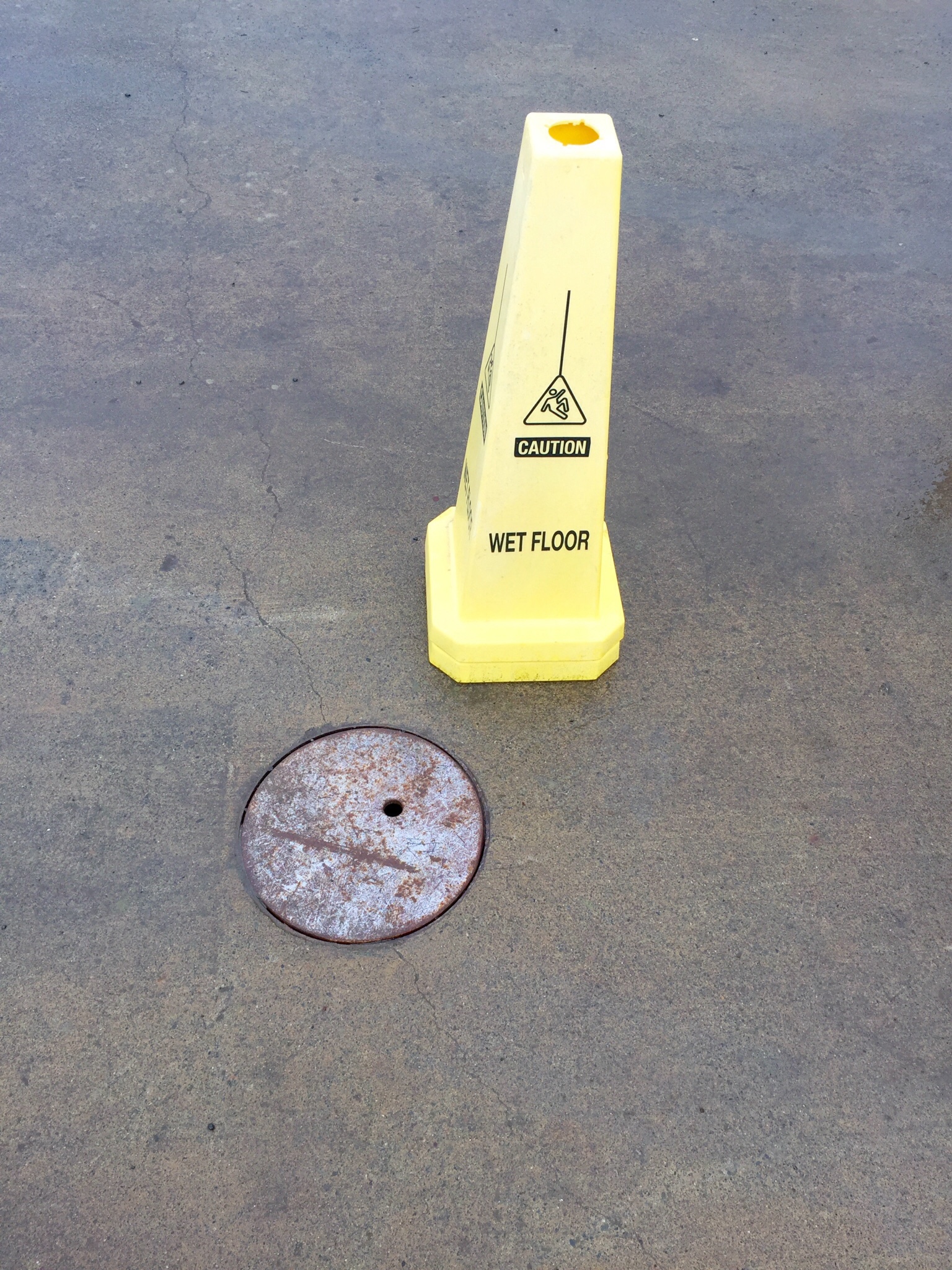

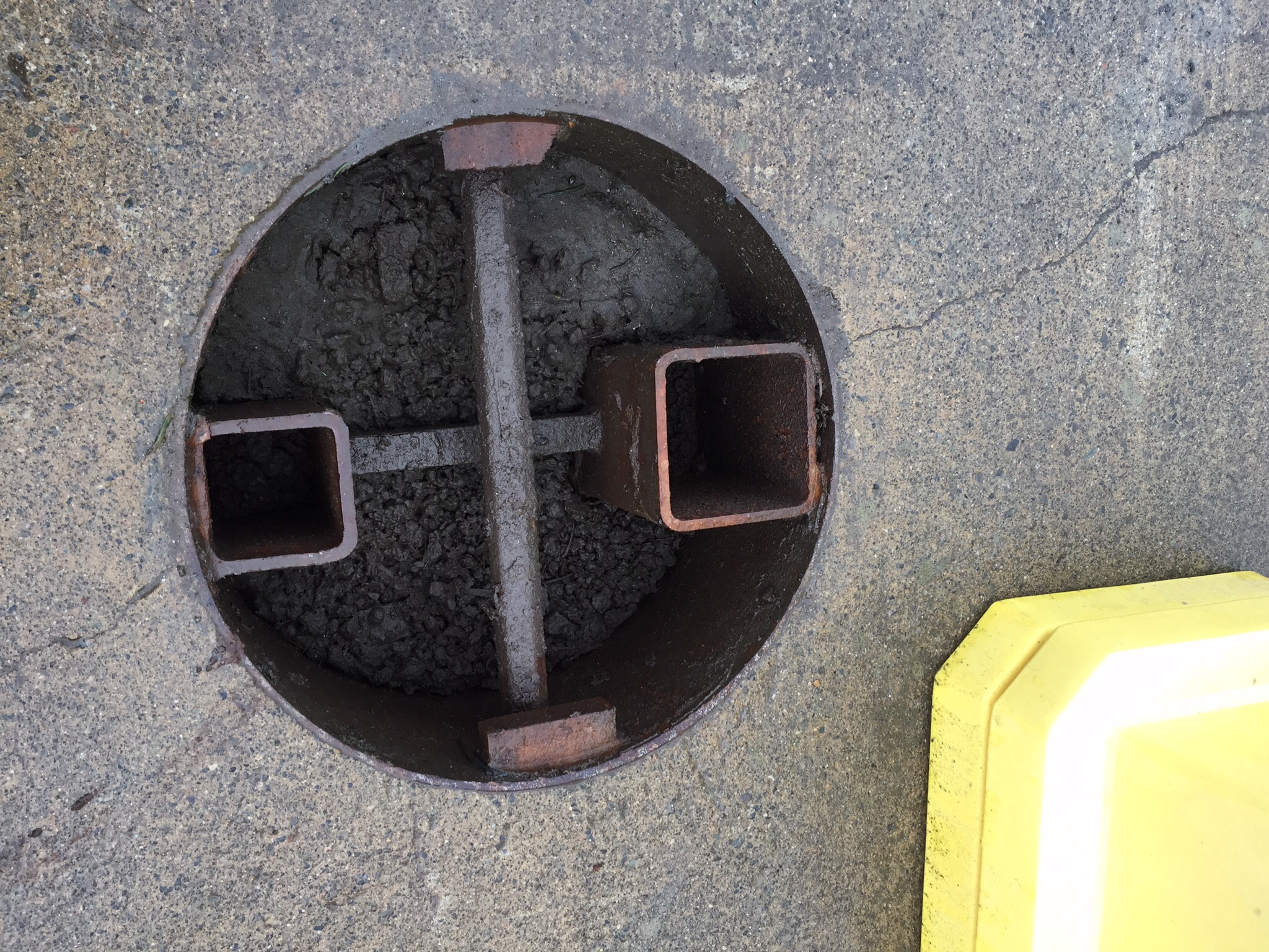

When pouring the floor on my first shop years ago I set four of these "anchor points" inside and one outside on the pad in front of the main door.
They're invaluable for anchoring come alongs,portapowers or??? The two different sizes vertical receivers are for for attaching bending jigs or portable vice/grinder stands.

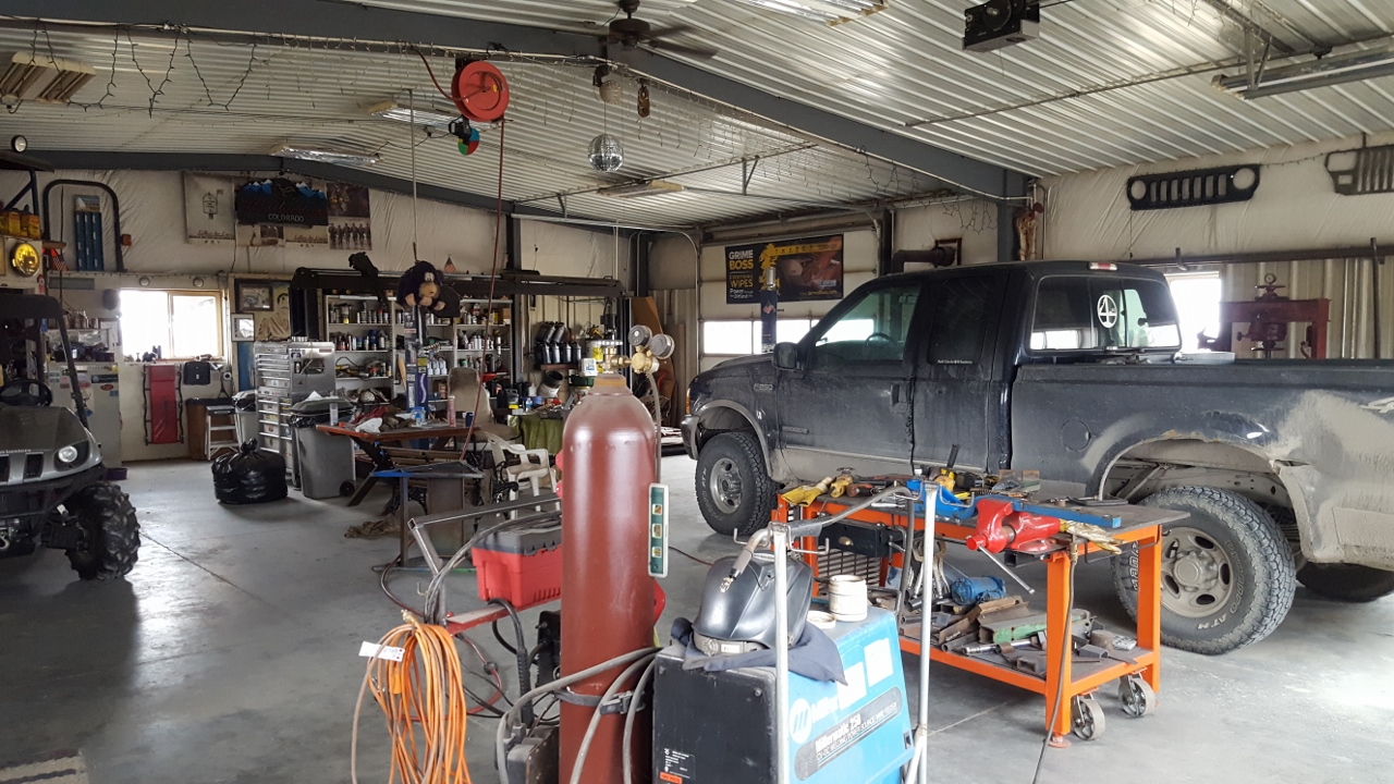

Here's a pic I just took at 11:30 a.m. on a very cloudy Missouri day with lights off.
