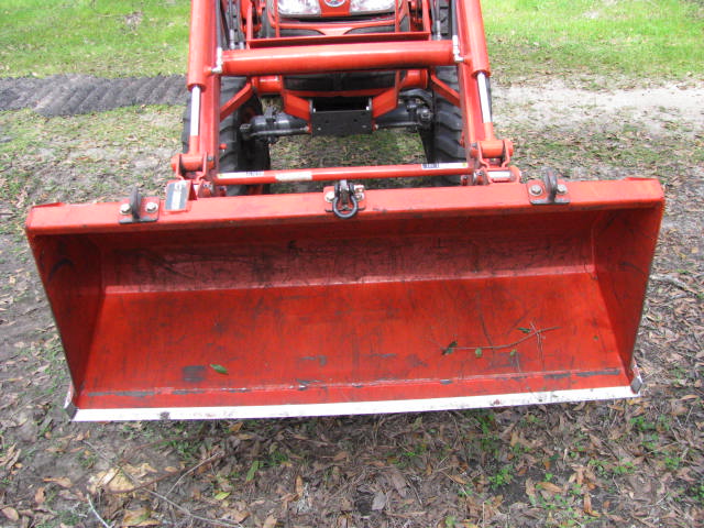

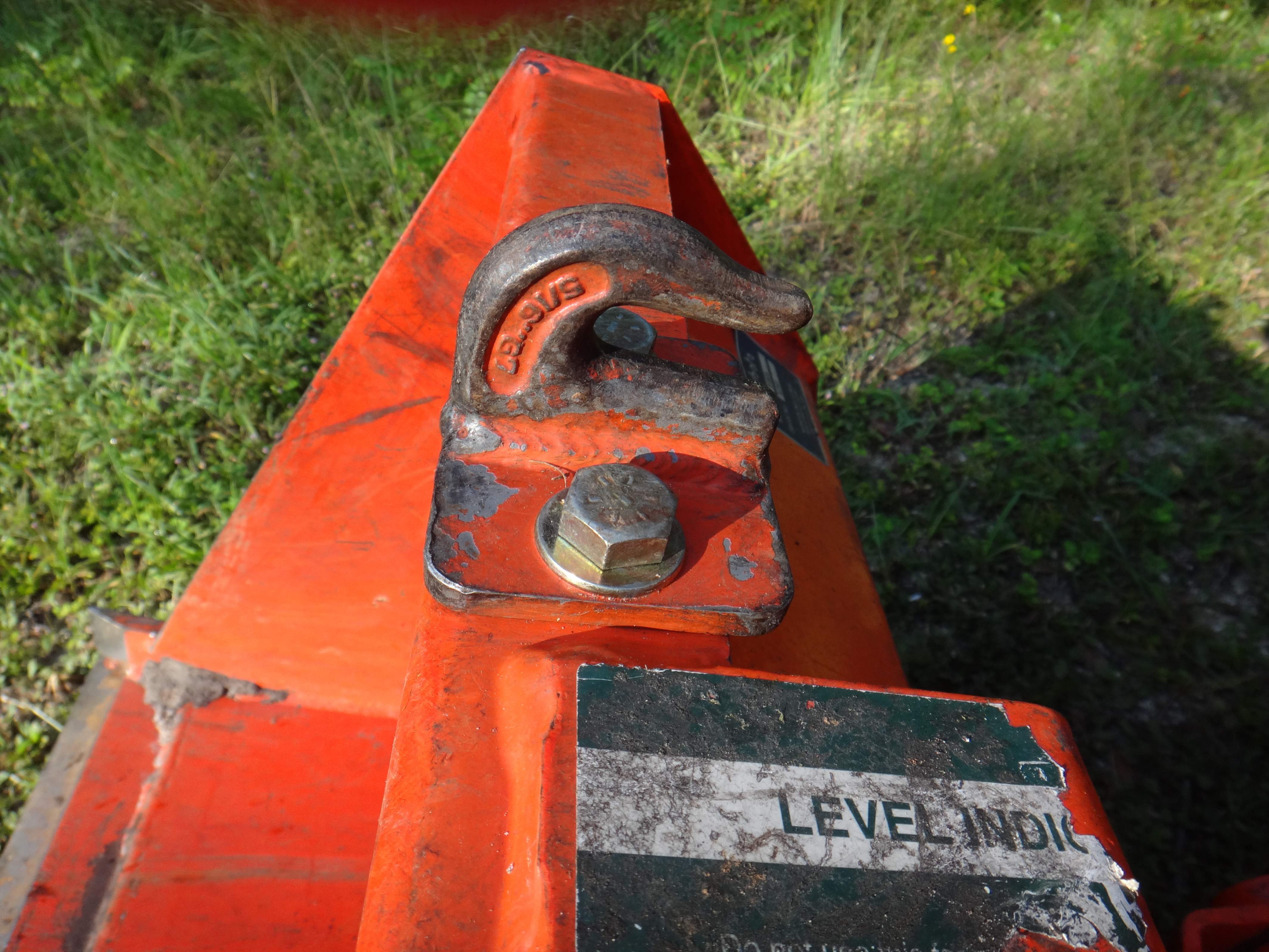

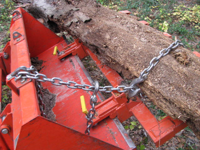

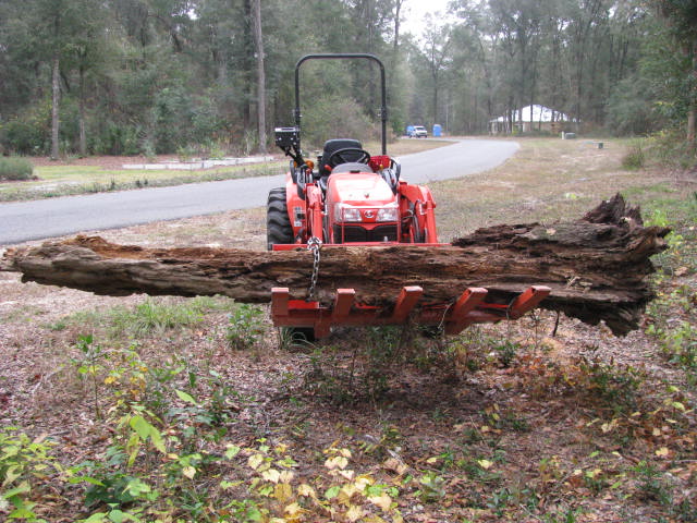

You will want 5/16" chain grab hooks for your bucket.
Ken is a specialty vender in the category. Great product.
Ken's Bolt on Grab Hooks <<Home>>
Lowe's and Home Depot have the lowest price on Grade 70 5/16" X 20' "Towing" chain with attached grab hooks on each end. Have the store cut into 8' + 12' lengths in the store. Nearly impossible to cut at home.
Buy two Grade 70 SLIP HOOKS for the new ends.
You will use the 8' length far more than the 12' length.

I agree with Redneck I/T, the backhoe is probably cheaper with initial purchase and the tractor will be set up for it by the dealer. I am amazed at how often I use the b/h - I really didn't think that would be the case, I figured the loader was the one that would be used most. I thought about the rent a b/h when I needed one option but my impatient side doesn't like to wait until the rental place opens up and I always need it when you can't rent one anyway. At $125 per day to rent it doesn't take long to pay for the b/h. Another plus is that I have about 800 pounds on the rear wheels for traction (my tractor is a T273 - a b/h for the 433 would likely weigh more).
Besides your already made list, another handy add-on is a 2" receiver that attaches to the bucket (and removes easily) for moving my trailers around along with some other duties it has been 'adapted' for. My last suggestion - if you don't have a welder get one.
