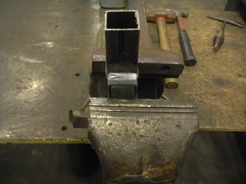

I'd get a Mig welder. Childs play to run.
