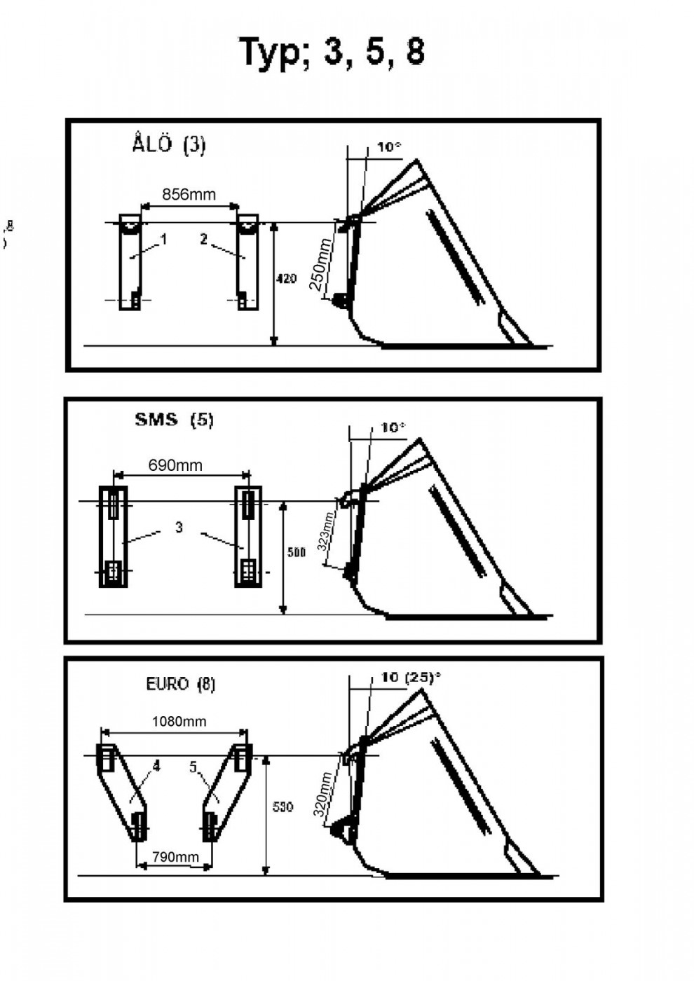

Looks very similar to the Euro style QA.

It does but the lower pin boss’s are the same distance apart as the top hooks. I thought standard euro was sit inward?

There are some varieties inside the Euro style though.
Here is a couple of them:
   / What type of QA is this
I measured mine it’s 50” center to center which would be like 1270 mm so it doesn’t appear to match any of those dimensions. Unless I’m not reading that correctly

Maybe a custom application of some sort? I don't know. When I built my loader, I tried to go with the Euro dimensions but then changed at the end, because it would be just too high. I still maintained the width though.
Is that a loader for a tractor? Have you tried going by the brand name?

Yes that does. Further research it appears the loader is a Frey. I am seeing mention of the Frey style QA so maybe I’m on the right path
So the best I can figure is it is a Branson QA however on worksaver website the measurements between top pin and bottom pin do not go with mine. I’m roughly 9” from center to center but it looks exactly like the Branson
