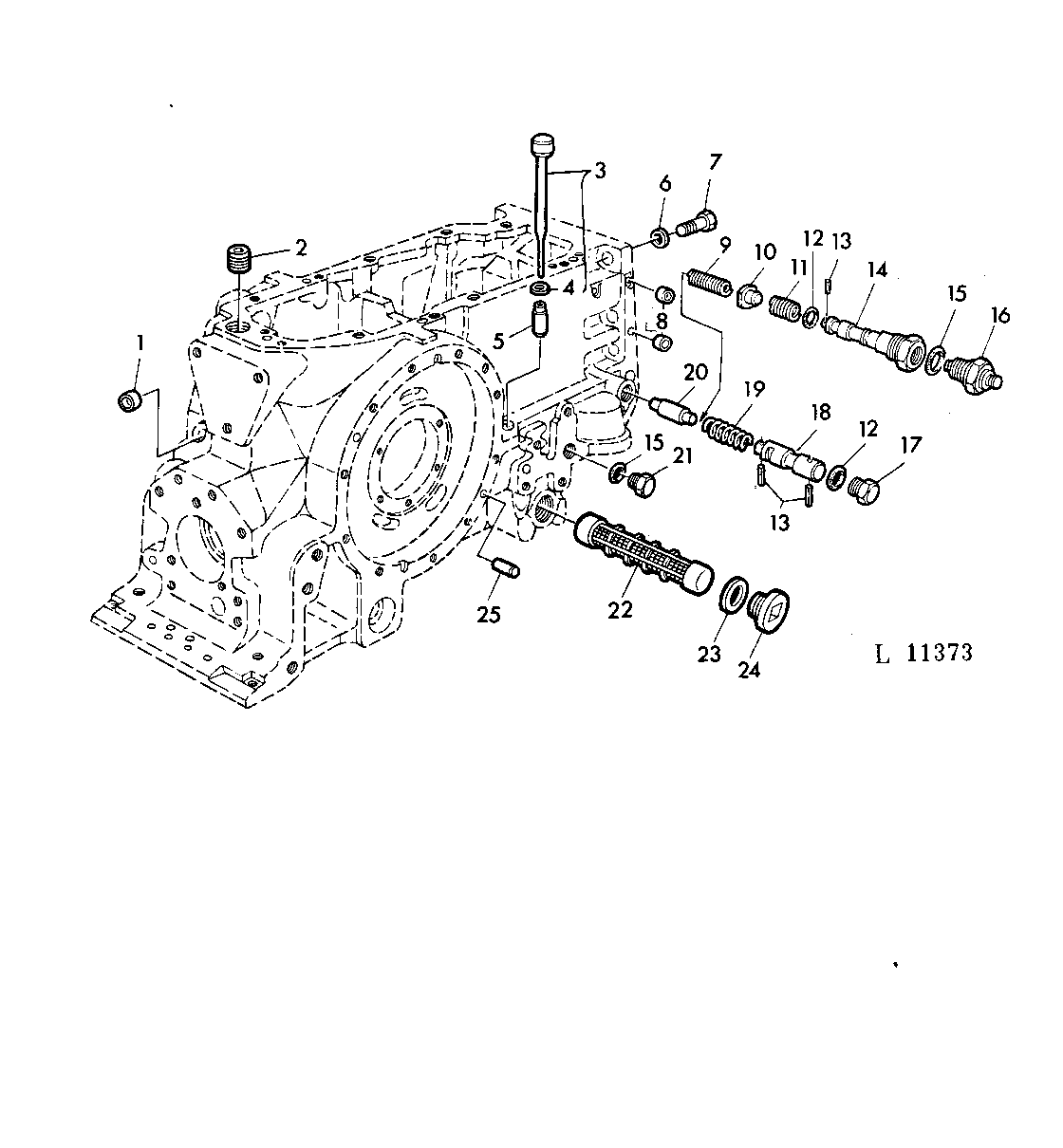

I have a JD 1120 and have been putting regular hydraulic oil in it, I just received the owners manual and it states to use transmision hydraulic oil. Can the two be mixed or should I dump the oil in it and replace it with the transmisiom hudraulic. Also could I have caused damage to the trany using reguler hydraulic oil.

What brand and viscosity of regular hydraulic oil?
Transmission hydraulic oil is kinda vague, exactly what does the manual say to use?
Not likely to have done any damage.
   / what type of hydraulic Oil #3
You need hyd oil that is recommended for wet disc brakes. If you use just plain hyd oil the brake pads can deteriorate. Also water in the oil can cause brake pad deterioration. Correct oil is JD Hy-Gard or its equivalent. If you drain hyd oil which I recommend it would be a very good time to check trans sump screen(parts key #22).

Thanks guys, I finaly drained it al out and got some JD compatible hydraulic oil, hopefuly there is no damage.
