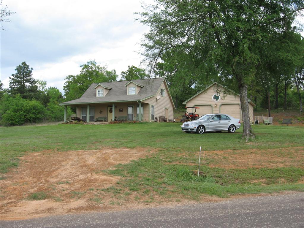

Like Dan said you can get hardi in 4x8 sheets or horzonal boards. I like the hardi because it is simple to put up, just like wood, and you can change the color if you want with paint. With vinyl around here the old wood stays up and the foam board they call insulation is just to smooth out the area, not much real insulations. So if you get termites htey still can eat up the old boards.
I put up a whole bunch of hardi on the weekend place. it's been up 6 years now and only the south side of the house that gets funn sun all day is starting to show some age. But as mentioned it does take paint very well.
Good Luck,
Rob
BTW, not my car, just a rental. :D With the help of an Enterprise Manager, I've learned how to work the system because I rent a car every week to work out of state.

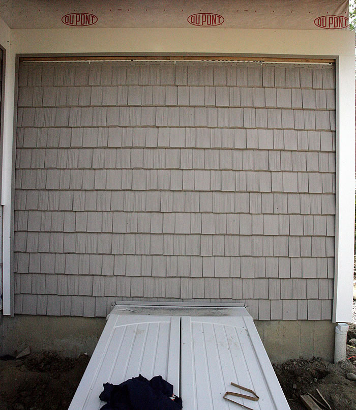

i just built a house in upstate new york -- really tough weather -- and there is no wood on the exterior --
-- that said, it looks like wood in a lot of places --- :D
here's the siding -- hand-split cedar shakes -- vinyl -- :D

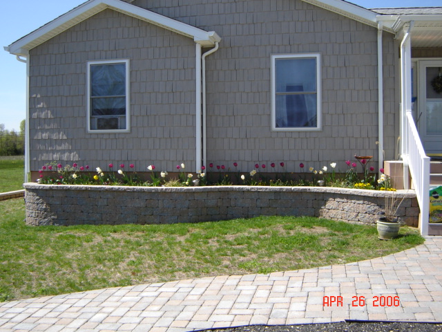

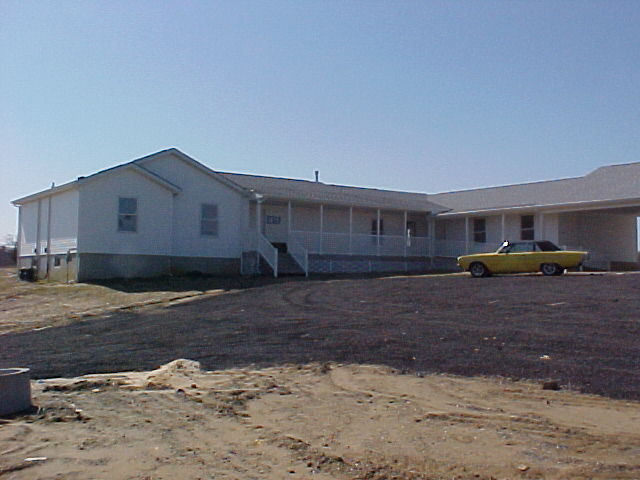

Eric, we did the front of our house with the same stuff (see 1st attached). Much better look that what it started with (2nd attached). VERY good look, but it is more expensive than the regular horizontal style vinyl. Probably a good look for Sig's place (at least IMHO better than horizontal).
Having installed a little vinyl (my old boss & myself sided his little 1000 sq/ft ranch style) I can say it's not hard to do, once you get the feel of it & learn the basics.

yup -- i think the stuff is the BOMB -- it even feels nice and heavy, like shingles, when you lean up on it -- :D
i used the pelican bay hand-split cedar shakes, from alside -- yours looks great!
