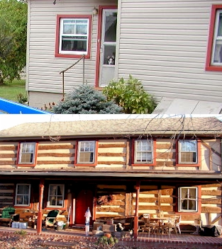

We've had vinyl siding on our house for years, almost the same color as your house Sigarms. No fading, no cracking, no maintenance and if it's installed right (which is not hard, just don't drive the nails home) no warping. We also had rigid foam insulation installed under the siding plus all the window frames done in a different color.
I can't think of any other product that's maintenance free. Unless you want to change the color, you won't be removing vinyl siding for maintenance nor will you have to paint it.
I'd get a couple quotes. I don't know if you'll be able to do vertical vinyl siding. Going horizontal would change the look of the house, IMO.

Attached are two pictures (combined into one) that show the front of our house (lower picture) and one side (upper picture) that shows the vinyl siding.
We had to remove a layer of white, aluminum siding which was covering white wooden clapboards which was covering the logs. We saved the logs on the front and back of the house, but the ends were too far gone to repair. We did the front and back and had someone else install the siding.
