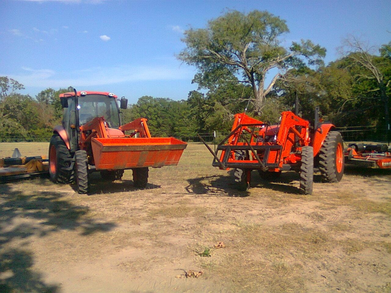

Well I figuerd I would show my tractors that I have so yall get an idea of what im hauling tractor2.JPG
Also truck will be used to haul hay and cattle

Well I figuerd I would show my tractors that I have so yall get an idea of what im haulingView attachment 227033
Your in 1 ton diesel dually territory in my opinion! Maybe 1 ton SRW diesel...
I would even consider buying something bigger than a pickup... something like an F650... You know like a beer tractor trailer. I know there's some nices ones out from Ford, GM and maybe Freight liner. A lot of guys use this size to pull big 5th wheels. Plus you can get CAT engines in some of them! Purrr power!
