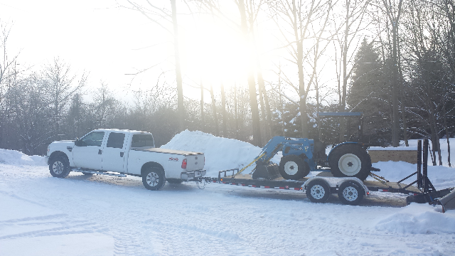

I had an 18+2 that the only way to get my smaller tractor + FEL + 6' cutter on was to back on and put the tailwheel almost on the ball hitch. Couldnt leave it hang off the back cause it had fold up ramps.

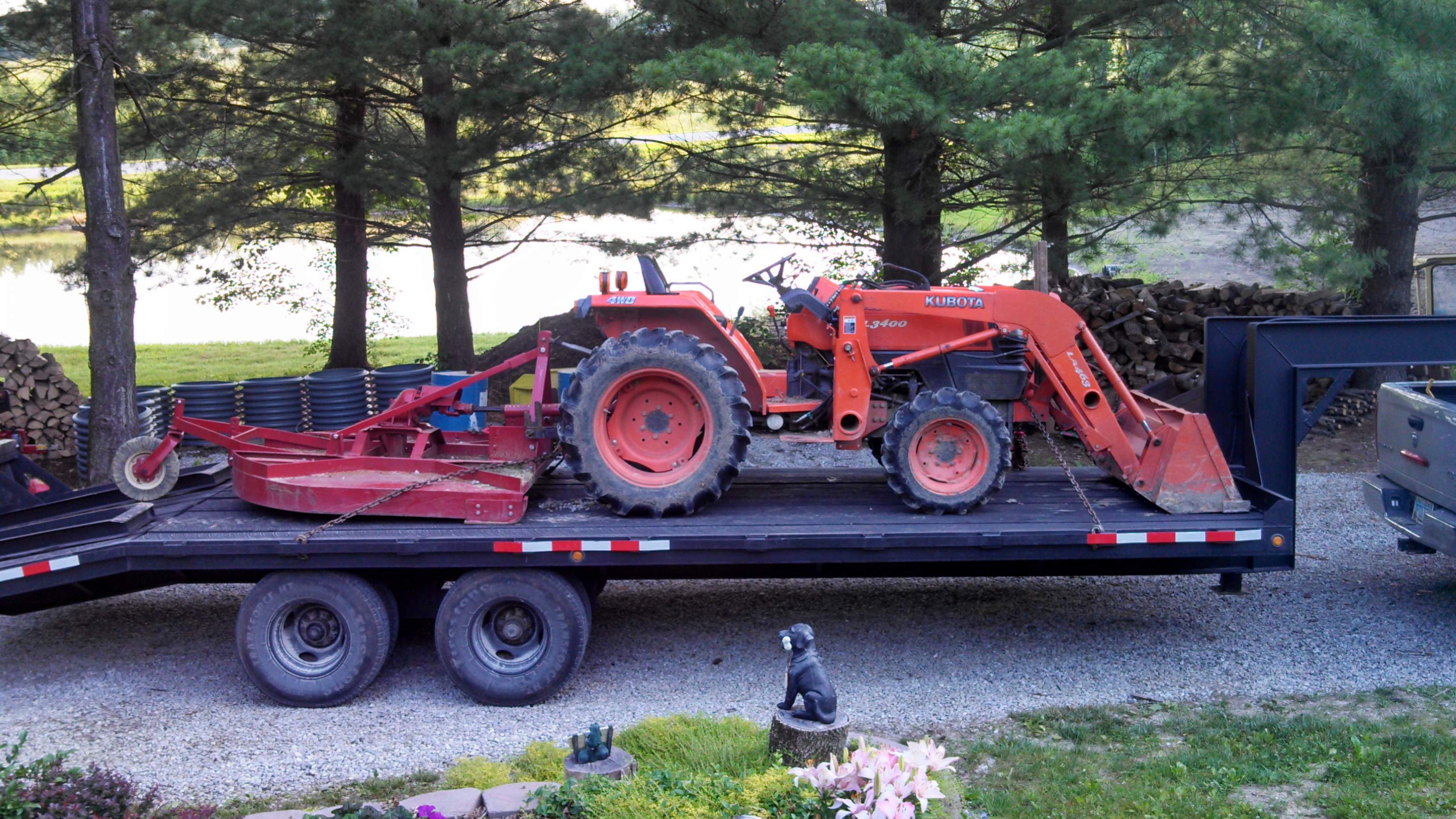

This is what mine looks like on a 20+5 GN trailer. Tailwheel is about 18" to 2' beyond the flat.
And your tractor is listed at 132" length with the 3PH. Mine is listed @ 106" w/o and with adds only maybe 8". So your tractor is a good 18" longer, and thats not counting if the loader sticks out farther.....
I'd say you need at least 20' flat + some dove at a minimum. But I would measure it first. a 6' bushhog is going to add a good 8' counting the tailwheel. And thats from the 3PH arms, not the back tires.
<img src="http://www.tractorbynet.com/forums/attachment.php?attachmentid=362285"/>
You can gain another foot or so by parking the tractor with the bucket fully dumped & curled under.
In your picture, you have the bucket flat ...
   / What trailer for 4047? #7
Its a little less than that the way my bucket is designed. Maybe 6". The cutting edge comes back, but the top lip goes forward. I tried several ways when I was using my 18+2. But with the 20+5 GN, its no longer a concern. so I park it flat so my teeth dont tear up the wood deck in transit.
