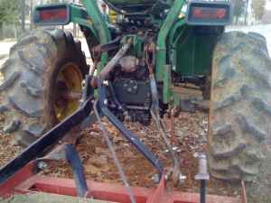

Then today I found a 955 for sale for locally with a little under 2000 hours, a 70A loader but it doesn't have a pto shaft as shown in this picture.
Anyone have a good idea why it would be missing the shaft? I don't know that I really need the pto, but it would seem to make a big difference in what it is worth. They are asking $6k for it. Do you think it is worth that?
Can anyone tell me if it has a rear scv?
The tires look decent to me in the picture, am I correct?
Anything in particular I should be looking at or checking for?
Thanks for all the help, I really appreciate it.

/ What tractor will do eveything I need well? #14
John,
I think I would pass on a tractor without the pto unless I got it dirt cheap.
Second is it really necessary to drag a trailer up and down the hill? I work lots of landscape jobs where the fell accomplishes the task of moving materials, debris and limbs.
/ What tractor will do eveything I need well? #15
If it doesn't have a rear PTO, then it has broken somewhere along the way and it's hard to tell what else might have happened in the tranny too. That price for a 955 is really really cheap. You'd probably be getting what you pay for. Will also be hard to sell without a PTO.
Right size tractor, but I don't that one is right. Look at 955's on tractorhouse.
