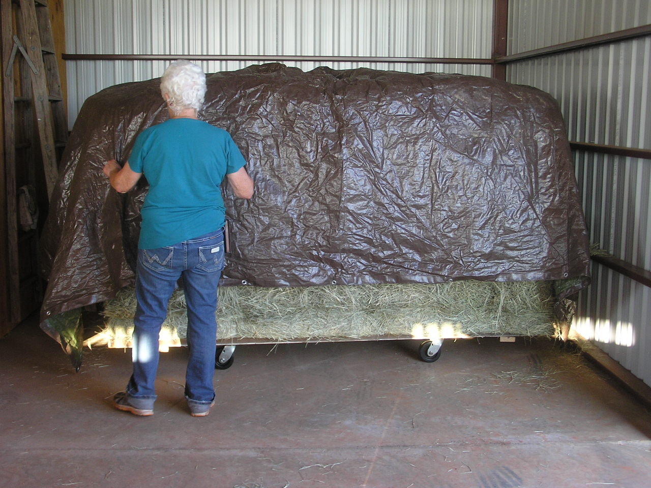

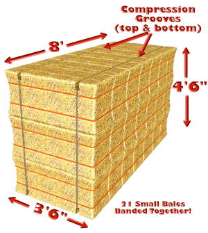

We always keep a few small square bales. Recently getting them in 21 bale bundles:

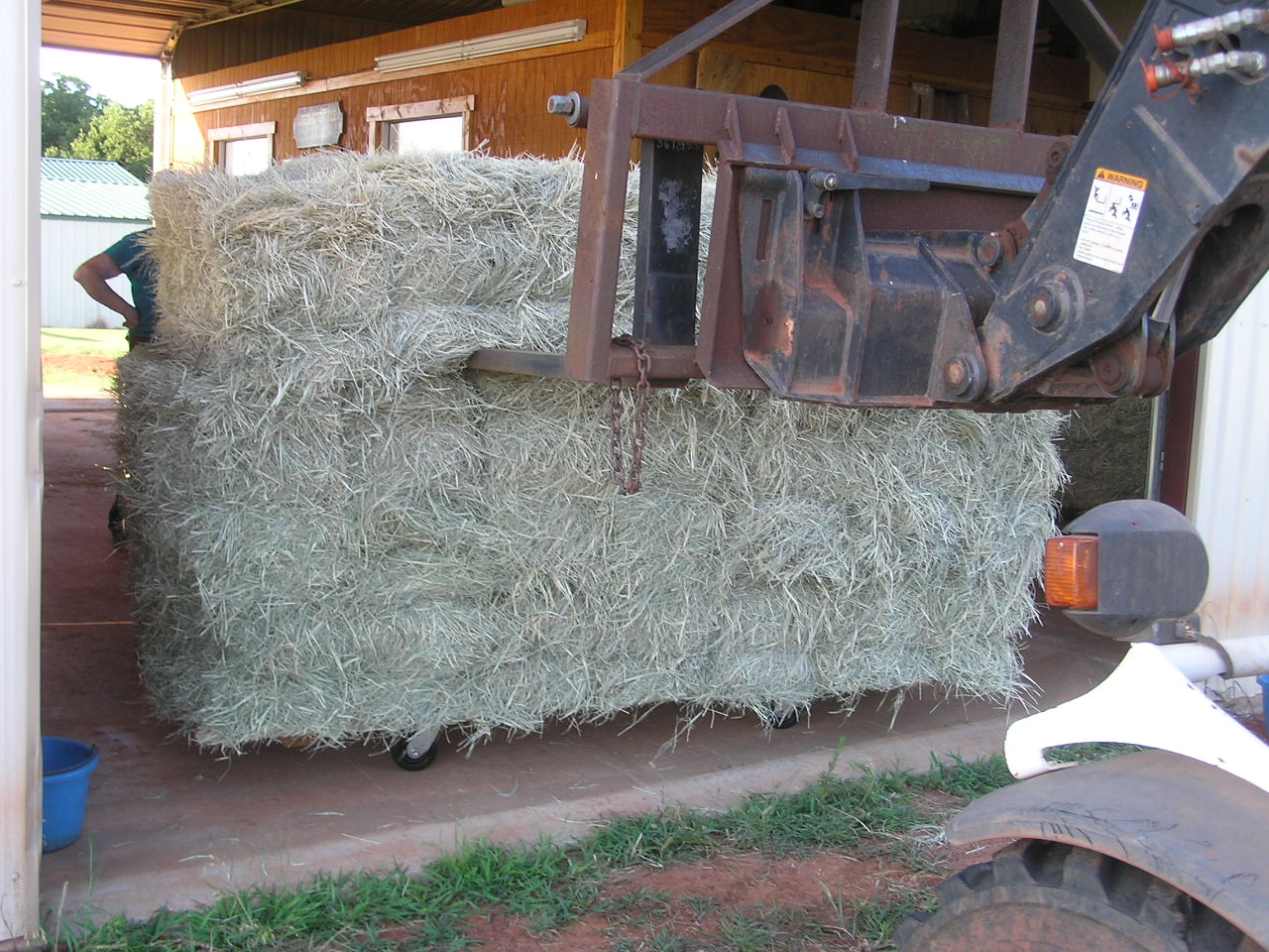

And unloading with the V417:

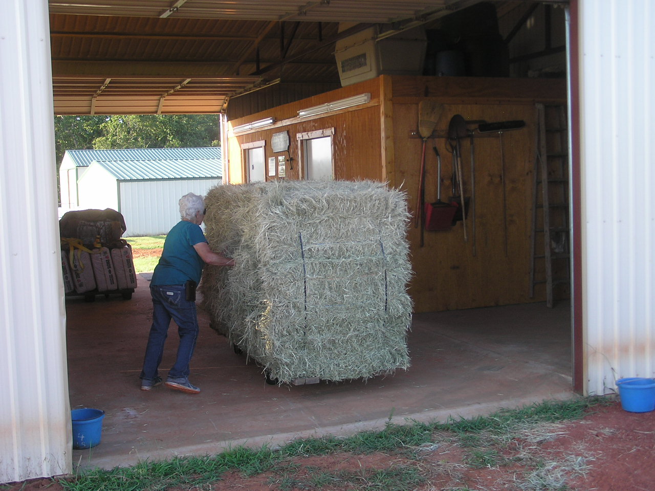

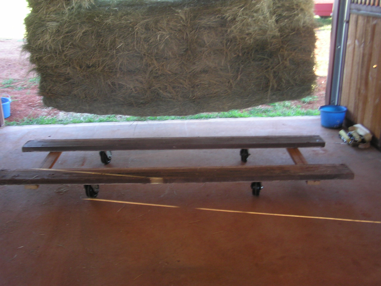

Set it on the dolly:
My wife pushed it from the aisle and put a tarp on it:
