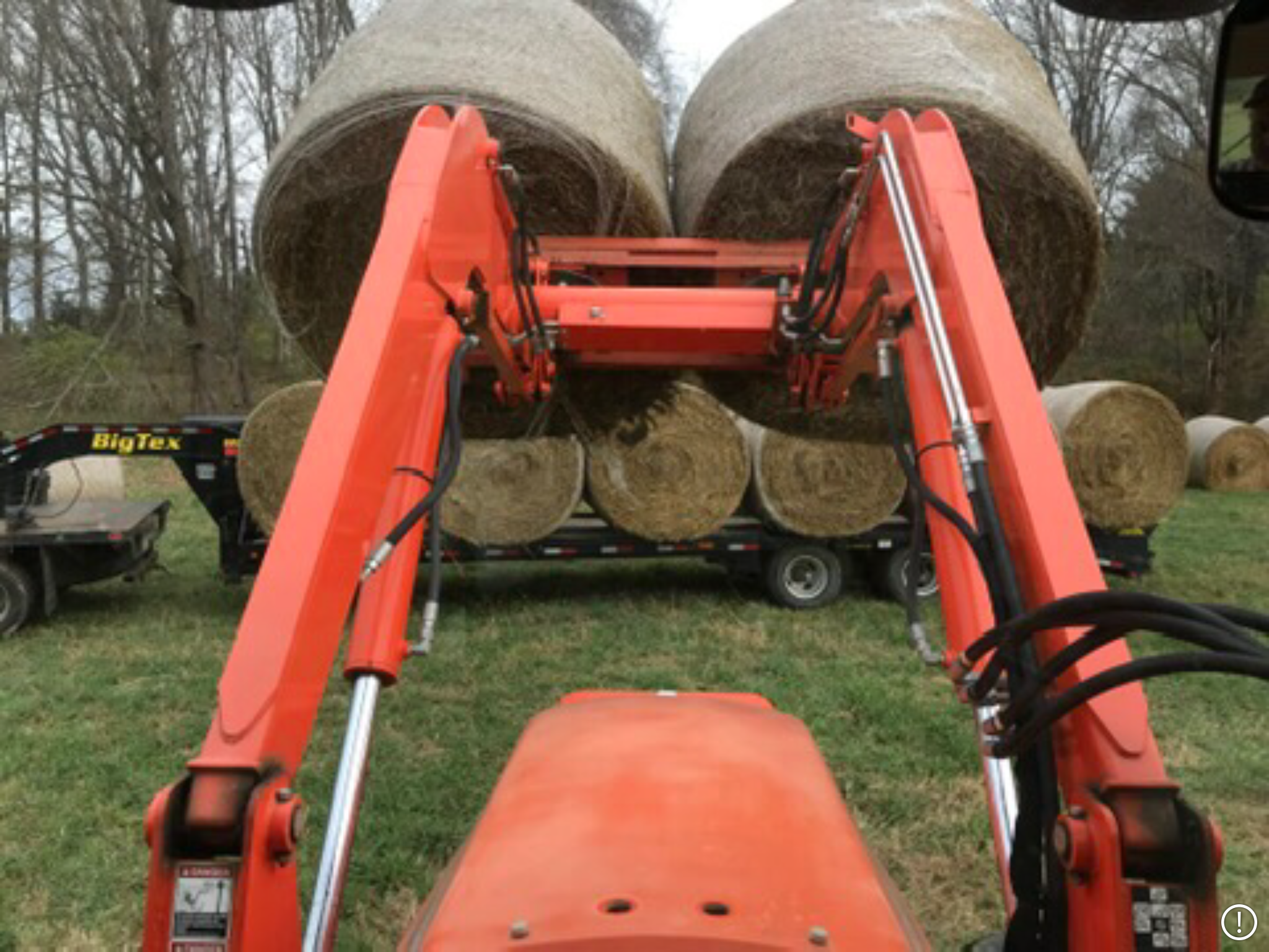

Id want a 10k or heavier tractor if you want to spear 2 bales at a time. I do 2) 850-1000lb bales at a time with a dual bale spear on my M126x and M135x. Both have cast rims. Why unload 1 bale at a time when you can do 2?
One at a time, you can go to maybe a smaller M7040.
All those tractors I have owned for a long period of time. All have 4WD and no emissions. They are very good tractors and can be had with a lot of nice features.
