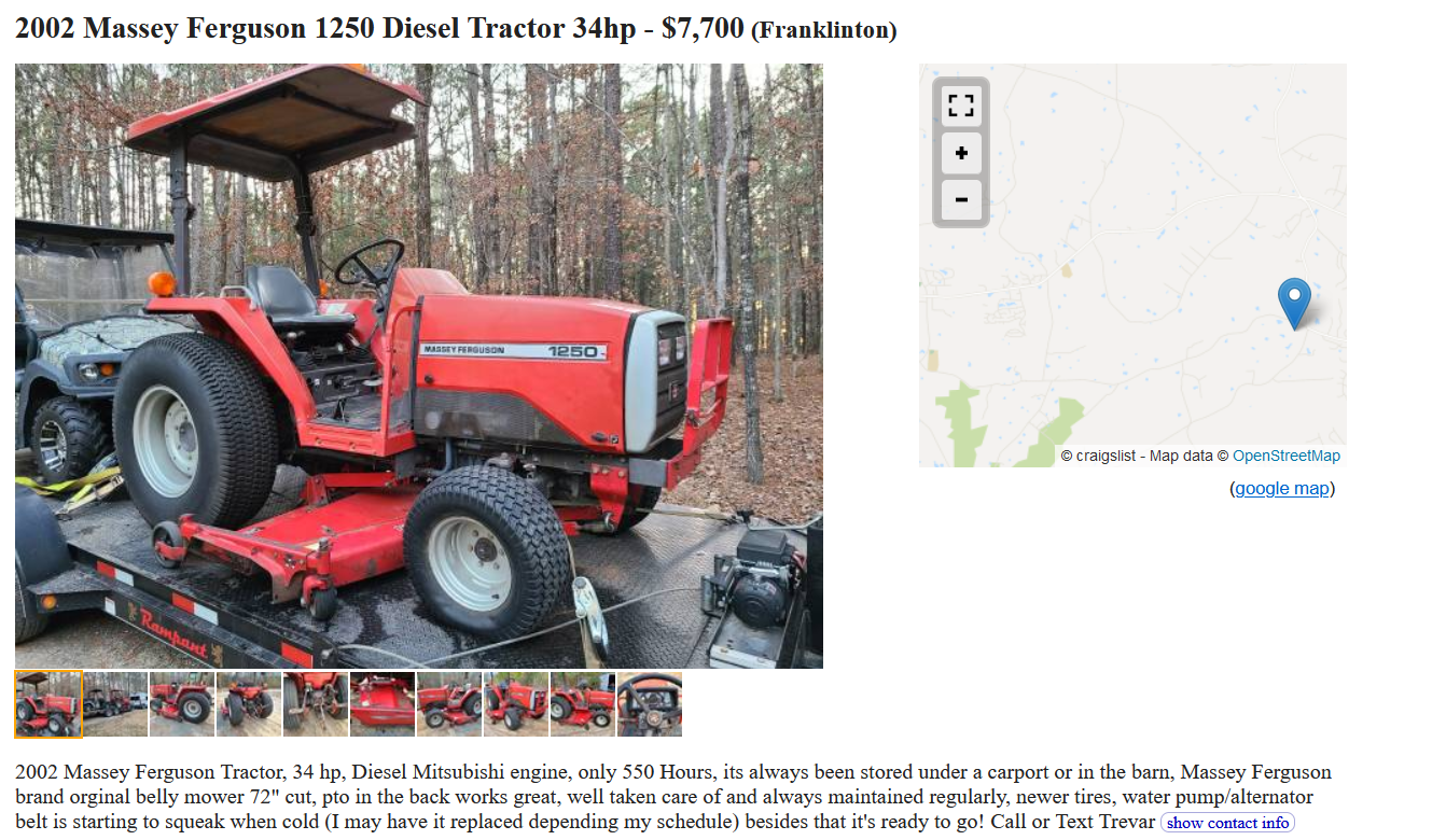

Itll be a challenge to find a 4WD tractor thats not ready retirement for $5000 in THIS economic climate.
   / What tractor or piece of equipment for this hilly pasture? #65
Craigslist
