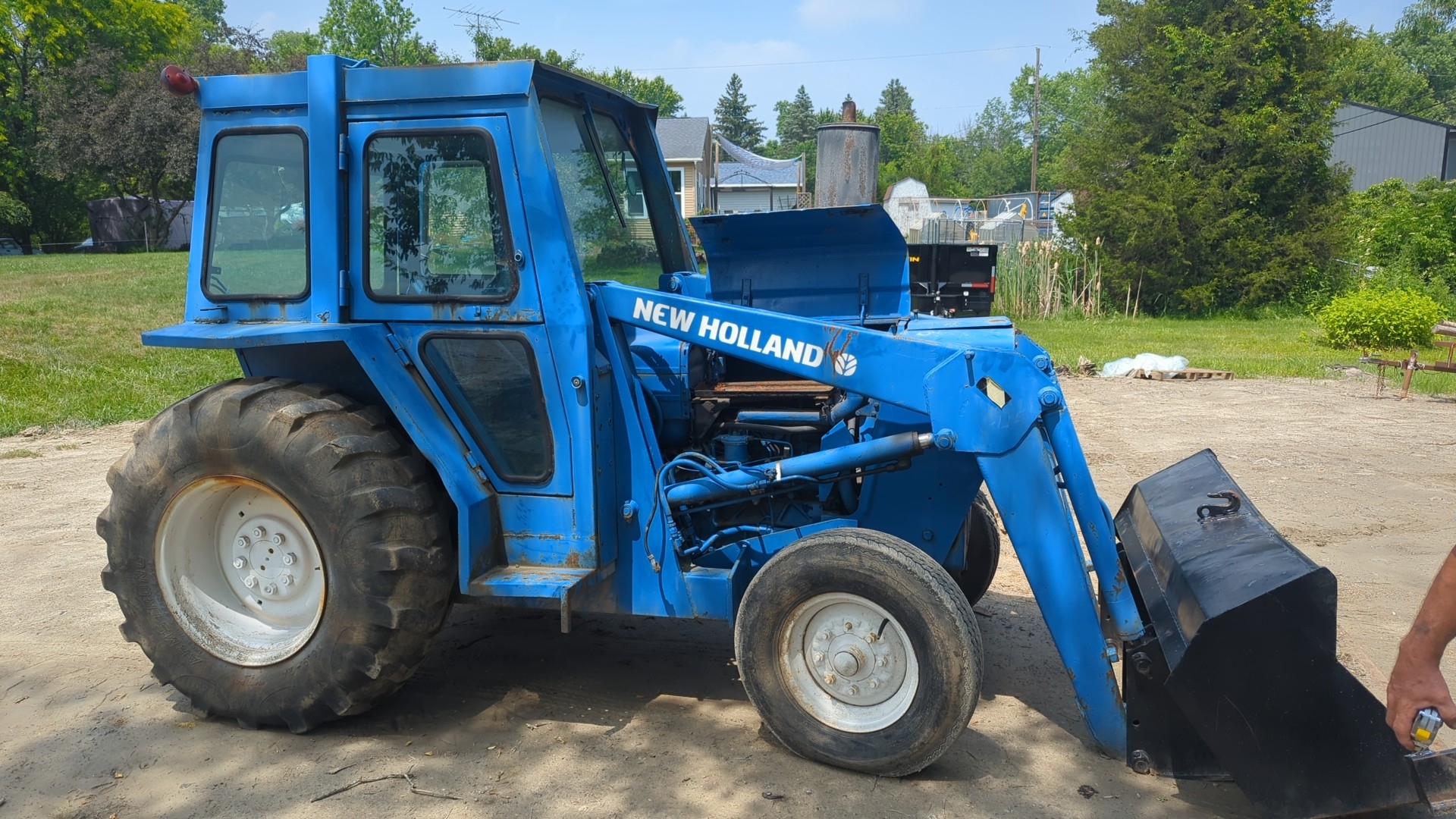

ford 545?

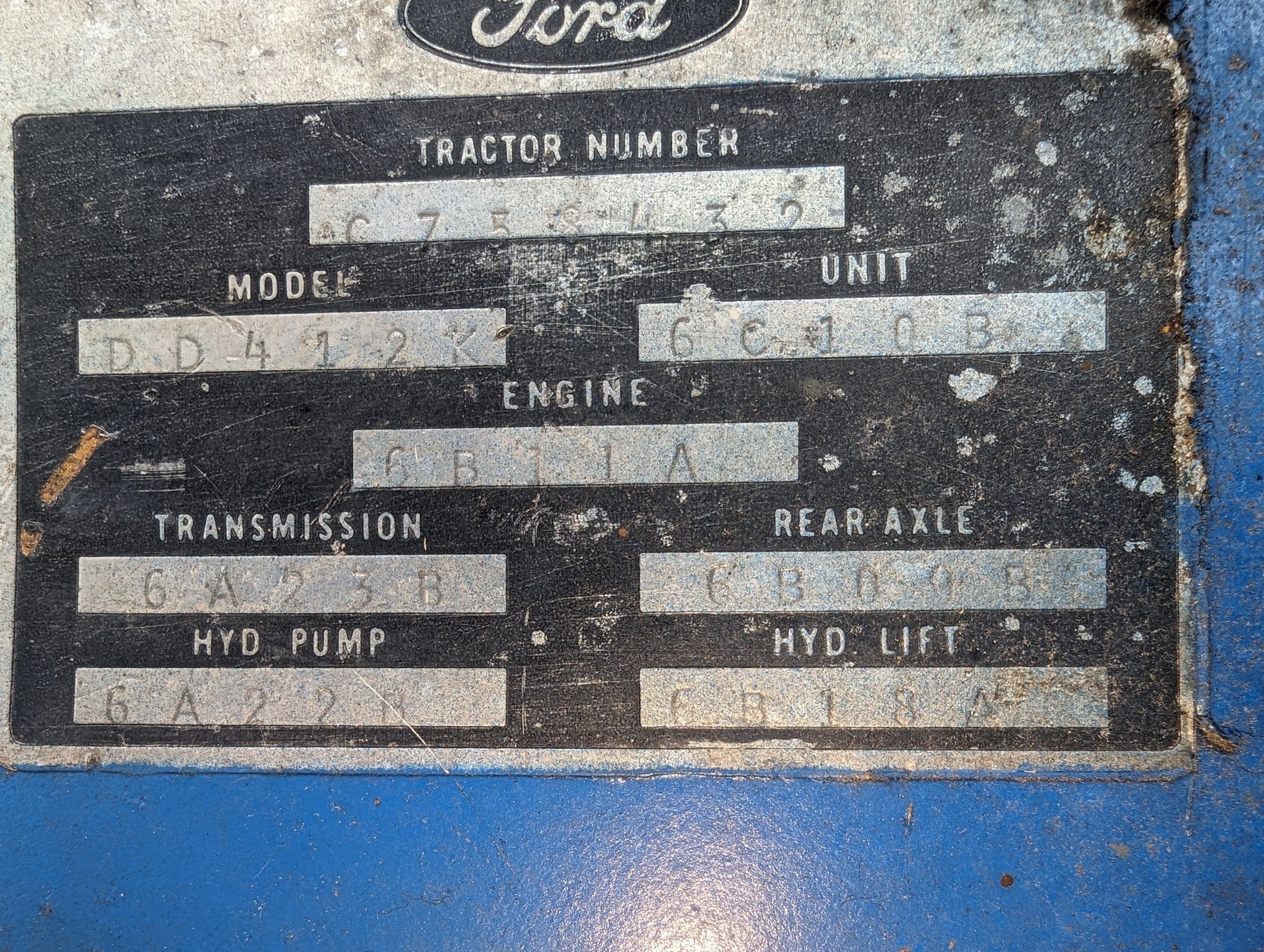

My dad bought this tractor to do some work around the yard, can you help me identify it please? Also please ignore the New Holland Sticker i think the old man threw some paint on it and that sticker

Seriously though, Ford built New Holland tractors for some time. Sorry, not much help.

1975-1976 Model 535 Industrial, diesel, 540 transmission PTO, 6x4 manual reversing transmission. That's what I get from the model number if I am seeing it correctly.

Yep, to early to be a New Holland, Ford.
Still a Very capable FEL tractor if a 535 industrial- considering even "flogged out" it will lift 4500lb to full height
With some weight on the 3 point that tractor should do a lot of work even without 4 x 4.
