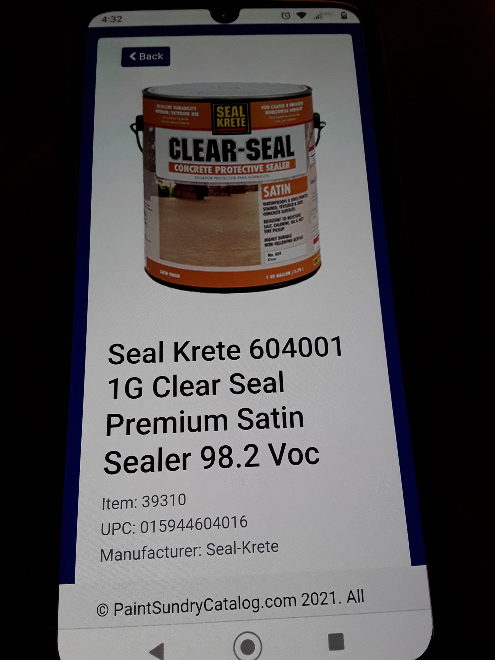

Gonna depend, but it's the best one we sell. Comes in different sheens as well.
