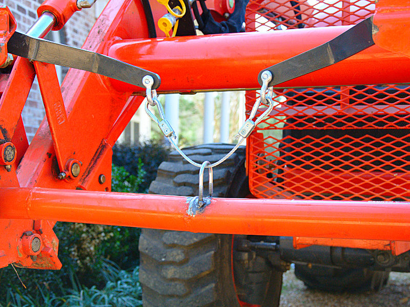

Yes I can do it with my grapple, but wading into that heavy stuff I am slower and very timid, becauser I've broke stuff already (HYD line) and the SSQA lever was popped and the grapple fell off with a tree in it, and other stuff.
This comment caught my eye. I've had a very similar thing happen to me, and when my grapple detached, it bent the SSQA frame. (I was able to repair it by cutting and welding.)
My solution to debris kicking up a lever was to add an expanded metal shield to the back of my grapple (to cut down on stuff getting near the levers), and to add a "lever lock" to my SSQA frame (to prevent either lever from moving to the unlocked position). Basically an inverted U-bolt, a couple of shackles with screw-in pins, and some wire rope. Anytime I use my grapple, the lever lock is in the configuration shown. Takes 30 seconds to fasten or unfasten.
I haven't had a lever kicked up since.
